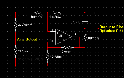

I've been thinking about this since you replied to my http://www.diyaudio.com/forums/solid-state/277005-oliver-offset-optimiser.html circuit idea etc earlier. How about this instead with that ?
I think the output of that one will be a lowpassed sum of the drop across both resistors (the opamp would need to operate at or above the output's supply voltage). But, when the amp is delivering output current, the sum voltage will rise, even if bias is correct, the result being a filtered full-wave rectified version of the output current. Fine for class A, not fine for class AB.
