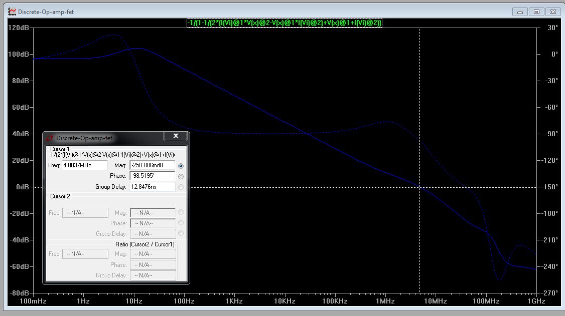

Once and forever, since this is coming again, and again, and then again... Given a phase margin, an ULGF, and a compensation method order, a CFA circuit topology does NOT provide more loop gain than what you could get with a standard VFA. To understand this, before going to the Lurie stability or the Bode integrals, there is an almost trivial justification: whatever Mr. Zan is going to mumble and moan, audio circuit topologies are still of the minimum phase breed. As such the gain and phase are NOT independent, therefore pushing up the loop gain, pushes down the phase margin, no exceptions (or free lunch, if you prefer). Changing the compensation order is the only way to break this rule, by adding N poles and N-1 zeroes in the unity circle (N=1 Miller compensation, N=2 TPC or TMC, N=3 Cherry NDFL compensation). I've heard of amplifiers (both linear and class D) compensated up to the 5th order, but I have never seen a schematic. The CFA circuit topology has other interesting properties, none of which really matters for audio.
Your example with 80dB loop gain @ 20KHz is either a typo, or you are talking a different and strange Bode language. Even if a two pole type compensation is involved, such an amplifier would have a ULGF higher (I would estimate some 8-10 MHz) that what could be of any practical importance for a power amplifiers (with the power stage limiting the bandwidth).

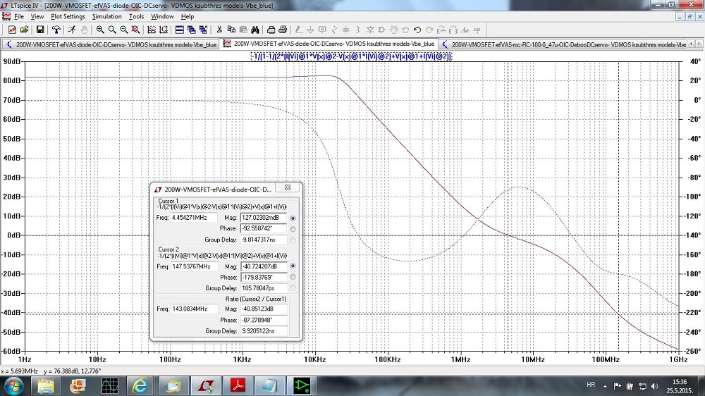

This is LG of my 200W CFA mosfet and it is nothing like VFA. I never succeeded to have more than 60, 65 dB of the loop gain at 20 kHz with the VFA.

Phasemargin does not look to healthy, less than 10 degrees at 200 Khz.

What are you talking about. Phase margin for this amp is very healthy with 87 degree and Gain margin is exceptional, 40 dB. That drop at 200 kHz is standard behavior of two pole compensation, nothing to worry about.
Your compensation is not optimal as I can read from the Bode plot.
Probably because you never tried (or never succeeded to implement) a double pole and a zero close to the ULGF (like you did in the simulation of your CFA). That is a pretty trivial exercise, however it would be as much dangerous as in yours, from a stability perspective.
Double poles have high sensitivity (that is, the ULGF will move significantly with component tolerances, bias conditions, signal level, etc...). I have never seen double poles in anything but simple filters (like the Sallen-Key topology) and switching mode power supplies.
It would be interesting to simulate the same amp when the output approaches the rails, something you always avoided to show, by keeping a comfortable margin of 10-15V-20V. That's when the beast shows it's ugly head. It would also be interesting to see the clipping behaviour (when the loop gain collapses without much control, and the conditional stability may hit you).
I know you proudly built this amplifier and are trying to promote it by all means. Even if you hit the jackpot once, this doesn't mean this amp will survive the abuse that an audio amplifier should be prepared to face in day to day operation. I can show you a 100W mosfet power amplifier with an ULGF of 40MHz, that appears to be very stable in simulation. Which doesn't mean I am ever going to even try building it, not to mention trusting it enough to feed a pair of (borrowed, since I don't have any) expensive speakers.
