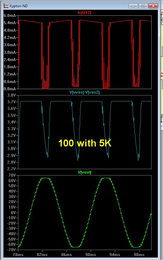

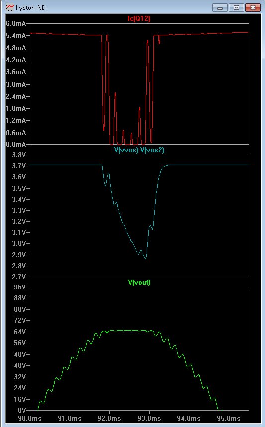

There you go , Jan. (below).
Your "audible" question is hard to comment on.
Before clipping you only have that minimal ripple that you see in the blue trace.
During clipping , if you go fully into class B ... that actually makes
the output stage's work easier. BTW , this "effect" is very minor
with my spreader and EF3 , I had builders grossly overload these
circuits to arrive at the final design.
All this with the VAS's impedance and spreader values works very
well with an EF3. The "mechanism" is far worse with a EF2 (or
with a "blameless" VAS).
Curious that anybody is even interested ? Some EE's say ... " just
don't let it clip". 🙄

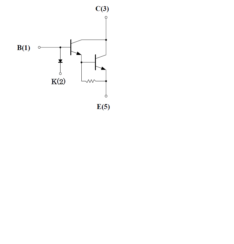

I thought that the Sankens were a problem because there was not enough output transistor base pull-down current to suck out minority carriers fast enough at high frequencies, and that there was no opportunity to increase it by external means. Am I wrong? What is the nominal amount of base turn-off current built into these devices?
Bob
Bob, I really don't know the resistor value of the B-E resistor in the final device. You are correct that it's not accessible. I never noticed an issue with that - then again my amp doesn't get the low THD numbers of your MOSFET amp.
One practical advantage is that with a medium-power driver and the Sankens you can build a compact 3EF output stage for say up to 100W/8ohms equivalent. The pin layout of the N and P are mirror images.
They even used to have a version with Re (0.22) build-in, but that was discontinue after field failures turned up with Re open and the transistor intact...

OS, thanks for that, but what I meant was you have say 50 or 100Hz signal, clipping and all the bad things on the spreader voltage. BUT at the same time there is a low level say 100mV 1kHz signal also, riding on the 100Hz. I was curious how the 1kHz would look in this situation - just 'clipped' or something else?
Jan

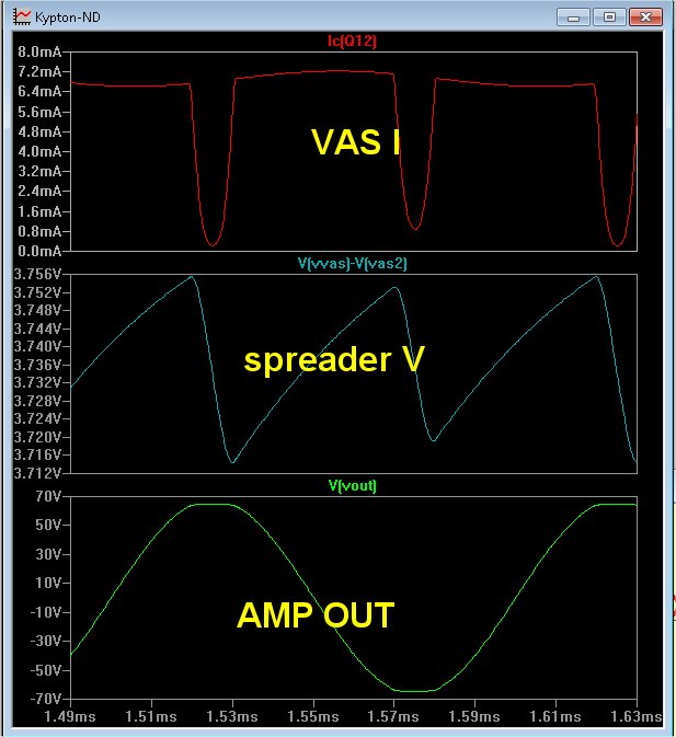

Oh , that's all (below 1-2).
The higher freq. waveform will clip until full saturation right at the ""cutoff
point". My vas actually cuts off (clamps) within the baxandall at this point.
It also goes high Z .... reacts differently than a current sourced VAS
in regards to the spreader voltage.
This "generation" amp (below 3) has been described as "tube-like" when
builders/testers have actually clipped it.
OS

Dependent on frequency and the Z of the VAS when it clips.
(below) shows this effect.
At 5 hz , we do go into a "collapse" ... but we are clipping ,
who cares. Nothing to worry about - amp and speakers typically survive.
I realized this years ago , combined it with real world solutions.
The shunt R at the VAS and the spreader bypass cap determines what freq.
the "collapse" happens at.

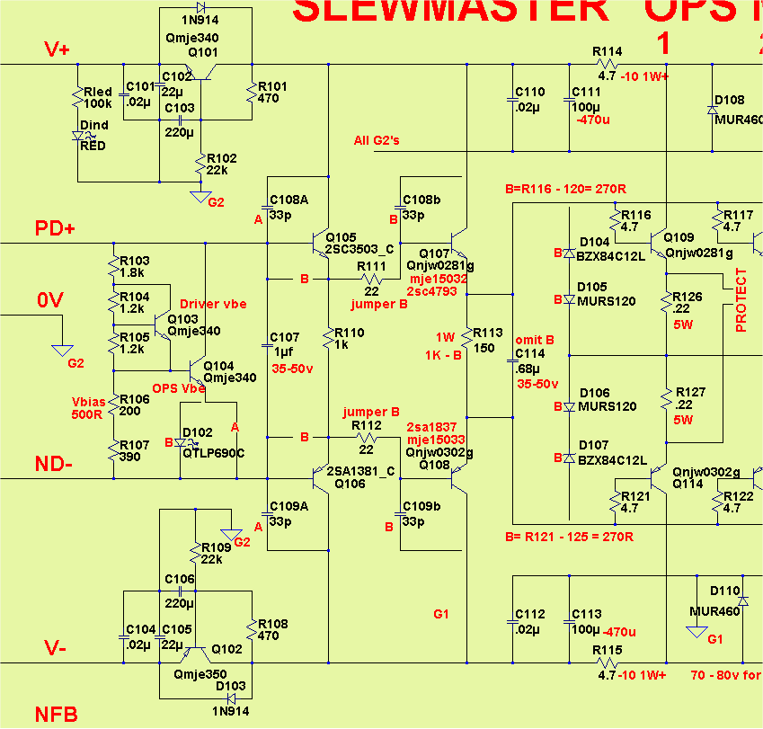

Thanks , Bob.
The "collapse" simulations are with a 1uf bypass.
"testpig" (below pix) shows the standard spreader.
"A" is the Locanthi configuration.
"B" options are for an EF2 IRFP OPS.
