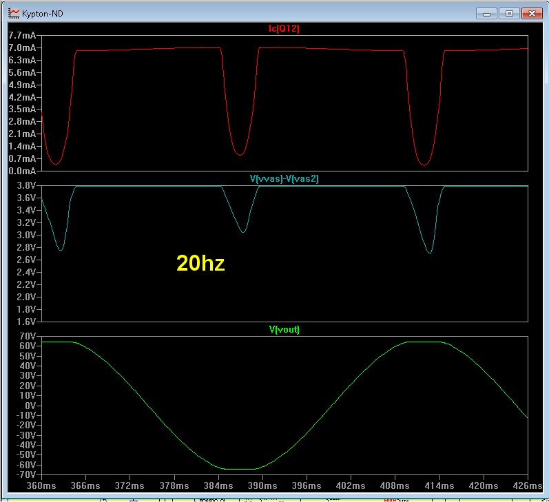

It does occur to me that sensing being too fast might be a concern if the bypass capacitor in the Vbe multiplier creates a time constant that is near that of the sensor, thus possibly giving one two (or more) too-closely-spaced poles in what is ultimately a feedback loop. I have not given this a lot of thought or plugged in numbers.
The reason that I bring up this concern is that I worry about bias spreader "collapse" when an amplifier clips. This can happen when the VAS current goes to zero.
With normal-size bias spreader bypass capacitors (say, 10uF or 47uF) that capacitor may discharge by the Vbe multiplier resistive divider current, such that the amplifier may be briefly under-biased when exiting the clipping interval. One could consider mitigating the under-bias condition by using a rather large (say, 1000uF) bias spreader bypass capacitor. This would, of course, tend to introduce a longer time constant into the bias spreader. Might a bias instability be created? I don't know.

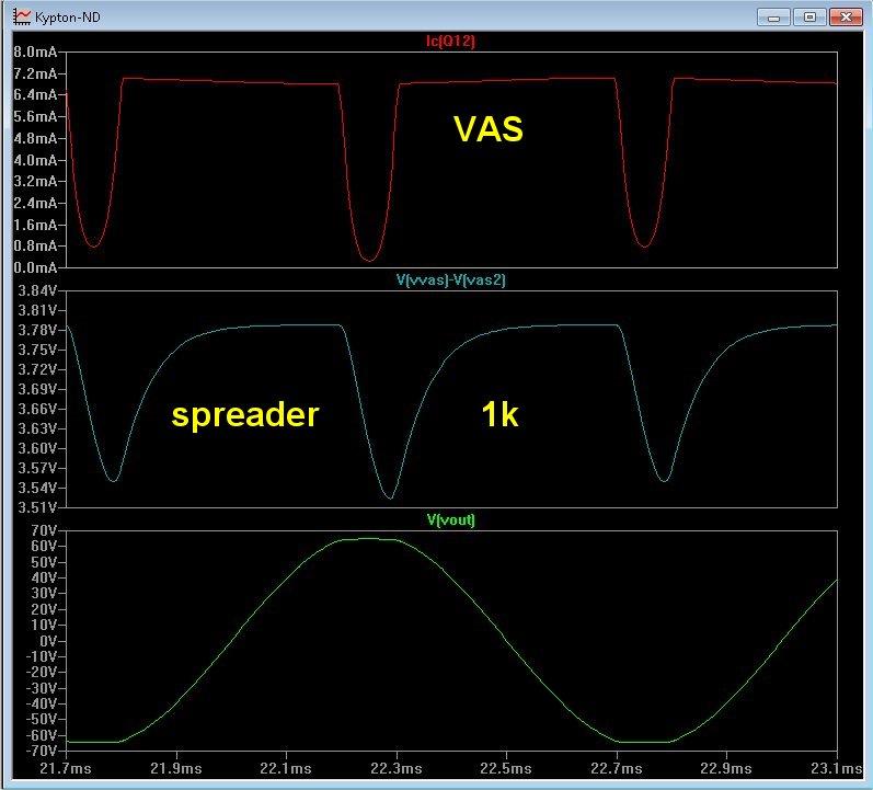

Dependent on frequency and the Z of the VAS when it clips.
(below) shows this effect.
At 5 hz , we do go into a "collapse" ... but we are clipping ,
who cares. Nothing to worry about - amp and speakers typically survive.
I realized this years ago , combined it with real world solutions.
The shunt R at the VAS and the spreader bypass cap determines what freq.
the "collapse" happens at.
Last post in this thread .... between the bickering and being ignored
despite very good contributions - I give up.
OS
I wonder whether this mechanism accounts for some audible differences between amps? I mean, beyond the obvious generation of harmonics when clipping?
It would be interesting to see these waveform with a low level higher freq signal say 1kHz superimposed?
