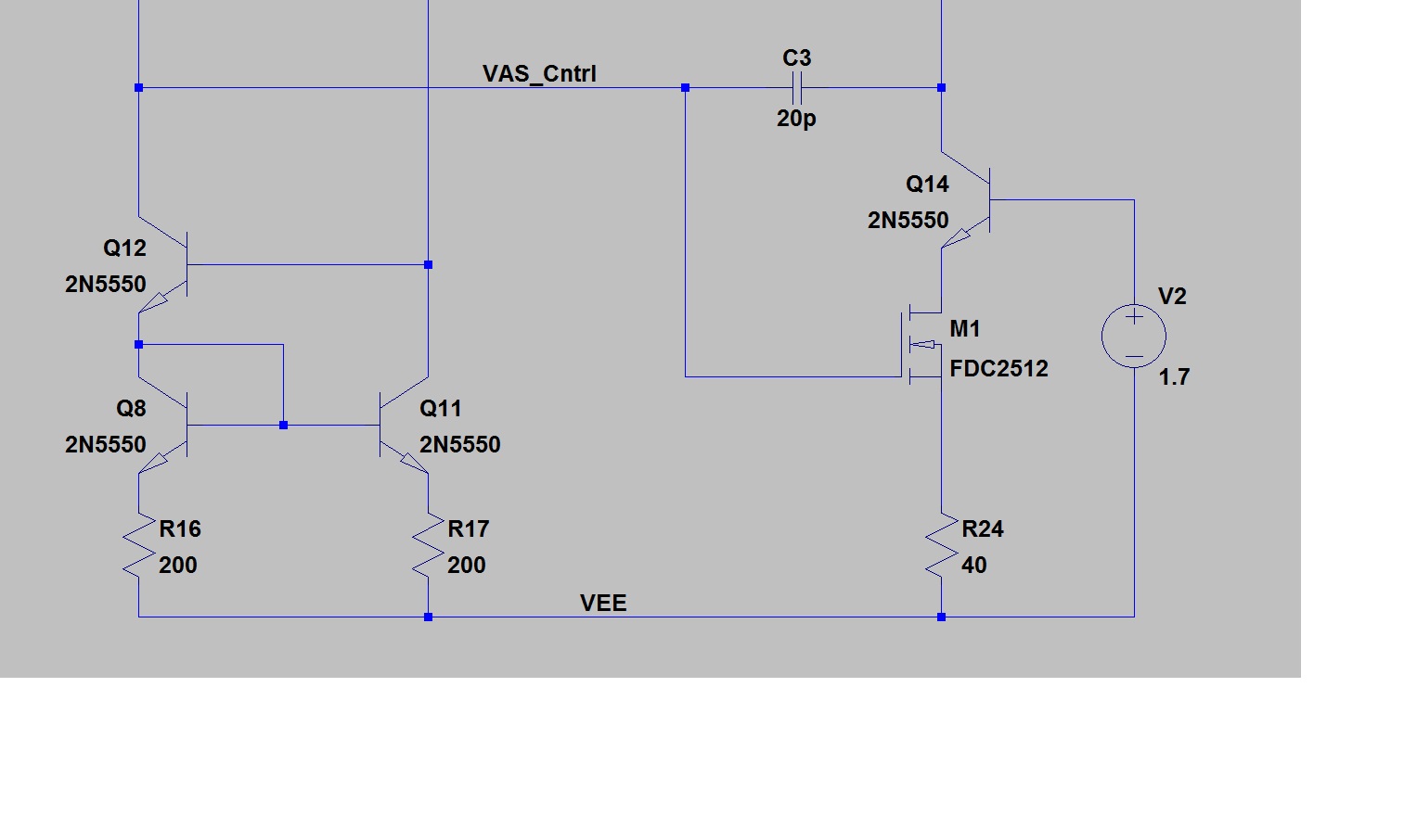

Thanks for that term, Richard, it perfectly encapsulates the same process that needs to be followed with general system tweaking - once the sound is working at a satisfactory subjective level then you remove each weird and wonderful 'mod', one at a time, in order of the most 'extreme' one first, and see what happens ...
It removes input stage DC offset; since the gate voltage is higher than the "normal" two (or three) transistor VAS; this allows larger mirror Rs for lower noise and a Wilson mirror for accuracy; less tranies in the signal path; high output Z; and the Source R manages total available I_Out. And... nothing is free.
The idea here was to use the MOSFET in its linear/triode region as a voltage variable resistor. Hence the common base.

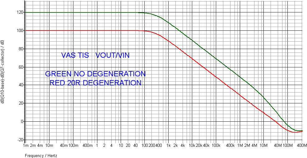

You got a good case where the TIS vs. VAS makes a difference. If you look at it as a TIS, then the transimpedance gain is exactly Beta*Rload. Moreover, if the output buffer input impedance is very large, then the gain is limited by the transistor output impedance VA/Ic (VA stands for the Early voltage). Therefore, the TIS gain is Beta*VA/Ic, independent of any emitter degeneration.
That would make sense but if VaF/Ic = Ro (output resistance)
then isnt the gain ultimately limited by Ro/(Re + 1/gm).?.
I would be most interested if you can demonstrate this.
Using your schematic as exemple , the VAS/TIS gain with
and without degeneration.
Wahab,
do I see a steepening of the green trace from above 8Mhz?
Is this a second order effect coming in @ HF.
It seems to be suppressed until 30MHz on the red trace.
Could this complicate the steepness of the gain curve for the whole amplifier where <9dB/oct is specified for stability?

Yes , you are right in your observations.
Degeneration of the VAS not only reduce its gain
but also reduce its bandwith such that the influence
of high frequency poles is reduced accordingly but ,
as pointed by michael K , excess phase is increased
and global stability worsen somewhat , although at the
pole frequency it is improved because the inherent peak
is quite less , well , peaky.
Degeneration linearization effect falls exactly under c) (as a current-current feedback loop). If we can't agree on this elementary fact, it's indeed a waste of time to debate anything else. And please don't come up with the local vs. global NFB nonsense. Negative feedback is negative feedback, period.
This is not right.
If you add degeneration to the second stage you ll increase
the first stage output level wich will increase its distorsion ,
yet the VAS better linearity wont allow to compensate
for the first stage said harsher conditions , hence ,
feedback distribution matters as its application is not
freely transferable from a stage to the other while
keeping the same global efficency.
