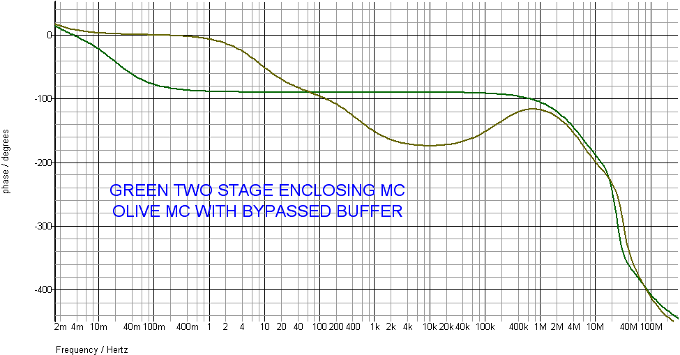

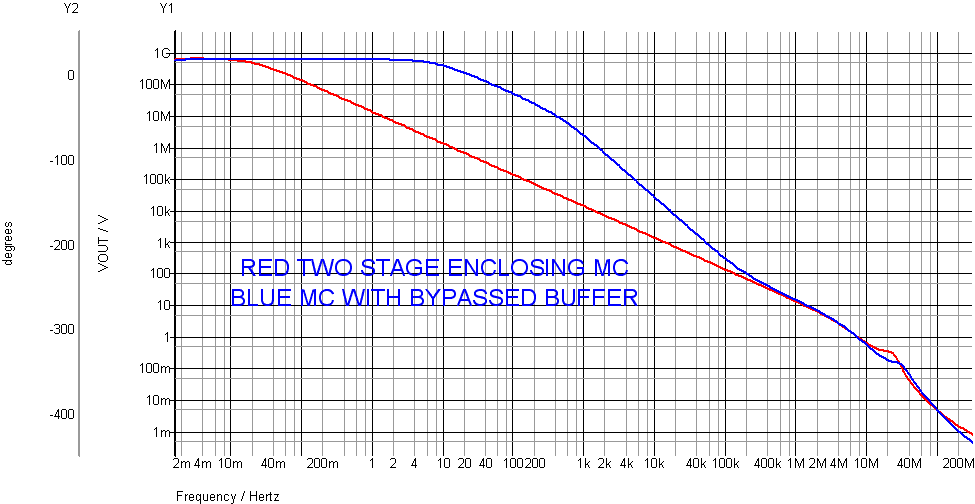

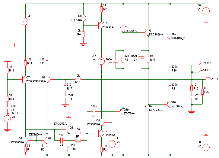

Two pages earlier i posted MichaelKawinuka s typical schematic but
with a compensation that bypass the VAS/TIS buffer at high frequencies.
It looks like the result is a quite different OL gain and phase response compared
to the usual miller compensation enclosing both the VAS/TIS and its buffer ,
actualy the curves are typical of a TPC but without the peak in frequency response
and thus with a phase shift that do not abruptly increase when transitionning to close to -180.

What about the proposal a few posts back to use an EF buffer on the VIS and return the Miller capacitor after the buffer rather than before?

One reason for the improvement brought by an emitter follower VAS/VIS/TIS stage enhancer (eg Blameless) is the the main device is now fed from a much lower Z than the output of the IPS/CM. Distortion due to it's evil modulated Cob is 'ignored'. But it means any HiZ feedback to that point (eg by plain Miller, TPC, TMC, 'pure Cherry' etc) is also 'ignored'.
You see this very clearly in the JE990 variants where the usual clamping diode reintroduces this evil which is the dominant THD mechanism in most applications.

If R > 1/gm2 the positive zero becomes a negative zero and can be used to cancel a pole as it is done...
Dave Zan said:
So, Mr Lee. The VIS emitter resistor bypass capacitor should be used with a Miller capacitor series resistor to force the zero into the LHP.
You need both to have sufficient free parameters.
Du.uuh! I never considered doing both on Toni's amp. Need to see if I can persuade Toni to do more 'real life' tests.
There's a lot of sim work which I won't really have time to do properly before I ask but ...
.. unlike da sematic pedantic pseuds, I'm partial to 'real life' corroboration rather than [deleted : zillion pages of references that show I'm right and yus are all fools and your TLAs are wonky too] 😱
Thanks to Guru JPV for suggesting a good line to investigate and Guru Zan for enlightening comments. 🙂
Hmmm! My .ASC of Toni's amp still doesn't show all the 'real life' effects he measures .. just hints 😡
