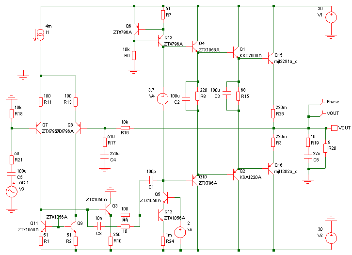

It is not desirable stability wise to have the local loop
encompassing three devices , stability will be also buffer
dependent.
Rather , why not keeping the cdom at its usual place ,
compensating the cascode and then by pass the buffer
at high frequencies such that we then have a classical
configuration with no buffer acting , the input stage current
being hefty it will supercede the buffer wich will be somewhat
relegated to provide the DC biaising current.
Yes. See below.
Minor loop gain phase shift (Green trace) at unity gain without series resistor=153 degrees
Minor loop gain phase shift (Blue trace) at unity gain with 100R series resistor=225 degrees

I would see no point in using schematics that have
inherent flaws so i only took your simulation exemple
at face value , literaly , are we expected to know all the
whereabouts of your private sims and schematics.?.
That said , whatever you pretend to have knowledge of ,
the point is to provide a better TIS:VAS stability , and in this
respect my point is not to ask you if you know whatever
god knows what but to propose a technical solution ,
if you are interested in commenting such tech datas , good ,
we can have a real debate , otherwise keep on your monologue ,
i guess that there s people who are far less patient than i am ,
that s why i keep posting in relation to you while others
simply , and wisely , decided to not interfere with erroneous
behaviour characters....

This idea was mooted by Samuel Groner in his commentary to D. Self:
http://www.sg-acoustics.ch/analogue_audio/power_amplifiers/pdf/audio_power_amp_design_comments.pdf

The only one approaching randomly is fig 50 but the local loop ecompass
even the input stage , there s no efficient feedfoward path actualy.
