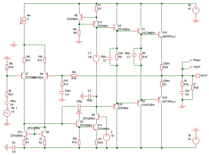

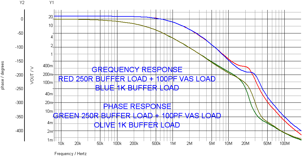

Alternatively, the TIS's positive zero can be made to migrate to the LHP by using an appropriately sized resistor in series with the Miller compensation capacitor. Note that if the resistor is too large, then it may increase the unity loop gain frequency, which, taken together with non-dominant sigularities, may again compromise stability margins.
In the case of your schematic you can remove the 100pF
loading the VAS/TIS (or is it VATIS ?) and simply increase
its buffer output Z by increasing its emitter resistance
from 250r to 1k.
Zero error is zero effective input signal gives zero output. We colloqially (sp?) say that we want to drive the error to zero, but that implicitly assumes infinite gain. Once you figure in the gain, it should be: drive the error to Vout/OLG.
Edit: we may have a semantic issue here: I use 'error' as the effective input signal of the amp, i.e Vin-Vfeedback.
jan
This may be true for an inverting amplifier. 100% FB with infinite gain would wipe the signal out completely. But I can't see this with the non inverting mode. Simulate with an ideal op amp and see what happens. With no attenuation at the non inverting input the lowest the gain can go is unity no matter how much feedback.
The value of the buffer's emitter resistor was selected so as to makes the buffer's current draw roughly equal to the current drawn by the current mirror so as to minimise current imbalance in the LTP.
Making relatively small (was it 250R?) has no effect on the characteristics of the TIS.
Frequency response with 250r and 1k buffer output load.
100pF VAS/TIS loading is absent when simulating with 1k.

I wanted to study effect of VAS emitter resistor with minimum assumptions about the rest of the circuit.
Then we can discuss the implications, if any, on the VAS/TIS.
