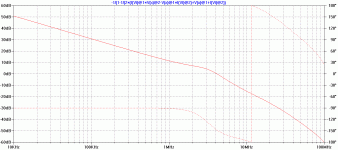

Good zeros

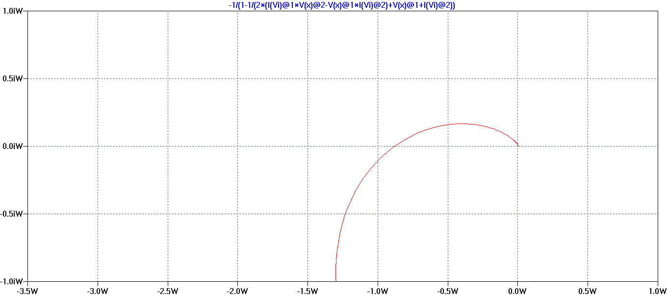

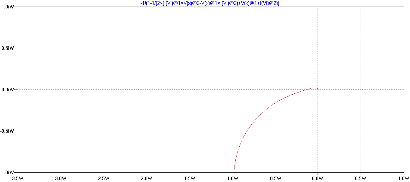

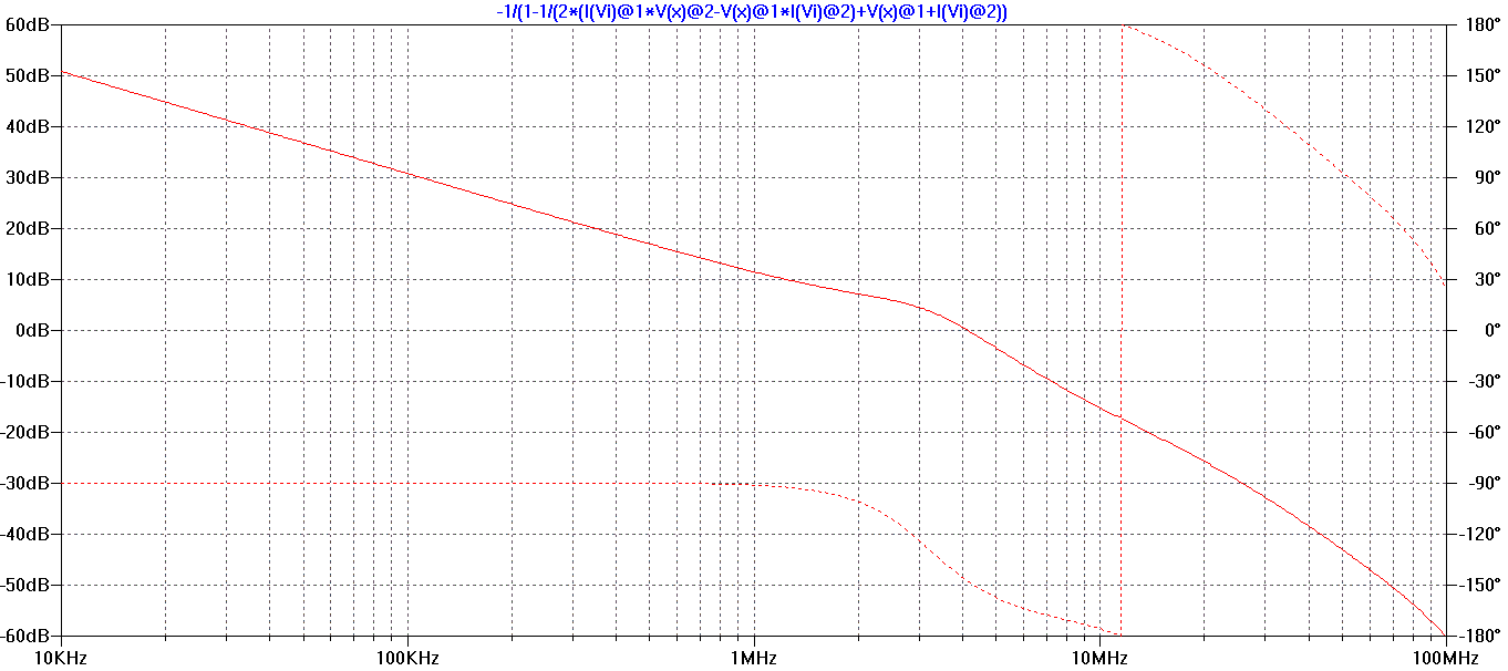

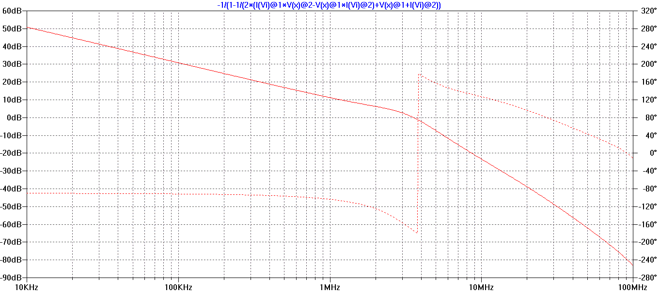

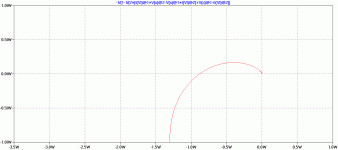

NoC7.gif & NoC7Nyq.gif shows PM & GM are small and Nyquist gets very close to (-1,0) ie dodgy stability. What we need is some +ve phase at the ULGF without adding any amplitude gain.

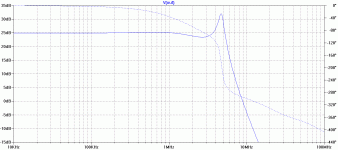

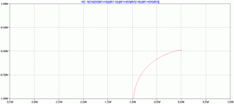

Making C7 3p9 adds a 'good' zero (minimum phase HF lift) at 4MHz and makes the slope beyond it less steep. 3p9 has about the same reactance as R8, the 10k feedback resistor so starts shorting it out above that frequency and increasing Loop Gain
C7-3p9.gif and C7-3p9Nyq.gif shows much improved PM, GM and the Nyquist curves is further away from (-1,0) ie C7 has improved stability.
This example is just to illustrate the technique. It isn't a fully worked out design though it looks stable with 8R loads. If you try various pure capacitive loads, you'll see peaking. 3n3.gif shows Closed Loop with 3n3 pure capacitance.
This is called 'lead compensation' or 'pole cancellation' by some pedants. I'll leave it to Michael to deal with the semantic issues. 🙂
It's been used in some successful amps, eg the Hitachi MOSFET design circa 1975 (?) IEEE Trans (?) to provide the main compensation ... but IMHO, it is best used in addition to some other scheme providing the main compensation.
Used on its own, its too dependent on device parameters. It doesn't control the Loop Gain directly (like plain Miller, TPC, TMC, 'pure Cherry', MIC etc) ... but introduces a nice tweak to what's already there.
Another useful zero is obtained by decoupling the VAS emitter resistor that Michael despises. Guru Zan points out that the effect of this is more subtle ... but its certainly worth trying if you have a VAS emitter resistor for other reasons ... or even if you haven't 😀
An advantage of these 'good' zeros is that they don't decrease Loop Gain or increase loading so have a less evil effect on THD.

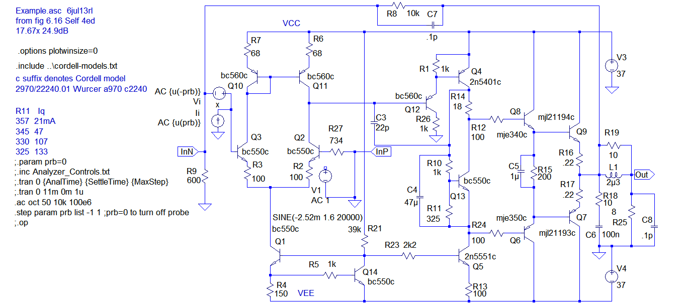

Here's one of Doug Self's models slightly Kiwanuka'd so it shows dodgy stability. Example.asc & Example.gifPlease could you elaborate on this point a little. It would really help my understanding of other concepts if I can get this one.
