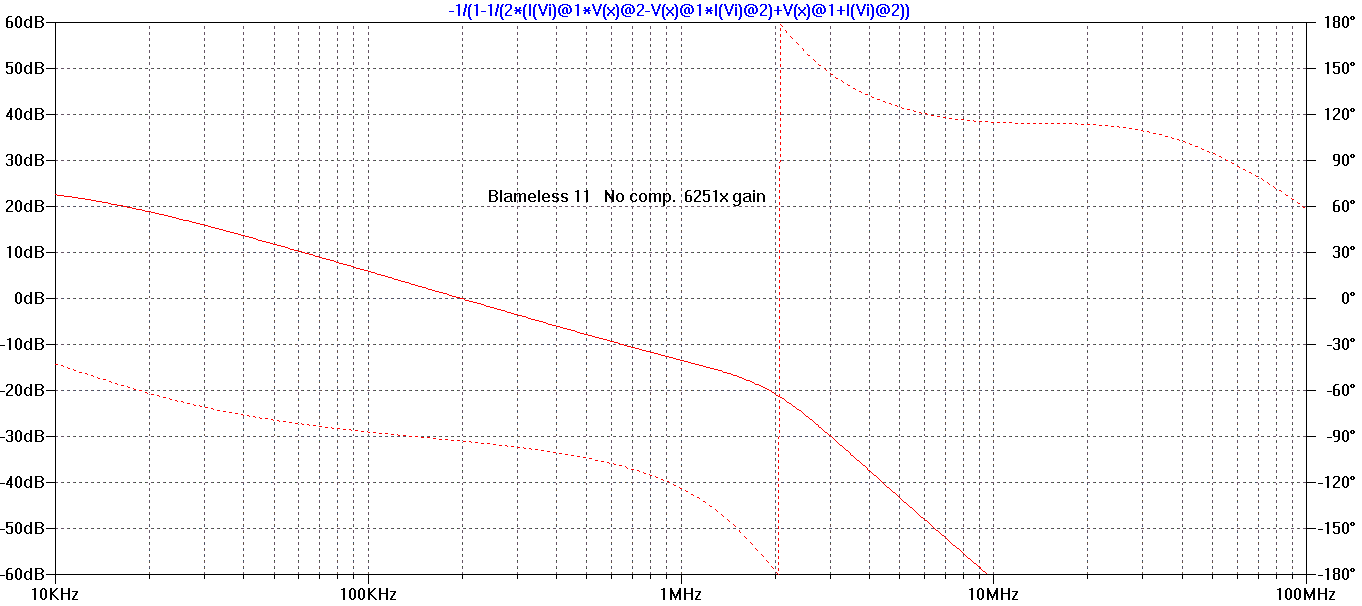

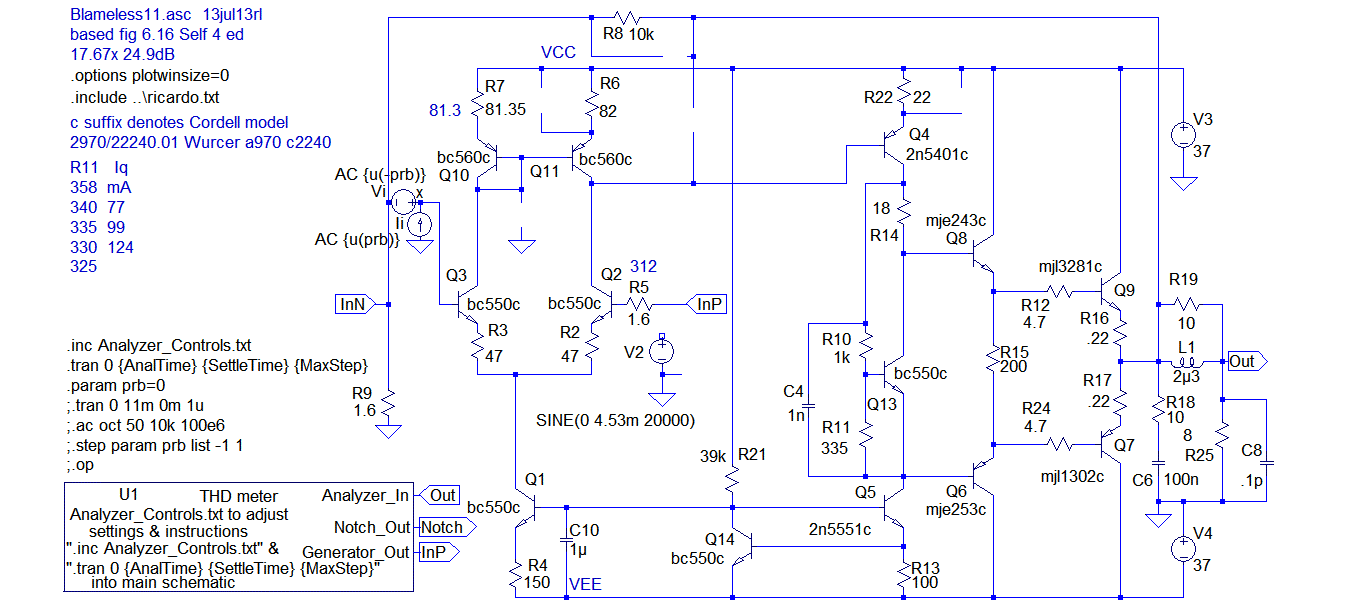

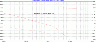

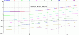

Blameless11.gif is the simple fig 3 amp described by Cherry in the NDFL paper I quote with ALL compensation removed.
Blameless11LG.gif is its Loop Gain set so UGLF is 200kHz. A very high Closed Loop gain of 6251x is required for this. At these high Closed Loop gain, such simple circuits don't need any compensation for stability.
Blameless11THD.gif is THD at 20Vrms 8R using Eugene Dvoskin's THD analyzer.
It isn't quite Open Loop THD but there's only 14dB FB at 40kHz and none at 200kHz.

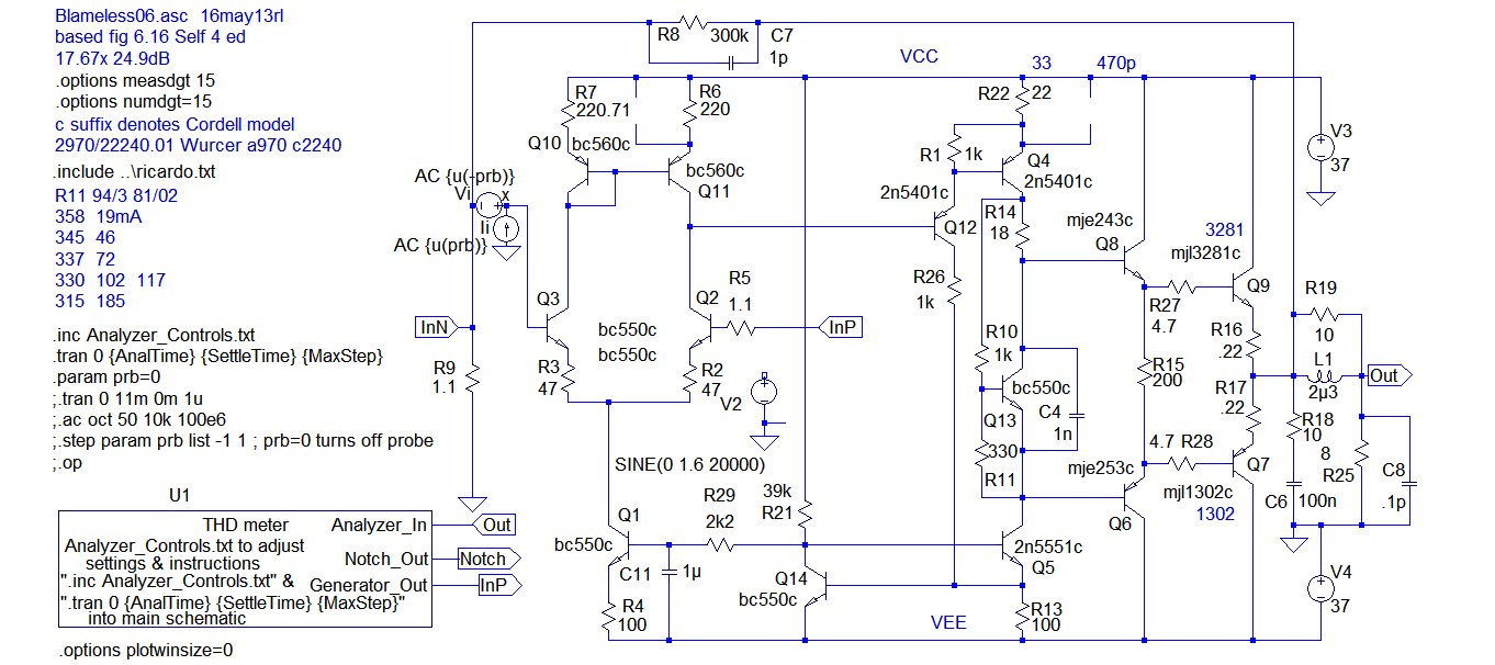

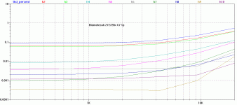

Blameless6.gif is this with enhanced VAS. Both circuits are carefully optimised.

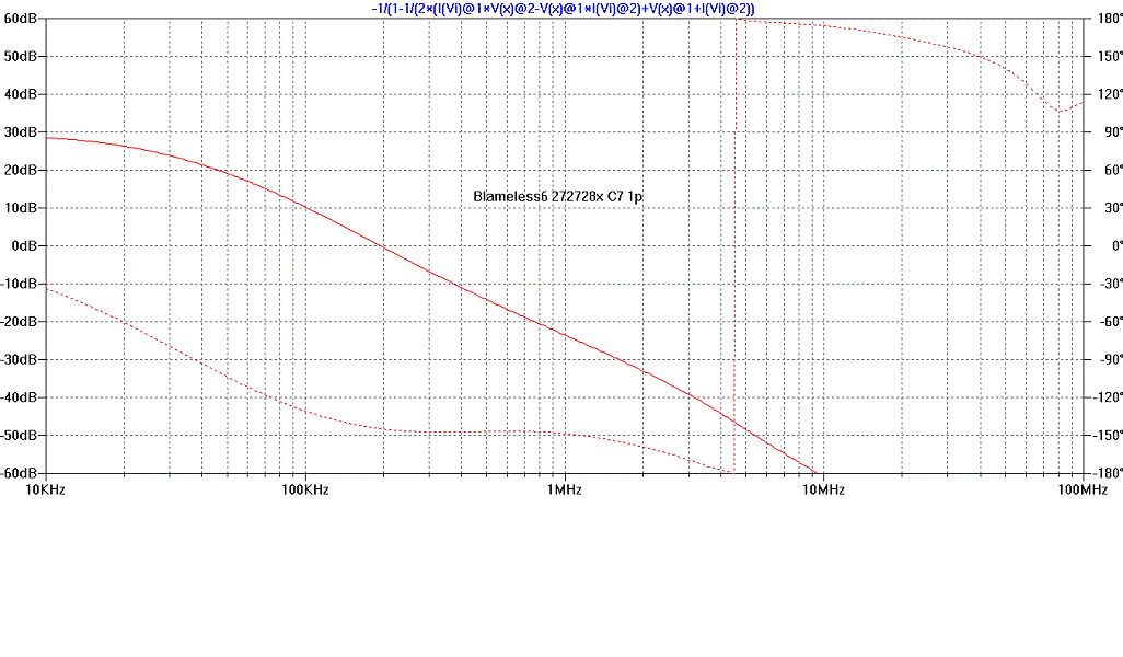

Blameless6LG.gif needs some compensation to be stable even at the huge 272728x Closed Loop gain for UGLF 200kHz. I've put C7=1p across the feedback resistor as this compensation doesn't affect THD reducing LG below 200kHz. This isn't a sensible practical compensation scheme; just one adopted for this demo.
There's about 24dB F/B at 40kHz (ie 10dB more than Blameless11).

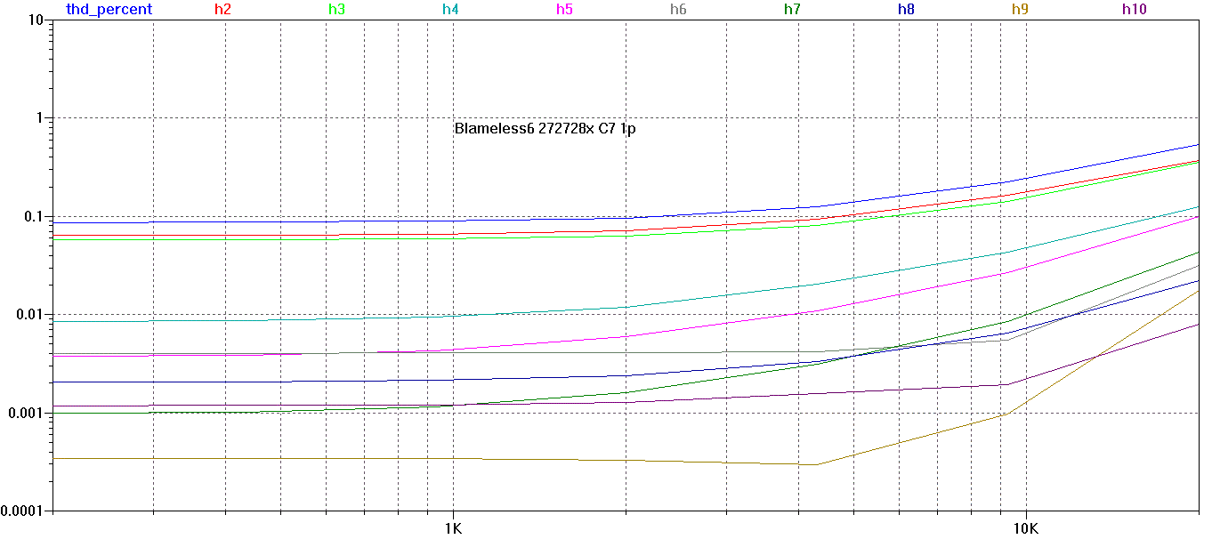

Blameless6THD.gif is the THD.
Note nearly 15dB THD reduction at 20kHz even though the Loop Gain difference between the 2 amps is 10dB at 40kHz going down to 0 at 200kHz. This is achieved mainly by a large reduction in 2nd harmonic.
Though there are other 'linearities' from the VAS enhancer (IPS has to work less hard bla bla) I submit the THD reduction, especially for 2nd is quite a lot larger than can be explained by extra Feedback.

You are right about harmonic cancellation but in my examples, you'll note that all harmonics are reduced to a greater or lesser extent.I think there should be a distinction between linearization and simple harmonic cancellation. You can make something more linear through harmonic cancellation, but the effect will be inconsistent across different loads and output levels. If the main distortion of the output stage is H2, then you're looking for a reduction in ALL harmonics as an indicator of linearity, not just H2. Otherwise it is more likely you''re canceling the H2 in which case the device quirks are combining in a lucky way. I wouldn't expect real life to mimic simulation at this level of detail.
I've used harmonic cancellation in other designs. The trick is to use it only where levels & loads don't affect the distortion mechanism which has to be 'well defined' (or 'levels & loads' are taken into account)
But in the circuits from which my examples are derived, everything has been done to sensibly reduce distortions of any sort within reason with an eye to large scale production.
If anyone wants to play with these, I can send the .ASC of the original circuits but you'll have to strip them down yourself. Its not a trivial task but you have the pics I posted as a guide.

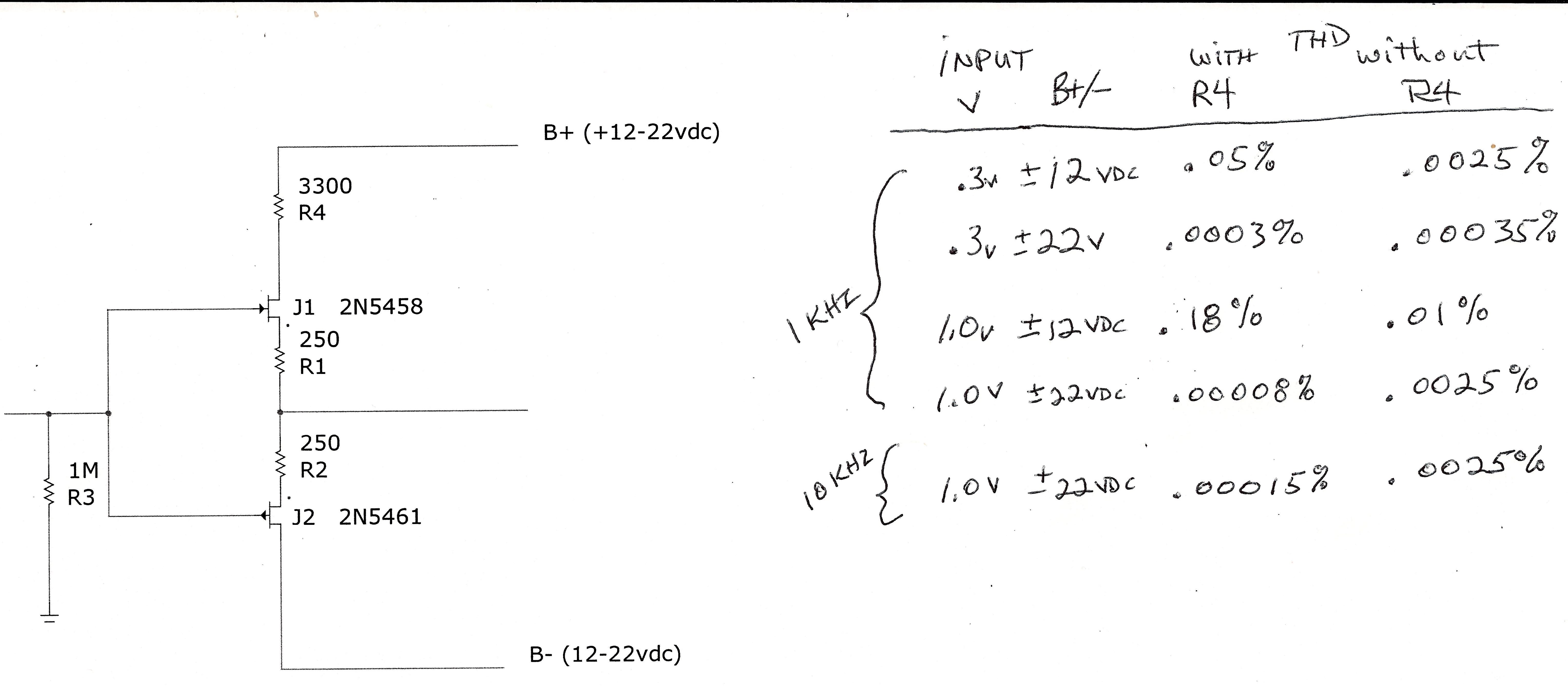

Well, cancellation can work across the whole spectrum -
Try this example on your SIMulators. I just built this on a breadboard for laughs but it is interesting and has useful, practicle application--- I mean how cheap is one resistor. These are actual measured values with real transistors and all their quirks;
How many have the right answere? The Question is why does the THD go down when only one resistor is added (R4)? Clue: The value is unique... a pot in place of R4 demonstrates a distinct THD null at the value shown. let me know if you need more clues.

You can check what I said by connecting the 1k R26 to the negative rail instead. Then plot an FFT of the TIS Ib and then the Ib of the enhancer. They should be basically the same, except for absolute level and the effect of R1 (which responds to Early effect). This should be true whether or not R26 is connected to the rail or the CCS.
I don't argue that the enhancer decreases overall distortion by increasing OLG. However I don't think it improves open-loop linearity and if anything, must hurt it a bit. If your THD is not reduced by the amount of extra loopgain, then this is the natural conclusion. If other distortion mechanisms swamp it, then these actually serve to further worsen linearity. I would assess TIS/OPS linearity by doing a .four of the output current of the LTP.
At 200Hz your THD plots are virtually identical except for H2. How do you explain this? Even if the harmonic spectrum is different, most of the harmonics should be lower. They're not. Are you sure your current mirror is not the dominant source of distortion rather than the TIS/OPS? The fact that the THD "corner" is much higher in the second plot suggests something resistive shunting the loop gain.
You may be right in the effects you observe, but I pointed out the Hfe thing because this should be taken into account. None of the mechanisms you describe could directly result in more linearity, even if more linearity is observed. It must come from some other mechanism. H2 is the main harmonic affected, so this must be the work of a counter-H2 generator. R1 could serve as this as it responds to Early effect and nonlinear Vbe, but I find the lack of reduction of any other harmonics to be highly suspect and doesn't match with an increase in OLG. A saturating current mirror might also provide this effect.
Harmonics cancellation counts as linearization, as an indirect method. However the "line" will be more jagged. You have simply removed the dominant harmonic. You must already understand this since you recognize a non-shunted TIS output takes advantage of the fact that Hfe is typically more linear than Vbe.
Also, C7 is definitely not insignificant. If it has a corner in the audio spectrum then it is probably affecting the THD results.
I may be totally wrong. I will do a simulation if you insist, but I won't be able to get to it today. All of this should be testable however by either of us.
