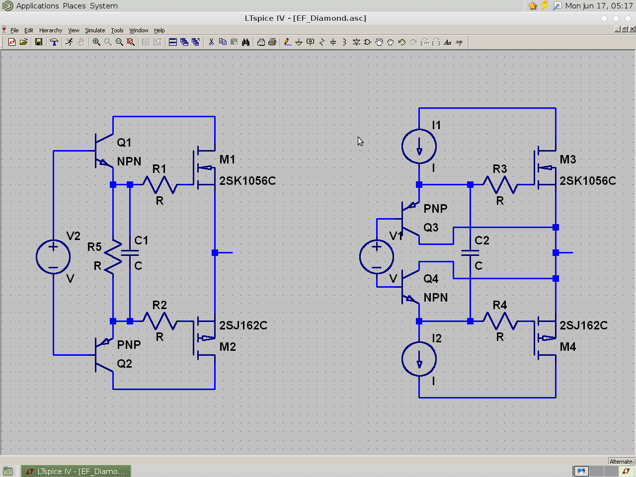

Hi Edmund. I actually did think of using a full EF for each gate after posting that, but I didn't want to add 2 more transistors. However the effectiveness of this idea seems to really justify it.
WRT the diamond and cap, if the cap is large enough I don't see how it should be different from an EF driver, except in recovery effects. In simulation the diamond configuration behaved better. However my implementation of it probably is very significant, and possibly suboptimal. Still more to explore.

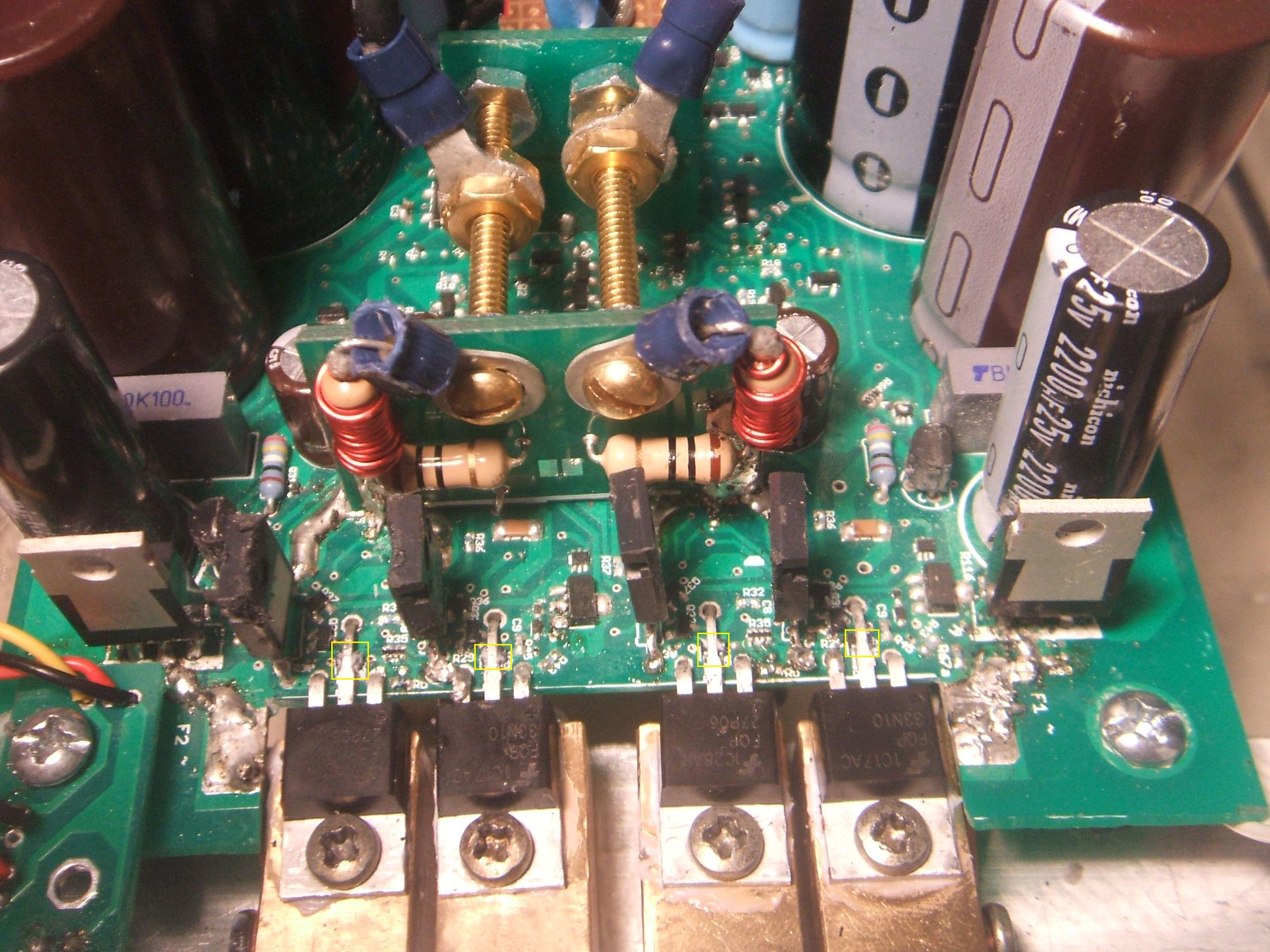

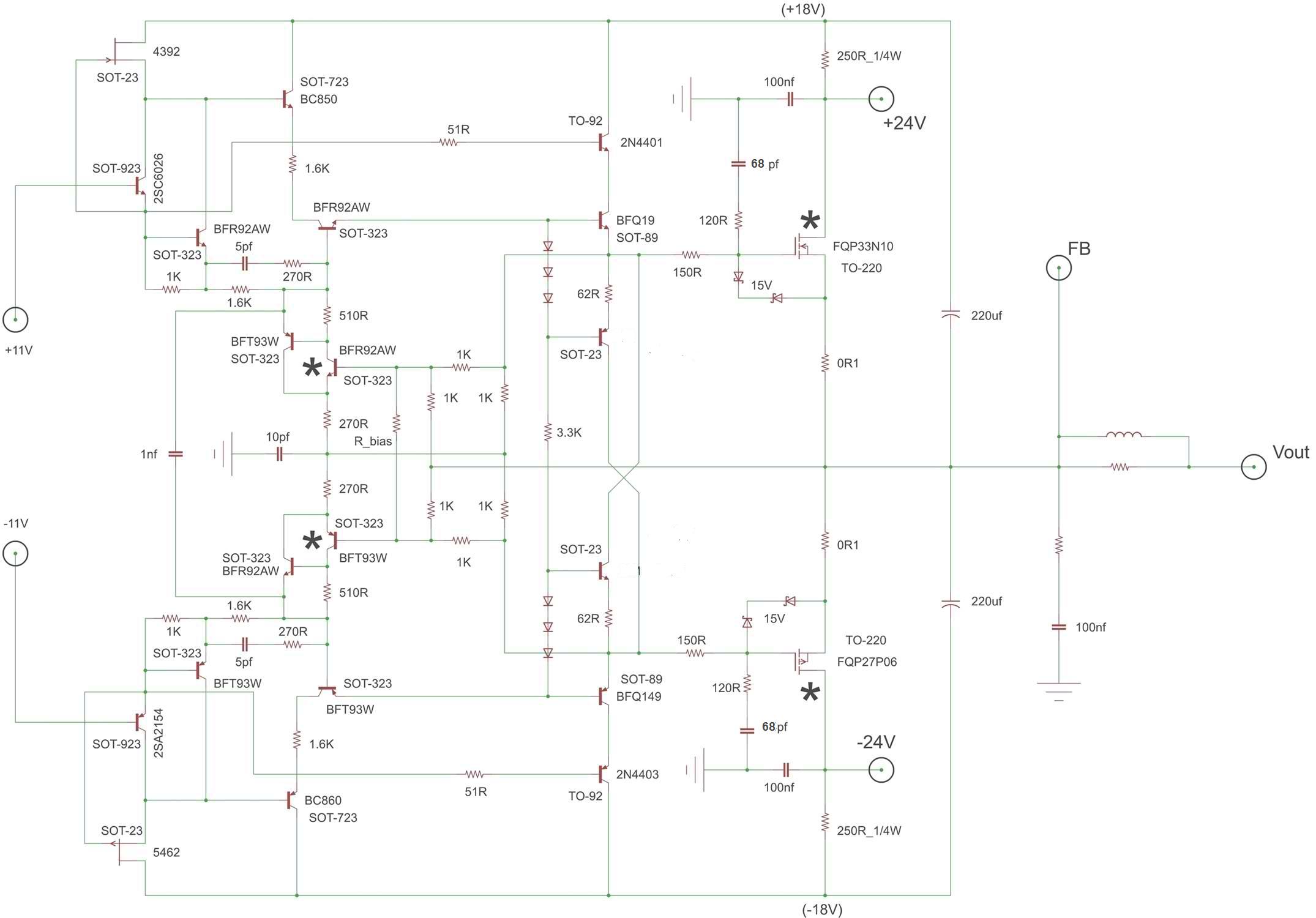

Although this circuit uses planer stripe FETs which is a version of vertical devices, this is how I am driving the gates using two seperate totem pole drivers in my home brew vertical mosfet amp for Hi-Fi. (left out are the small base/collector stopper resistors for the HF transitors) Seems to work very well.
Note: typically the pair is chosen based on Gm, the devices chosen here do not have similar Gm. I only did this on purpose to create a 'worse case scenerio' for the error correction.😀

Replace the gate stoppers with ferrite beads - works on mosfets and bipolars.
I had a low power output EF oscillating at 20 MHz - ferrite bead stopped it. Works on cascodes as well.

I must confess I have not seen this one yet - i.e., EFs rectifying and boosting the bias current when an output stage goes into oscillation. A very interesting observation to say the least.
I think the danger arises from having a very low capacitance TIS output node (a few tens of pF). In this case the drive ability of the TIS and it's max risetime are great whereas in most designs, the VAS is the first stage to slew limit.
I still don't know why a diamond would have less transient drive ability, disregarding recovery effects, if C2 is large enough to have negligible impedance. I would expect it to be more behaved because there is a very small G-S loop. For vertical outputs, C2 should be larger.

I would never use a Diamond for a BJT output stage, except perhaps for the first driver pair in a triple. However I've been referring to an Lfet output stage, not a BJT output stage.
If you take a diamond and EF driver pair in an FET output stage and bias them at the same current, it will take the same level of loading to send each into class B. So I don't consider a Diamond stage "weak" when used with FET output stages and a large enough gate bridge cap. The gate currents may be asymmetrical, but this shouldn't matter at audio where the drivers should never enter class B.
Furthermore, If the drivers do enter class B, the diamond's tendency to collapse bias is no different from the EF's tendency to boost it, except that the former is not a risk.
