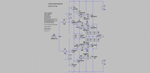

cascode amp from the book

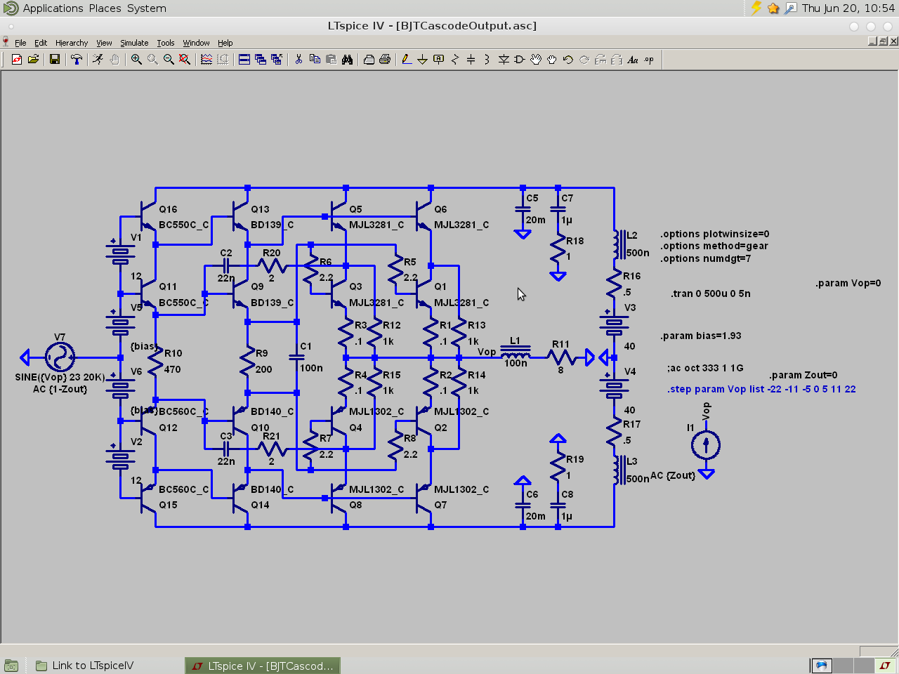

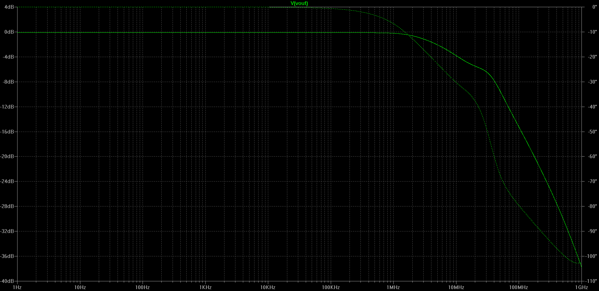

Hi Bob
I was thinking about this example of cascode power output stage, I cannot calm it
  • cascode power buffer.asc

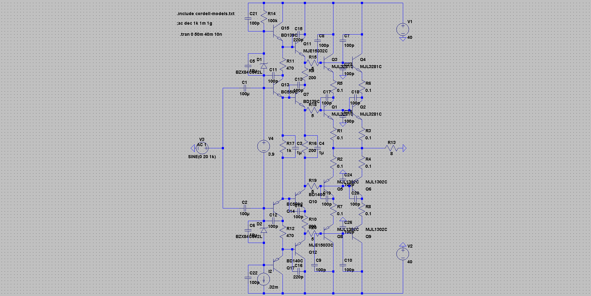

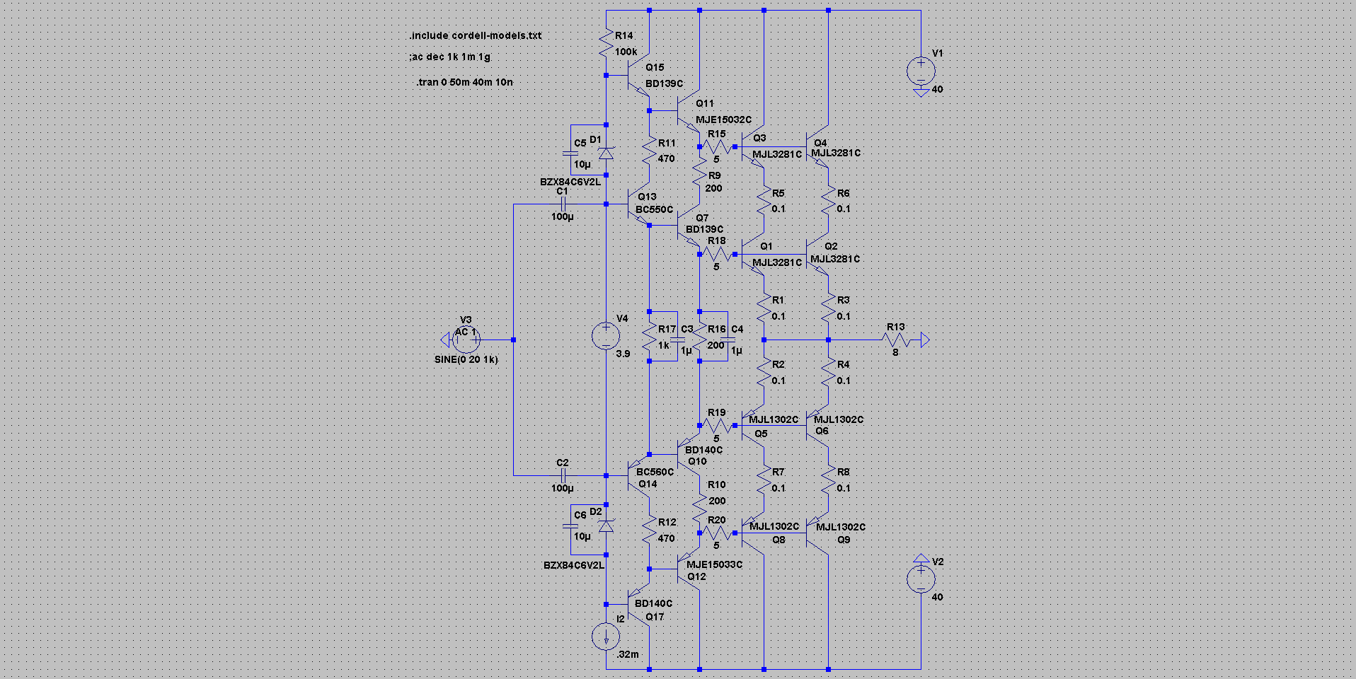

If randomly chosen miller caps don't work, try randomly chosen RCs with an Fc below that of your oscillation frequency. I found this stopped oscillation. More RCs might improve phase linearity.

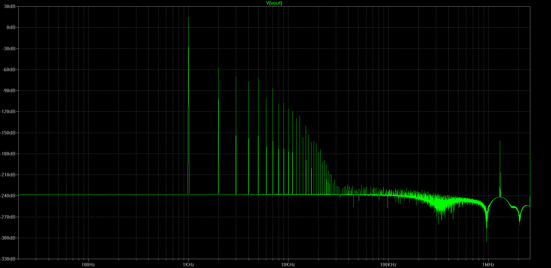

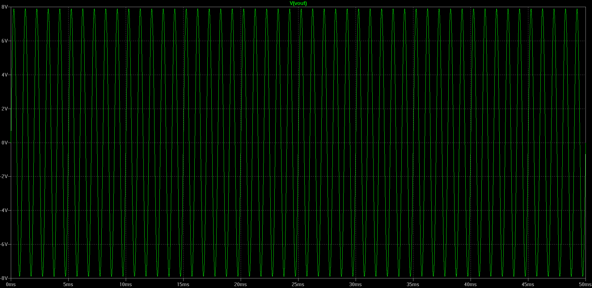

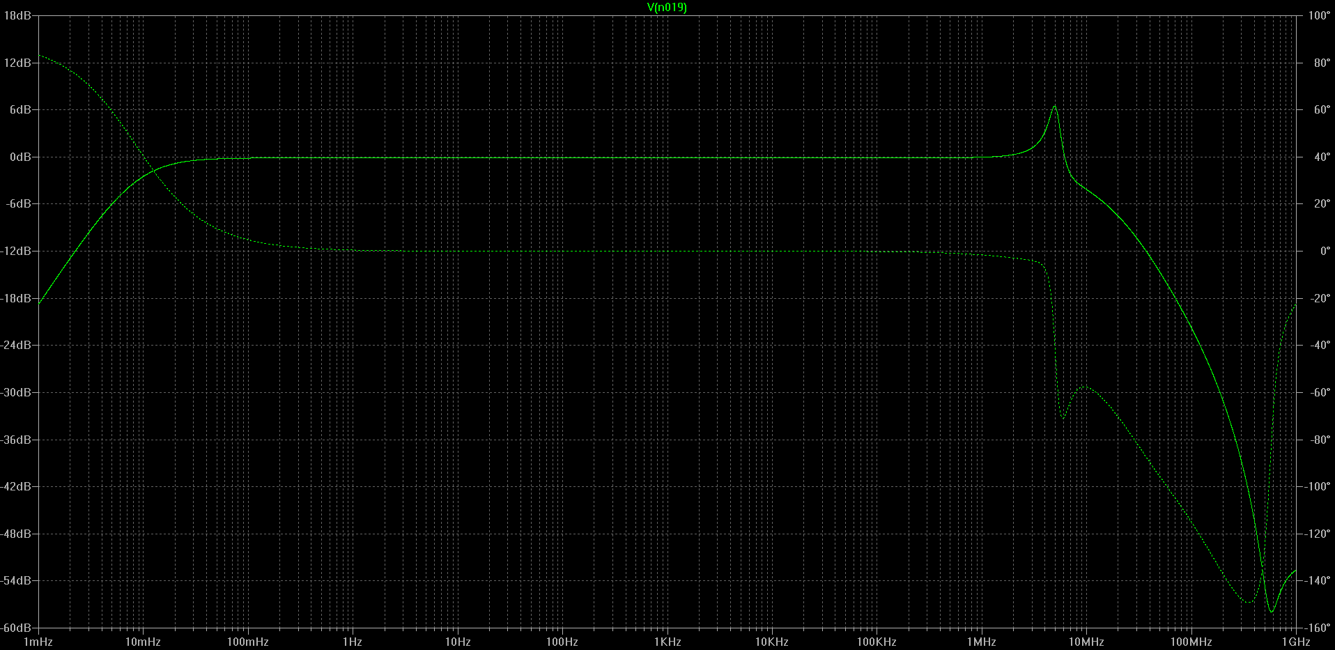

Dear Keantoken

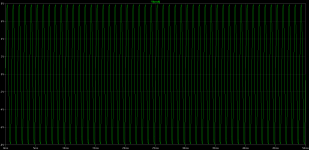

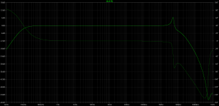

thank you, this was it however I had to increase C3,7 (on my circuit) from 22n to 220n, sims attached.
Not that bad for me.

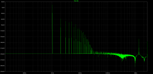

N-Period=1
Fourier components of V(vout)
DC component:-0.000631128
Harmonic Frequency Fourier Normalized Phase Normalized
Number [Hz] Component Component [degree] Phase [deg]
1 1.000e+03 7.884e+00 1.000e+00 -0.01° 0.00°
2 2.000e+03 1.937e-03 2.457e-04 -89.04° -89.04°
3 3.000e+03 4.242e-04 5.380e-05 -8.43° -8.43°
4 4.000e+03 1.931e-04 2.449e-05 -87.98° -87.98°
5 5.000e+03 3.445e-04 4.369e-05 -1.22° -1.21°
6 6.000e+03 1.169e-05 1.482e-06 -82.96° -82.95°
7 7.000e+03 6.982e-05 8.856e-06 0.68° 0.69°
8 8.000e+03 5.218e-06 6.619e-07 87.23° 87.23°
9 9.000e+03 5.952e-06 7.550e-07 9.26° 9.26°
Total Harmonic Distortion: 0.025660%
