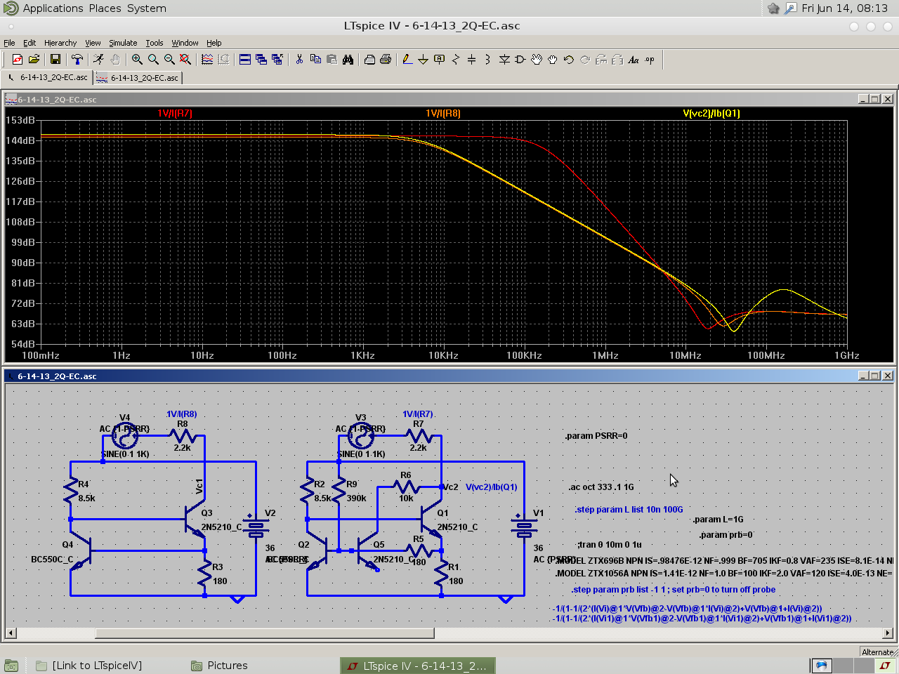

I'm aware the ANF CCS is good. My question was whether using more than just one stabilizing component had any beneficial effect on output impedance. Output impedance is best with no compensation, but it cannot be improved much with more loopgain because the feedback node is not at the output.
However you can use error correction. There may be capacitance variation and so on but even if the capacitance is off by 10% you still get 1/10 of the output capacitance. The 2.2k resistor curbs reactance at RF. R5 = R1. By increasing R5 you can get a complete null at the corner, resulting in a parallel resonance at 150KHz, if you like. R6 controls the series resonance at 20MHz.
Because the error correction capacitances track, the THD of the error signal itself should be lower as well. This effect applies even if local parasitics prevent a null. If you don't want to use the extra transistor, you can use a cap, but the dynamic null won't be so good.
Here is the Zout of the standard ANF CCS and an EC/PFB CCS. Red trace is the right circuit.
I've also plotted Zcb showing that Early affect shunts output resistance causing the vast majority of output conductance. Notice that because the EC transistor is not turned on, it doesn't correct for Early effect; but if it were, output resistance could be much greater depending on matching.

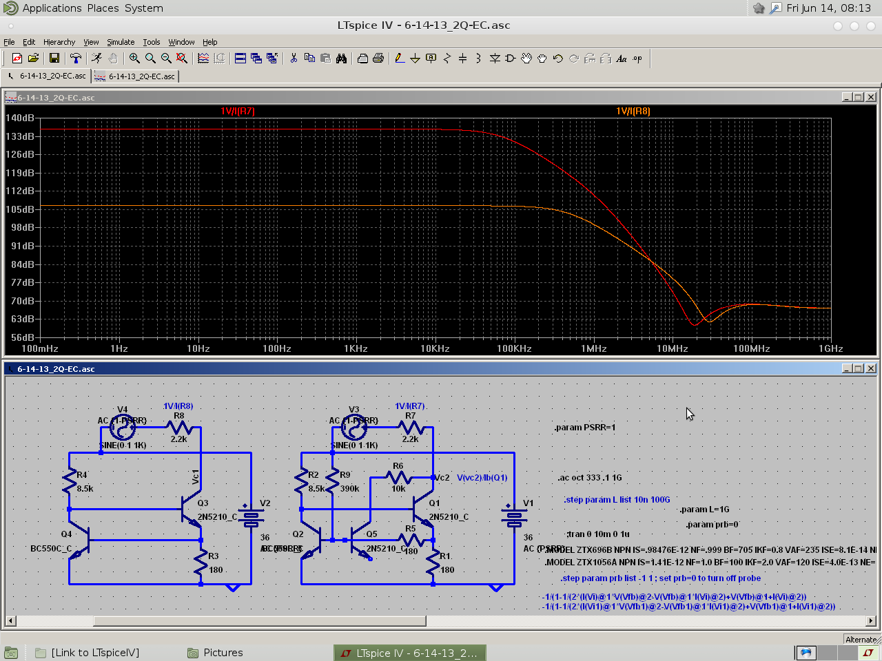

Next plot is the PSRR. R9 cancels PSRR. This resistor can only be approximated unless you have a detailed way of calculating it. A very basic estimation is V(R2)*(R5+R1)*31.5.
So, for what circuits is there any point in going this far? It may help for a very sensitive VAS node in an opamp or triple EF. It may also help with nodes sensitive to nonlinear capacitance, causing distortion.

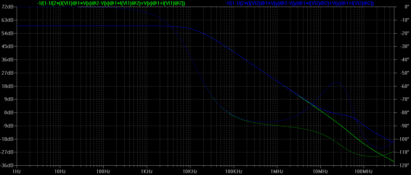

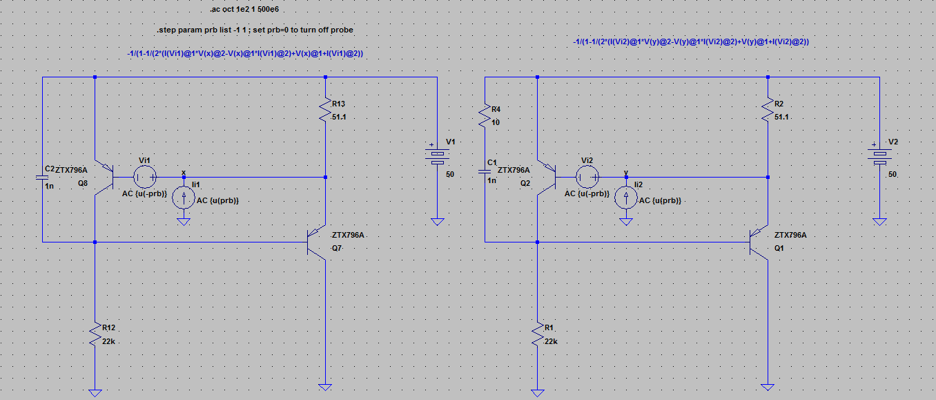

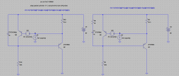

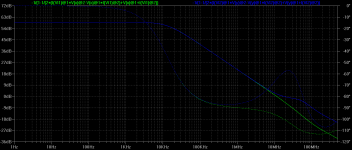

can be further improved by introducing a zero in the loop gain characteristic in the region of unity gain frequency. This is done by connecting a small resistor (~10R) in series with the capacitor shunting the collector-emitter of the control transistor in the ANF current source.
Phase margin increases from 83 degrees without the series resistor (green trace) to 122 degrees with the series resistor in situ (blue trace).
