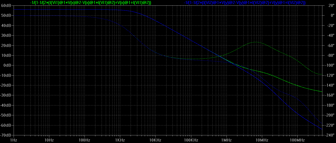

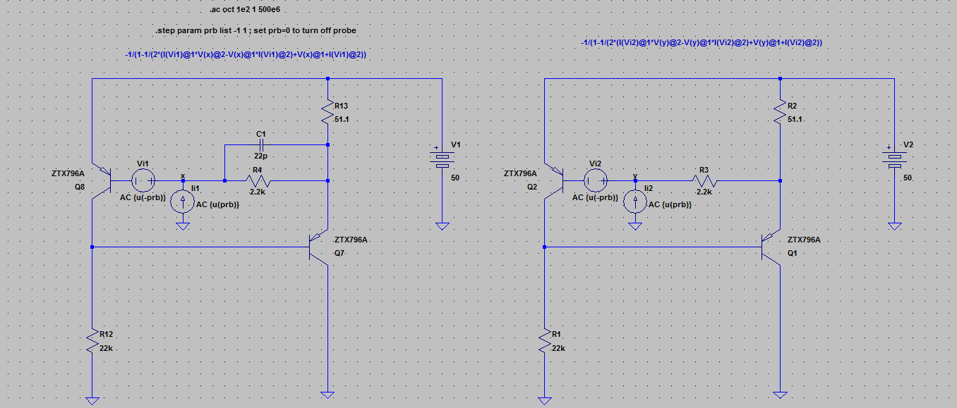

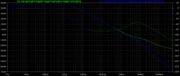

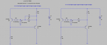

To further enhance stability margins in the ANF current source, a 2k2 resistor in series with the base of the control transistor is shunted by a 10pF~22pF capacitor as shown below.
The capacitor introduces a zero close to the unity loop gain frequency; this increases phase margin from 83 degrees (blue trace) to 114 degrees (green trace).

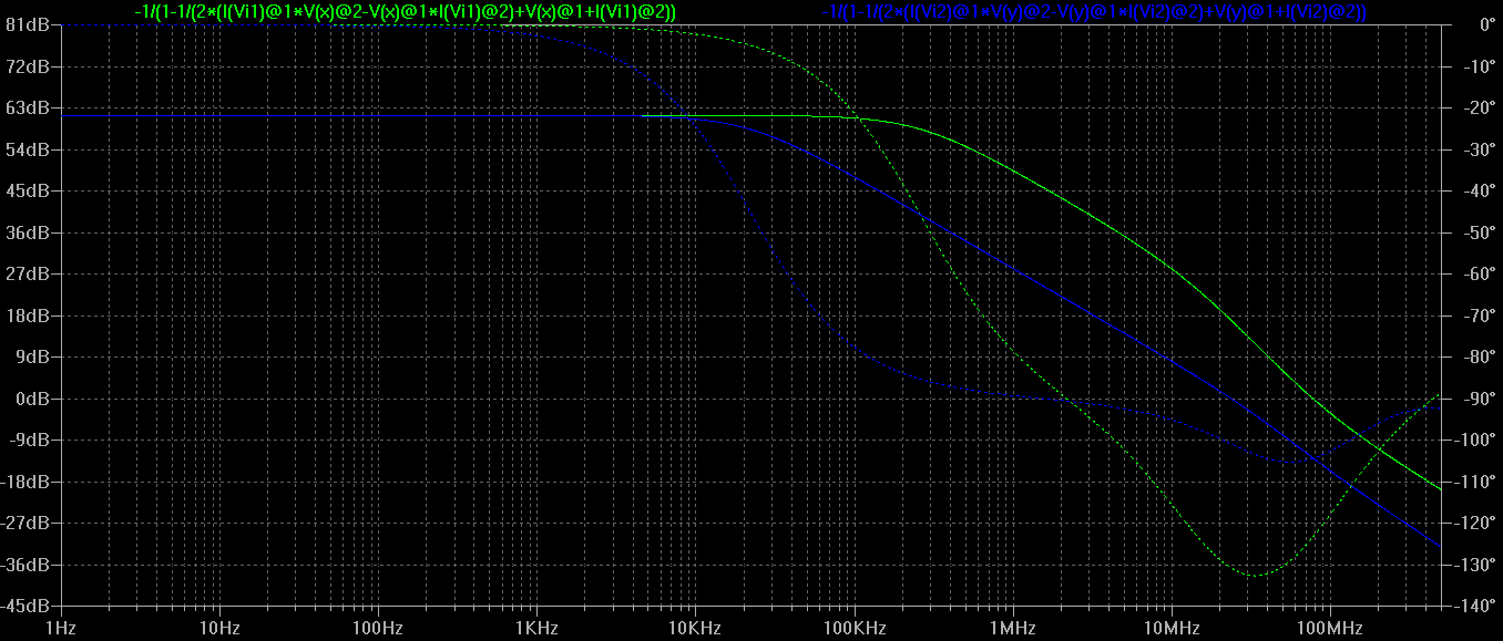

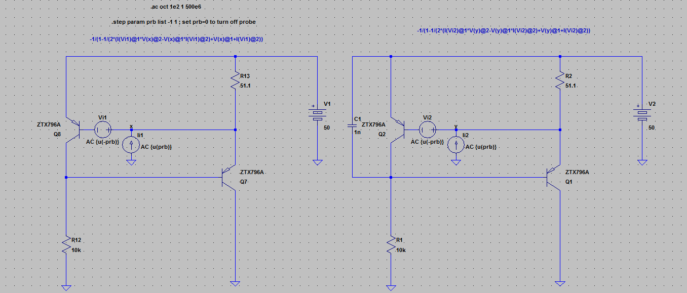

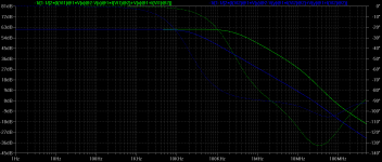

It would appear A&R Cambridge were concerned about instability in the amplified negative feedback (ANF) current source in their A60 amplifier.
They used a 1nF capacitor shunting the collector of the control transistor of all their ANF current sources instead of using a resistor in series with the base of the control transistor:
http://www.retrohifi.co.uk/a60_amp_service_manual.pdf
I simulated the ANF current source loop gain with the 1nF shunt capacitor across the collector of the control BJT and it does indeed reduce loop gain at high frequencies by introducing a dominant pole at about 20KHz.
The blue trace gives the loop gain with the shunt capacitor, while the green trace gives the loop gain without the capacitor.
