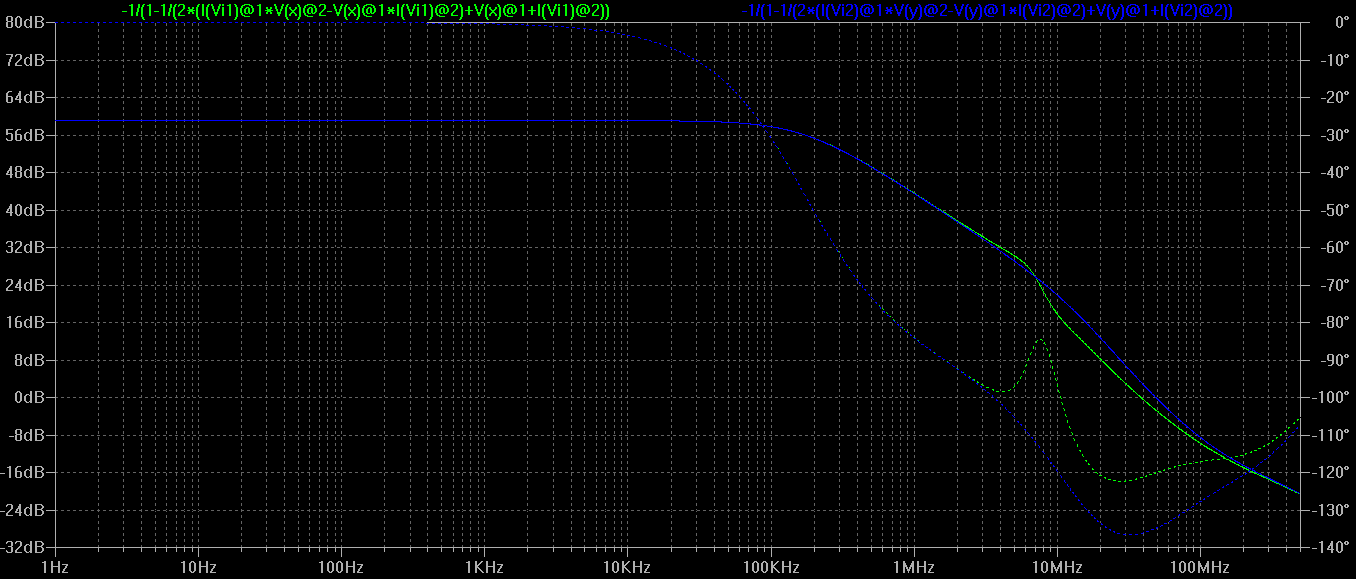

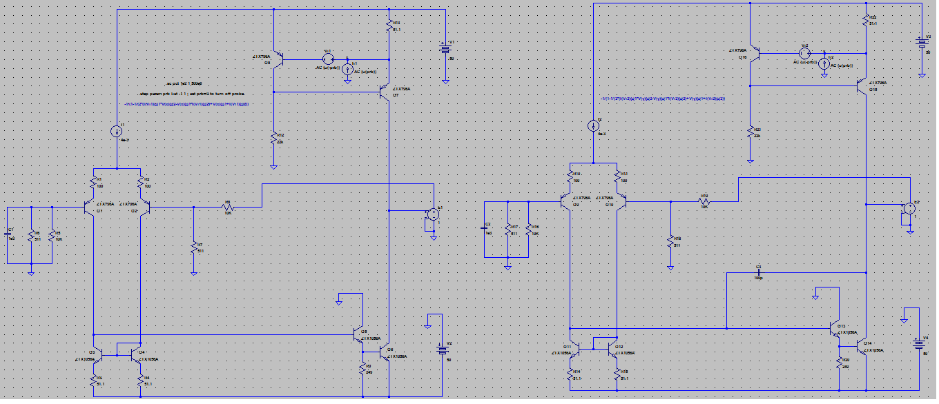

Hi Harry,
That this view is incorrect may be established by running a simulation of the loop gain of the amplified negative feedback current source with the very large inductor removed from the collector of the source transistor so that said source transistor is loaded exclusively by the output impedance of the transimpedance stage's transistor. The latter is then effectively an active current sink for the ANF current source. See figure below.
Now, if the large inductor (used in the circuit on the left to isolate the ANF current source from the rest of the circuit) behaved like a current source, as you and Bob contend, then the loop gain in both instances (with and without the inductor) would be virtually the same.
In fact the loop gain local to the ANF current source without the inductor to isolate it from the TIS current sink is over 40dB greater within the audio band than that obtained with the inductor in situ. (Blue trace: without inductor; green trace: with inductor).
This suggests that far from behaving like a current source, as you aver, the inductor in this case merely acts to isolate one circuit node from another at the frequencies of interest as Rosenstark indicates in his paper “Loop Gain Measurement in Feedback Amplifiers" Int. Journal of Electronics, Vol. 57, No.3., pp. 415-421, 1984 and in his book "Feedback Amplifier Principals".
From the figure below it is apparent that the true loop gain local to the ANF current source is obtained with its collector isolated from the rest of the circuit at the frequencies of interest by the large inductor.

Hi Mike,
You are finally beginning to get something that resembles the right answer, but you are drawing the wrong conclusion based on a wrong understanding of the VAS circuit in the closed loop amplifier and with the Miller compensation.
Your statement that the current source loop gains should be the same whether the inductor is in or out is wrong. The VAS node DOES NOT look like a current source for AC. It looks like a fairly low impedance because the feedbacks in the amplifier keep it that way. This allows the feedback current source to function normally. This is why your loop gain analysis came up with the larger loop gain number that all of the rest of us have been asserting all along.

Hi Harry,
It is not a "view", it is fact.
Do you deny that a charged very large capacitor behaves like a voltage source? Very large inductors are the dual of very large capacitors. Very large inductors require a very large volt-second product to be applied in order to change the current flowing; very large capacitors require very large current-second product to be applied in order to change the voltage across them. Which of these facts do you deny?
When you run a frequency analysis in LTspice, the first step is the determination of a DC operating point; this allows all non-linear circuit elements to be replaced with linearised models at their respective operating points and for the initial voltage or current in energy storage elements (respectively capacitors and inductors) to be determined.
The DC operating point analysis of the circuit with the very large inductor will determine that a certain DC current is flowing through it. Do you deny this?
V=L * di/dt Do you deny this?
di = V * dt/L Do you deny this?
According to the equation above, if L is very large, this requires the V*dt product to be similarly large in order for the current to change a non-negligible amount. Do you deny this?
In the frequency analysis, an effectively infinitely small ac signal is used to analyse the circuit's frequency response. Do you deny this?
From where is the very large voltage required to change the inductor's current going to come?
Answer - it is not going to come from anywhere and the inductor is behaving like a current source.

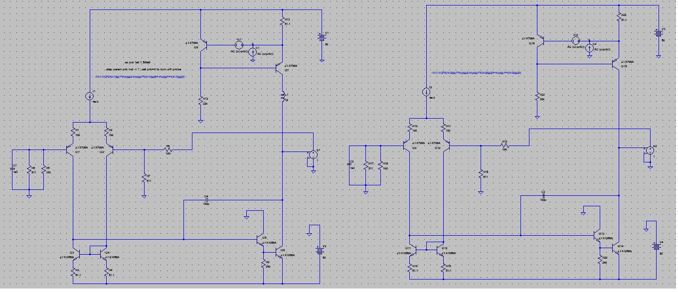

This was what I thought initially; viz. that because of minor loop feedback the TIS couldn't funtion as a current sink. I was wrong and so are you.
I established this fact by removing the miller compensation capacitor on the amplifier on the left and removing the inductor in both cases. If the minor loop feedback were to make a difference, then the loop gain local to the ANF current source would be radically different in both cases. It isn't. See below.
Mike,
I'm not entirely sure why you even want to measure the current sources' loop gain when it's isolated from the rest of the circuit. Surely what matters is the stability of the loop when the circuit is operating normally, i.e. current source and TIS are not isolated from one another?
A large inductor is not always the correct component to "isolate" one part of a circuit from another.
Suffice it to say that it is used both in practice and in simulation to isolate circuit nodes from each other at the frequencies of interest by a great many luminaries in the field who would disagree with your averment.
Mike,
As you've noticed by now the loop gain of the ANF current source is highly dependent on its collector load.
Thus, the purpose of isolating it from extraneous circuitry is to establish its intrinsic loop gain.

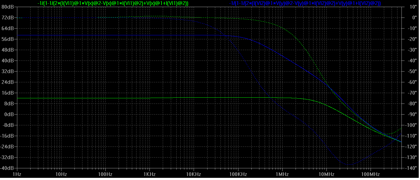

You are still not getting it right. There are TWO loops of negative feedback that both act to create a very finite impedance at the output of the VAS. You are ignoring the global loop.
You would better off at this point to honestly establish for yourself the truth by abandoning all of the complex mistake magnets in what you are doing and first do the simple sanity check with a feedback current source TOTALLY by itself with a reasonable resistive load to the rail or just conneted to the rail. THEN, once you have convinced yourself of that, you can go on and try to figure out why you are magnetically attracting so many mistakes in your present approach.
Bob
The major feedback loop has no impact, at least to a first order, on the output impedance of the TIS. You can confirm this by disabling the major loop by means of a large capacitor shunting the inverting input of the amplifier to ground or using a large inductor in series with the inverting input of the amplifier.
Further, Bob, I have also demonstrated that the minor loop has no effect on the loop gain of the ANF current source. Why do you find this so difficult to appreciate?
Tomorrow I'll do as you've asked; viz. run a sim of the loop gain of the current source with a resistive load.
The results with an without the miller cap are the same, because it is global feedback that reduces TIS Zout, not miller feedback, in order to prevent signals at the VAS output from causing error in the output.

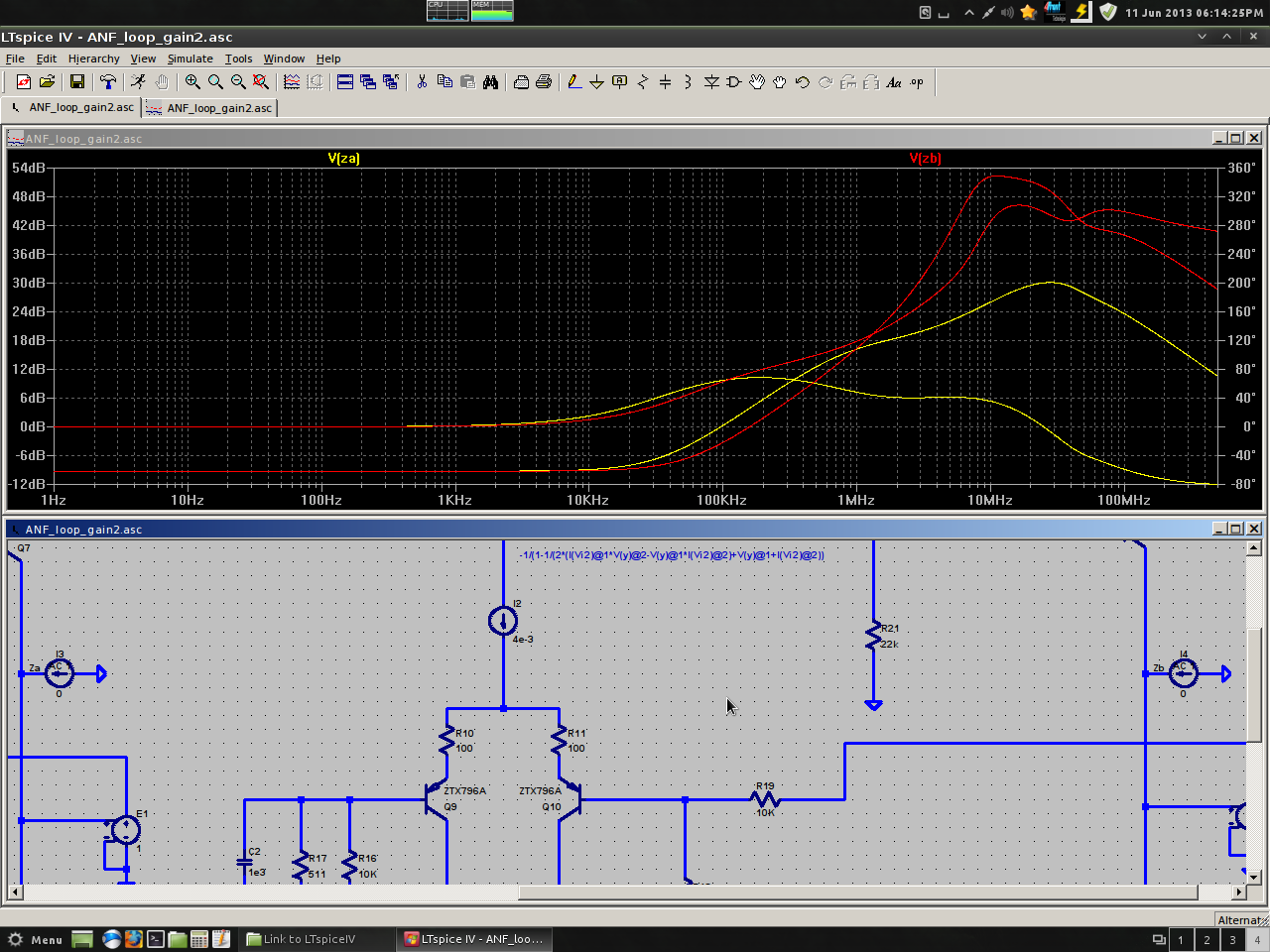

Here is your simulation modified to actually show the TIS Zout, instead of assuming what it is. It only changes at RF, where it DOES make a difference as your plot in your post shows.
