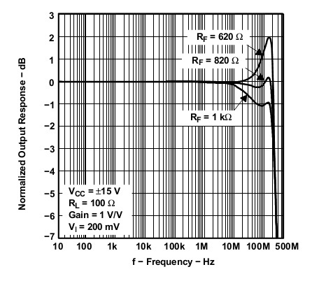

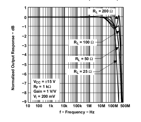

One can many times have a amp stable with such a plot but it could maybe be made unstable with certain loads. Note that the plot from post 3176 is much more desirable in my view as this doesnt really have any peaking, maybe 0.3 db ?
See the following plots as examples:
In the first when rf = 1k there isnt any stability problem (peaking below 2db), when rf=820 there is some concern, at rf=620 its either on the verge of oscillating or already unstable.
In the next plot there is only some concern when rl=200.
Referencing the response peak above, at what point is this peak in response not a concern? Is there a point where it is so far away from unity that it does not matter? Or is it always a concern?
Manso,
the 1k plot in the left diagram shows peaking.
The peak is well below the 0 ref level.
But if you were instead to compare the peak to the plot that by 130MHz would be way below -2dB. The peak height is indeterminate (for me) since I cannot estimate where the attenuation would be if the peak were removed.
In the right hand graph the Rl=100r is showing considerable peaking.
Rl=25r is also showing an anomaly, whereas Rl=50r seems like a very gradually increasing roll off steepness.

This is exactly what kgrlee was asserting as I understood it, that any anomolises in the minor loops would show themselves in the closed loop response such as peaking. National are basically making the same statement. It takes a lot of practical experience to come to this conclusion but Ive had the same experience in limited experience, as long as the closed loop response falls monotonically like Bob Cordell says, there is absence of any substancial peaking ( around 2 db or more) the systen is going to be stable. This in reverse would suggest everything is fine in the minor loops.
Maybe someone can show a plot and a built circuit showing the oscillation where this is not the case ?? The amp mentioned in Bobs book is unfortuneatly not built so cant be used.
Andrew youre correct, National claim that at peaks at 2db and less their opamps will be stable, most of those are but some are on the verge. They make this assesment from a closed loop plot and not from the usual loop gain plots.
If I understand correctly I would say when these peaks are at frequencies higher than ULGF and gain margin is good (10db min). This is my experience though, someone else with different viewpoint or experience ??

Sorry my question wasn't phrased that well but yes your understanding was correct.
My thoughts were that you reach a point where the max frequencies of your medium and power devices are reached and this would have an effect on the closed loop gain plot. Would this mean that using the closed loop gain plot to look for local instabilities is no longer valid when looking at these frequencies? The effect of the maxing out of power devices may causing peaking themselves but not the sort of peaking that would suggest local instability problems.
