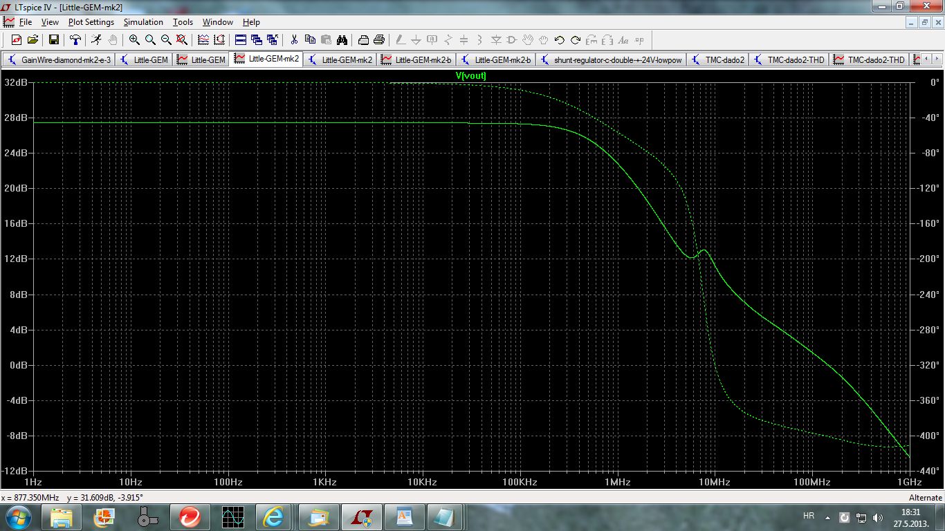

Does this Closed Loop Gain look OK, ULGF is 720kHz?
Damir

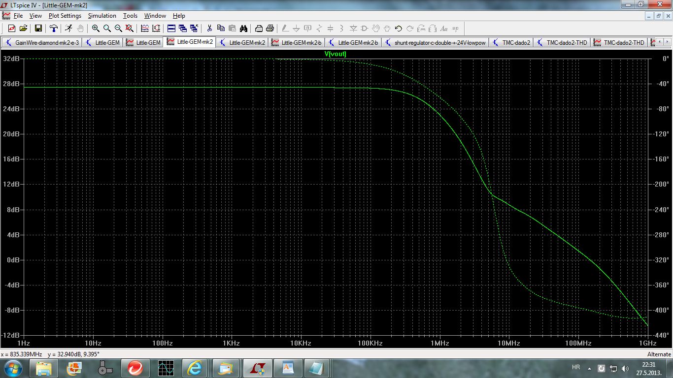

Damir
No, that peak is not OK in my opinion, and may be a red flag for local loop stability concerns. Something is going on there at 9MHz.

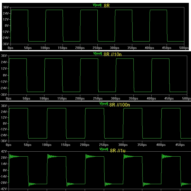

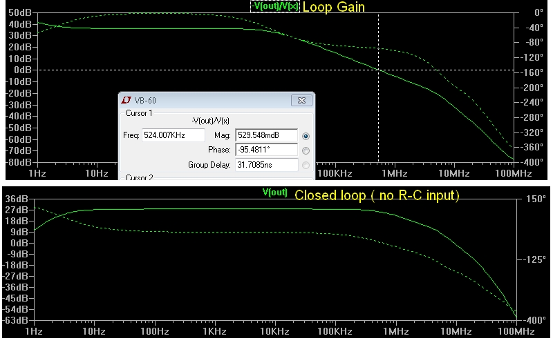

Yes you are right, is far from the amp, I used a real amplifier circuit in spice.
By simulations noticed that it is hard to define the values for R-C LTP because the pole is at low frequency and what really matters is Roll-off at high frequency.
I did a table noting the values of the crossover, "gain and frequency inversion" (GMF?), I set the values in (10p + 330 Ohm R-C network) and 680p + 1K LTP that was what gave me better margin (-26dB).
The results are amazing (for me they are), considering a simple circuit, Hitachi generic:
Hx100 Power Amplifier by AmpsLab
My circuit is slightly different and use triple output (T), Base stopper was required in the output transistors.
The Slew Rate with MIC is ~80Vus (Rise Time 0,75us).
The simulations in square wave (10Khz) has filter R-C input, but without output inductor.

I agree with Mr Cordell here, that doesnt look good at all, peaking looks in the region of 2db, my guess that circuit is either on the verge of oscillation or already oscillating. That plot looks like one taken from after the inductor, what does it look like before ?
