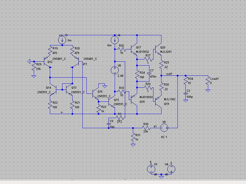

Hi Bob,

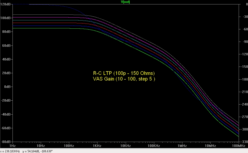

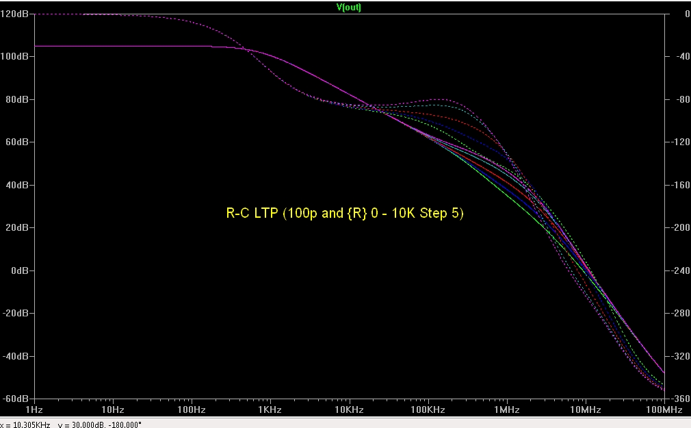

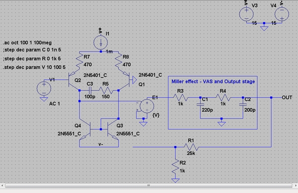

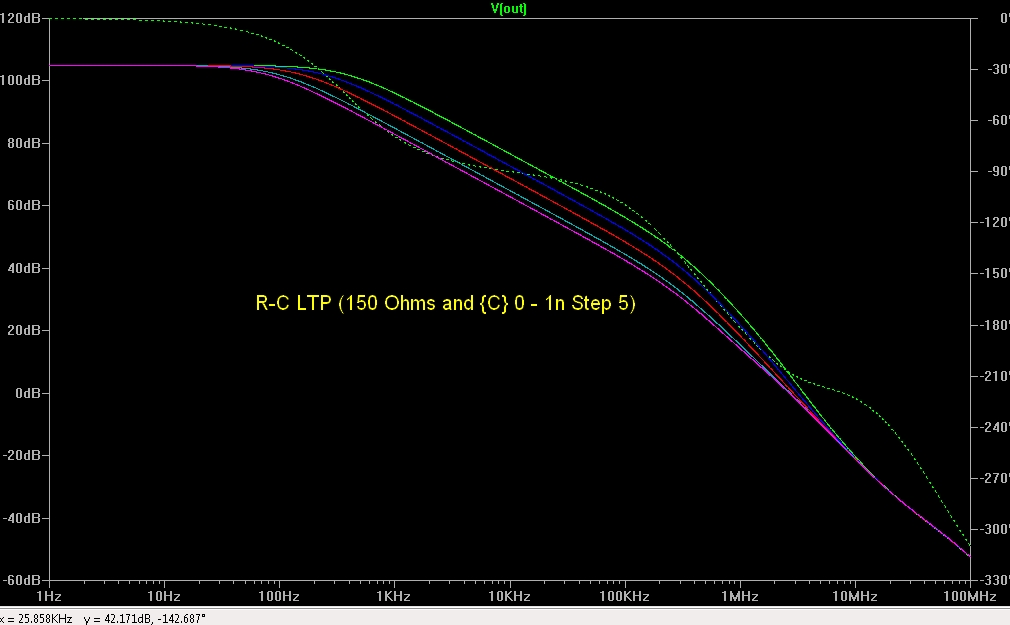

I did some simulations in an ideal circuit, did confusion, I say that capacitor in LTP has high attenuation, this is not true at the output of LTP the attenuation is 6dB/8°, The global effect can result in a high attenuation.
Here is my circuit and simulations:
I found best with a LTP real, the second order filter at the exit leave the circuit unstable.

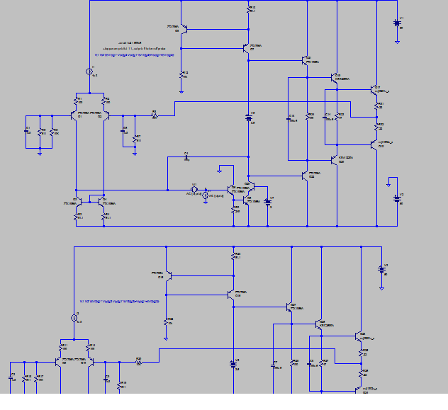

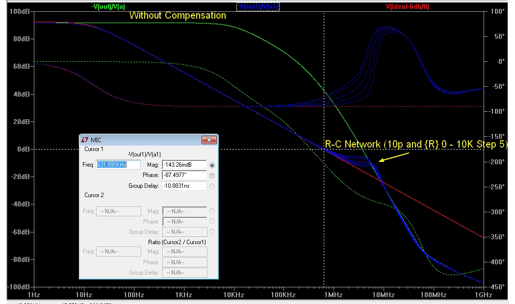

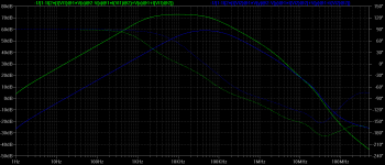

Bob, I reckon you need to check the stability of the minor loop in figs. 3.13 & 3.14.
You've got three transistors in the minor loop; this is unlikely to be stable.
I have run a minor loop gain sim of your three transistor TIS (green trace) compared to the loop gain of a two transistor TIS (blue trace).
The three transistor TIS generates greater minor loop gain especially within the audio band, but is unstable, with a phase shift of 185 degrees at unity gain frequency, while the two transistor TIS has a phase shift of 153 degrees at unity gain frequency.
To stabilise the minor loop of the three transistor TIS you need at least 100pF shunt capacitance at the TIS output.

Hi Mike,
You make a good point. I'll check it out with some simulations. This is definitely an issue that I should address head-on in the second edition. In a number of cases I have been using a series R-C shunt on the VAS output node (even when not using MIC). Indeed, it has often been on the order of 100pF and maybe 100+ ohms.
I have also had some suspicion that issues like this have been partly involved in the instability of Triples that some have seen.
More recently, I've seen some interactions where I used a helper transistor on the IPS current mirror load. This was in cases where I used a VAS preceded by an EF and a Triple output stage.
One of the things, possibly related to all of this, that I have been looking more closely at is gain margin. I have seen numerous cases where there is above-band peaking in the closed-loop response. While this does not necessarily suggest dangerous instability, it can be a troubling wake-up call. 6dB of gain margin is often safe enough against oscillation, but it takes about 10dB of gain margin to have a monotonically decreasing closed loop response above the ULGF. Interestingly, in most cases where I have enforced a 10dB gain margin, phase margin was well over 60 degrees.
This underlines the need for people to measure the closed-loop response of modern amplifiers up to at least 10MHz.

Bob, that resonance after the ULGF is trouble regardless of closed-loop stability. If you measure output impedance you'll find there is a peak there. The amplifier output node becomes an RF resonator. It is usually benign, but I try not to take the chance. You may have noticed that it is common to underdamp this resonance in order to lift phase at the ULGF so stability increases. Stability is thus dependent on the consistency of this resonance, which in all likelihood is the amp's output inductance resonating with the OPS parasitic capacitance. Both an amp's output inductance and its OPS capacitance can be (depending on compensation scheme) fully at the mercy of every parasitic element in the amplifier. Thus to attain reliability with this method one has to swamp out these parasitics and ends up losing whatever was gained, if anything was in the first place.
Making an amp stable and precise is hard work, and once one is finished they must immediately move on to the equally hard work of ensuring it behaves this way in all practical conditions without losing the performance gained in the previous step. A deep understanding of the inner mechanisms helps to ensure that one doesn't fall prey to constant regressions in design. Designing a reliable amplifier with great specs is an exercise in full design context.
While I hesitate to say this is always the case, my experience has been that such 'above bandwidth peaking' is usually cos there is an inner loop that may have wonky stability. TMC and 'pure Cherry' are prone to this but even plain Miller can show this if the load on the VAS is wonky enough to affect its stability. The 'ULGF' of the inner loop is usually a lot higher than ULGF of the main loop.
I think you need to look at each internal loop if you see this. I'm also going to claim that if the Closed Loop response looks OK, all the inner loops will probably be OK. 🙂
