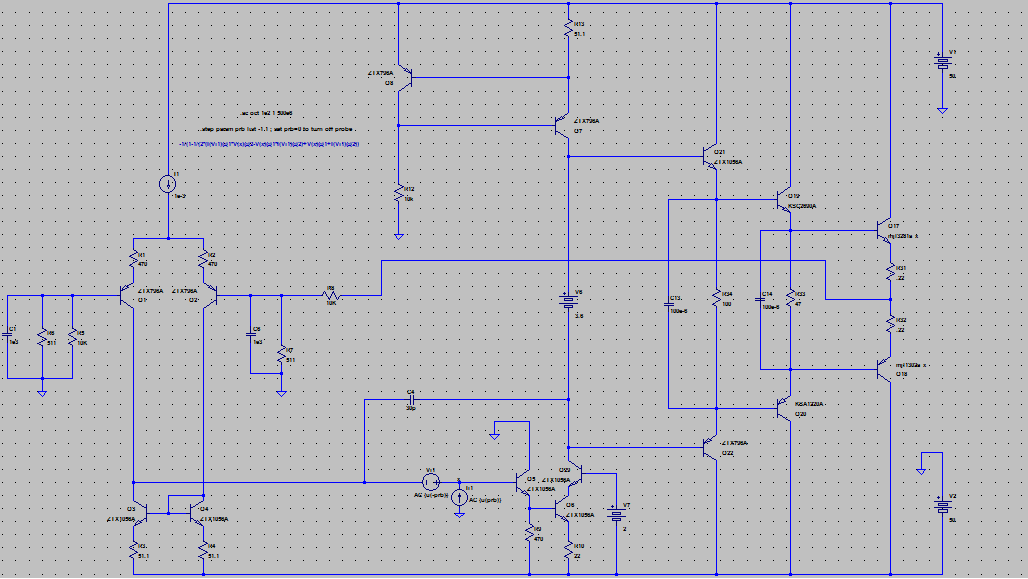

Hi Bob,

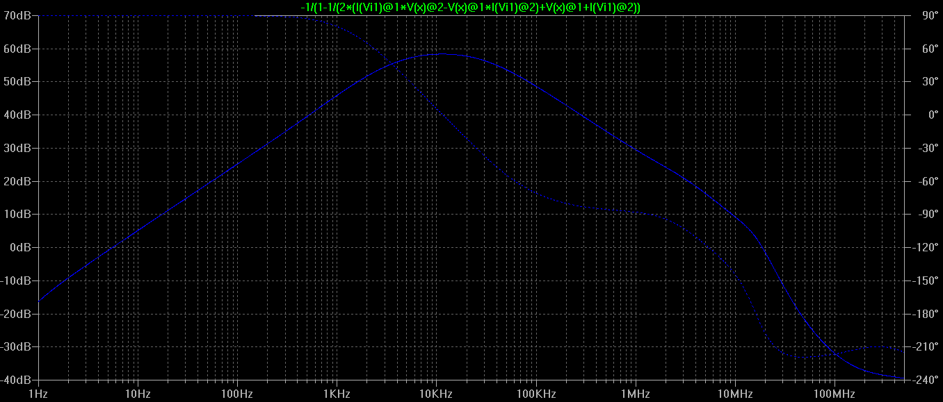

Here is the minor loop transmission simulation with your component values. Phase shift at unity loop gain is 192 degrees. Still unstable.

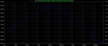

Bob, minor loop phase at unity gain with emitter resistor 192 degrees. (blue trace);
minor loop phase at unity gain without emitter resistor 185 degrees (green trace)
You can do the closed loop frequency response plot yourself if you wish; i've attached the file.

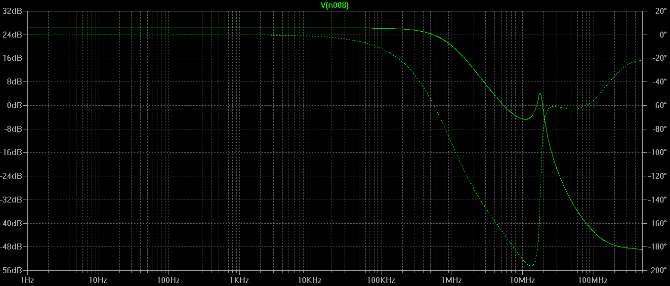

I have been doing many, many simulations yesterday and today, and I think I have discovered a big piece of the answer.
First and foremost, I have some egg on my face.
My amplifier, as originally published and simulated, had virtually none of the problem we are talking about here.
BUT, that work was done before I came up with my set of Cordell Models. To make a long story short, the absence of the problem in my simulation was faulty INDUSTRY models! Yes, isn't that ironic. When I re-did the sims of that amp with my own published models the peaking showed up; not as bad as yours, but noticeably there.
When I changed the models, I was desperately looking for anything that could be hiding the problem and causing the differences between our results. I replaced transistor models one at a time, starting from the input, then simulating closed loop response, which was a good indicator of this local instability. The MJE243/244 were the bad guys. I do now recall that the OnSemi models for them were particularly bad when I was doing my own models.
It is interesting, however, that this instability would be influenced to such a degree by the model of the center EF in a Triple. Moreover, even with my good 243/244 models, the degree of instability is greatly reduced by the presence of the output R-C Zobel network (8 ohms in series with 0.05uF).
This instability phenomenon is quite sensitive to the impedance in the VAS collector circuit. In my circuit with my models, adding only 50pFto ground at that node reduces the peak from 6dB (at 36MHz) to a flat shoulder (no Zobel in place). This is happily less than the 200 or so pF you mentioned as necessary.
Even without the cascode, there is slight evidence of this instability, by the way. The lower output impedance of the non-cascoded VAS appears to be at least partly responsible for mitigating the instability.
Although I have not completed all of the simulations, it also appears that the Darlington cascode has little if any such instability when it is driving the heavier load of an output double, as compared to a Triple.
So to some extent, some of this instability may be attributable to a confluence of the cascode and the much lighter loading of the Triple (but, as mentioned above, even the Triple still allows mitigating influences in the output chain to have an effect).
Adding a 50pF load to the VAS is not the only cure. It turns out that adding a 100pF load to the output of the IPS current mirror also does the trick. My definition of doing the trick is to reduce the peak to less than 2dB.
Finally, and perhaps most interesting, is the following solution. Put a 100-ohm resistor in series from the emitter of the VAS EF to the base of the main VAS transistor AND connect a 10pF capacitor from the collector of the VAS cascode to the base of the main VAS transistor. This allows some bypass of high-frequency feedback directly to the base of the main VAS transistor. This scheme is nice because it introduces very little additional loading on the VAS output node.
A 100pF from base to emitter of the EF preceding the VAS transistor also mitigates the problem, but a bit less effectively.
There is probably more to this saga, but that is pretty much all for now.
The good news remains that this instability is visible in the closed loop response. This underlines the importance of observing the closed-loop frequency response of the amplifier out to 100MHz or so (without an input filter!).
A cautionary note is that some of this sort of thing might be possible even without the cascode, when an EF-VAS is used with a Triple output stage. Indeed, there is even a chance that some of what is going on here is partly playing a role in some instability that has been attributed to Triple output stages in some situations.
This may be linked to my preference for putting a series R-C (e.g., 100pF and 100 ohms) from the VAS node to ground even in designs where I am not using a cascoded VAS.
There still may be some interactions between the Triple and the Darlington cascode that go beyond simple loading of the VAS node.
Anyway, this has been an interesting journey, and I have learned from it.
Bob

Shunting the TIS emitter resistor capacitively works because, contrary to Cherry, that resistor only increases the tendency to instability in the minor loop.
The capacitor introduces a zero in the minor loop transmission before unity gain, and merely demonstrates that Cherry was wrong to recommend the inclusion of this resistor as a stability enhancer.
