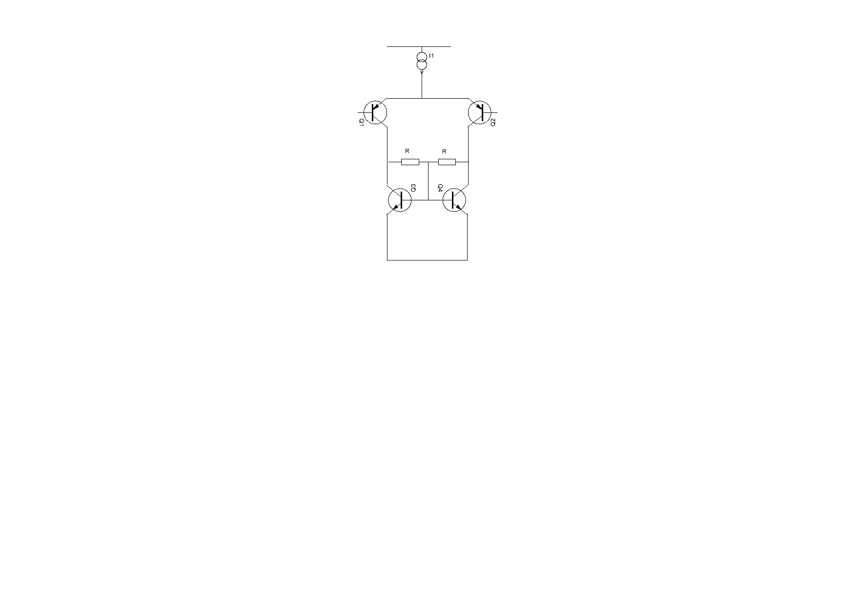

Differential current mirror?
The differential current mirror shown on p. 146 of the book seems a clever idea.
A quick Internet search did not turn up much, does any one have an analysis or references, or was it invented by Bob himself?
David

The topology is surely well known in IC design, although I can't say which opamp used this first. The name is somewhat misleading, as this is not actually a current mirror. A current mirror has a current input (low Z) and a current output (high Z), and the currents are modulated by the signal. Here there are just two outputs--with common-mode feedback, but no differential signal modulation. Perhaps "active load with common-mode feedback" is more accurate.

Hi Dave,
I first used it in my MOSFET Power Amplifier with Error Correction in 1983. I designed it myself, but that doesn't mean that someone else did not do the same thing or something similar before. If they did, I just was not aware of it.
The semantics of the term differential current mirror may be questoned, but I came up with the term as a derivative of what I consider to be the ordinary (single-ended) current mirror load that we are all familiar with in the input stages of power amplifiers, where it acts as a load for one side of the LTP and its output is connected to feed the net current to the input base of the VAS. This circuit does essentially the same thing, but differentially from both sides.
If it was used in op amps in the 70's or early 80's, you might be able to find it in a patent search, since such stuff was regularly patented back then. Even the Widlar current mirror was patented way back when, even though once one sees it, it looks pretty obvious. However, searching for it might require the use of numerous different semantics to find it.
Calling it something like a differential current source load with common mode feedback is certainly accurate as well.
Best,
Bob

... Perhaps "active load with common-mode feedback" is more accurate.
Even the Widlar current mirror was patented way back...once one sees it, it looks pretty obvious.
That's what makes a circuit brilliantly simple rather than just simple! I would be more proud of a circuit that looks obvious after you have seen it, but that nobody did see, than any other. I hope my current idea turns out like that.
Both your and Samuel's phrases are helpful descriptions of different aspects so it is a pity that multiple different terms makes searches tedious. That was part of the reason I enquired here - in case there was another term I missed.
Thank you both for your replies. I will study the patents that Samuel referenced.
I have some questions on LTP to VAS connections that may also be in your respective areas, but I started a new thread for simplicity.
Best wishes
David

I have a few comments/questions about this topology.
This is a fully differential amplifier.
To accomplish this two equal loads are placed in the two collectors of the input differential amplifier, the ouput beeing take differentially.
To have enough gain, these two loads should have very high resistance.
In IC design this is done by putting two identical current sources one in each collector. But now we have a biasing problem the current source of the differentail amplifier and the two loading currents sources are both establishing the bias which is not possible.
The trick is to create a signal equal to the common mode and to feed it back to control one of the bias source, in this way there is only one bias controling element. One simple way to do this is to use two identical resistors as in the fig attached. The mid point of the two resistors cancels the differential signal and is proportional to the common mode voltage. This is applied to the bias voltage of the two current sources.
But now we have a voltage gain equal to gm ro R where ro is the output impedance of the loading current sources, the resistor should again be high. In IC technology the resistors are limited. A way to increase them is to insert an emitter follower before each resistors and this is the topology found in the book.
The question I have is : In discrete design we can use very high value resistors. Should we not have essentially the same performance by simply putting two equal and high resistors either as in the figure or simply in each collector.
JPV
