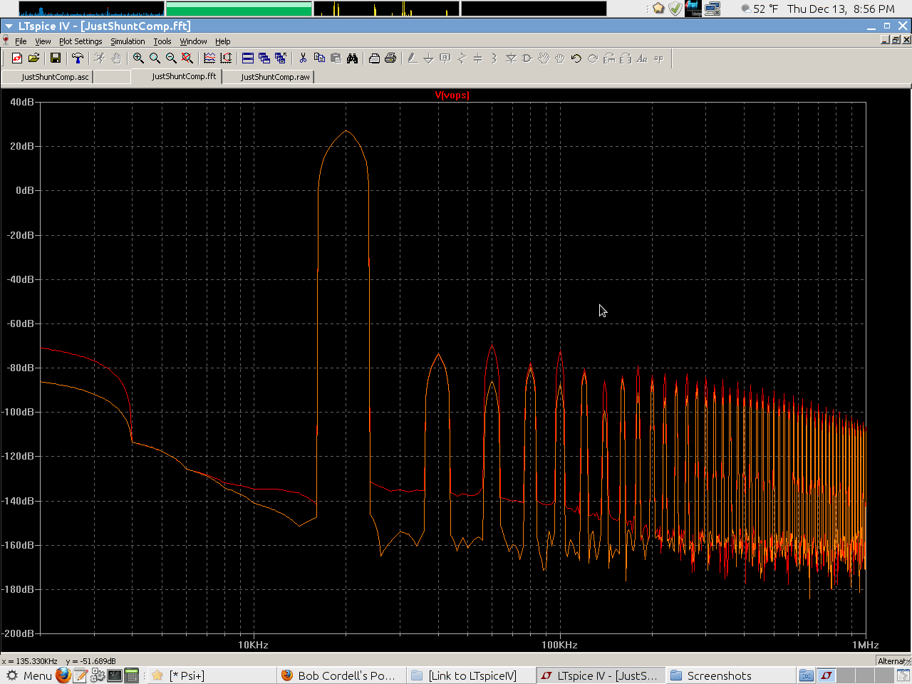

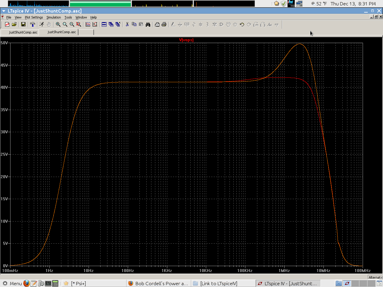

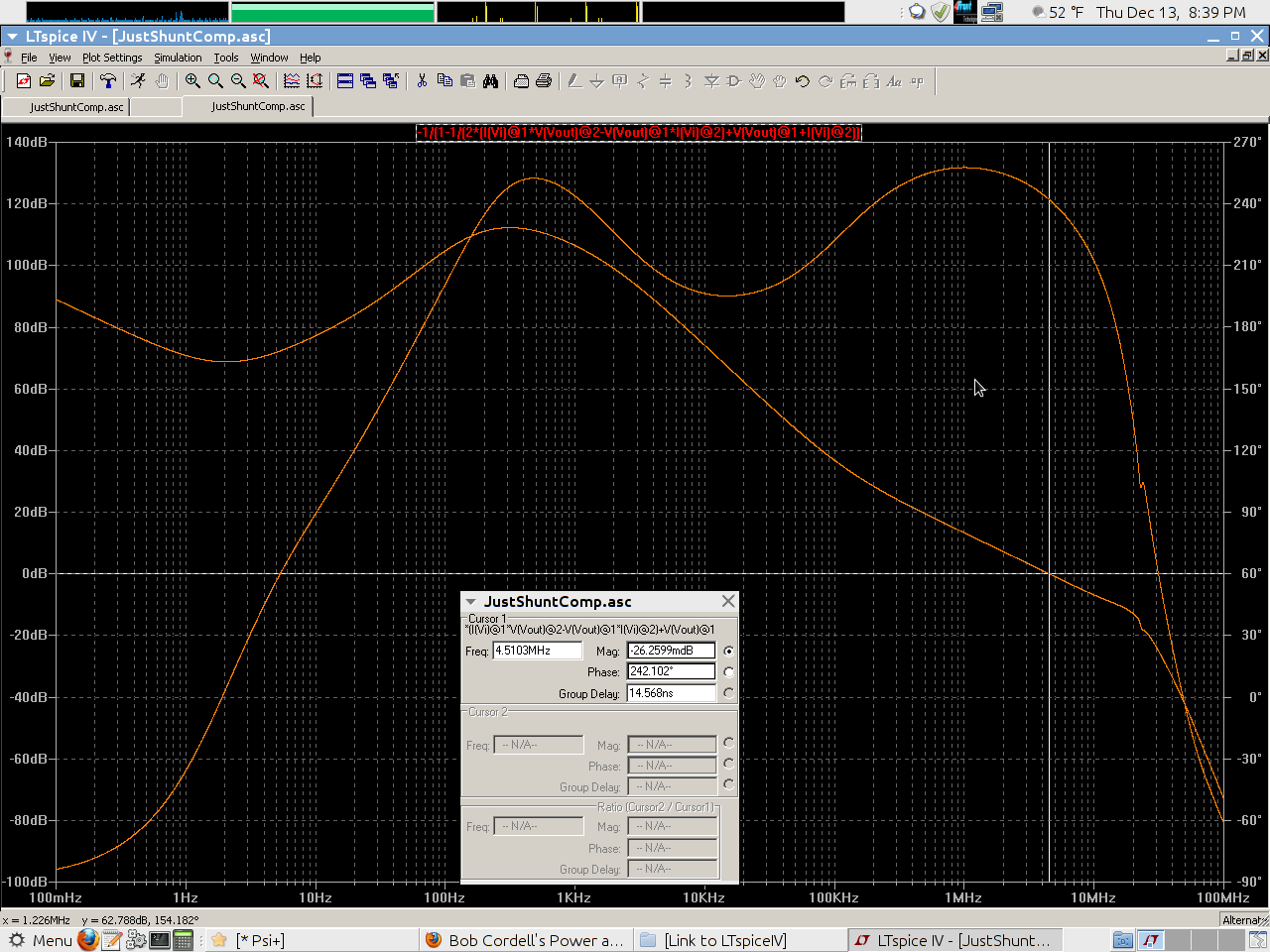

I think you mean gain margin. I have to admit I don't find myself needing OLG graphs much. I can look at differential output current and output impedance and that tells me most of what I need to know. Whenever I've checked gain margin with OLG it was good enough.
There is some overshoot with this type of compensation. Overshoot increases with a smaller capacitor, and you don't necessarily need the smaller capacitor for lower audio distortion. In my latest schematic I increased the cap from 560pF to 10nF, reducing overshoot to 1% and THD changed only by about 4db. I was surprised. So it seems this circuit's limitation at the moment is not the compensation.
Here are AC response, OLG and FFT plots from a "generic-kean" amp I threw together in the simulator. FFT is taken at 33V into 6R (90W). The circuit is a generic Blameless with 3 tricks, one of which is the shunt compensation. It seems my compensation techniques confuse the OLG probe, so there is a phase offset. I built my last amp which used this compensation scheme and aforementioned tricks, so I know it works.
The red trace is with compensation set to 2.5% overshoot, the orange trace is for 20% overshoot.
