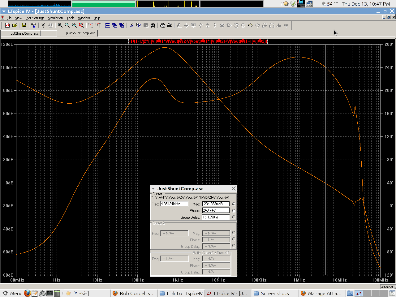

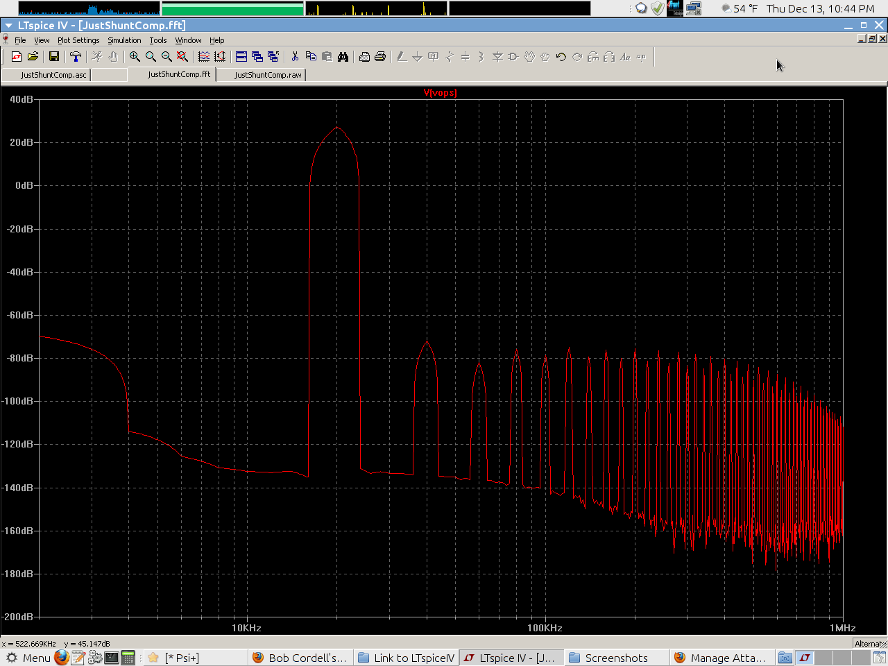

Oops, in the previous post I got the orange and red traces confused.
And here is the FFT and OLG plots for with TPC set at 2.5% overshoot. There is practically no difference in THD; shunt compensation has 3db less (I improved the compensation slightly since the last post). So much for local feedback. And this is with a buffered CE TIS.

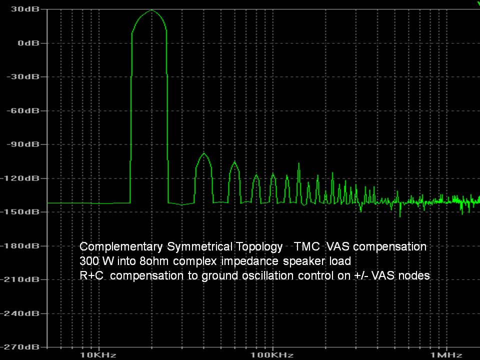

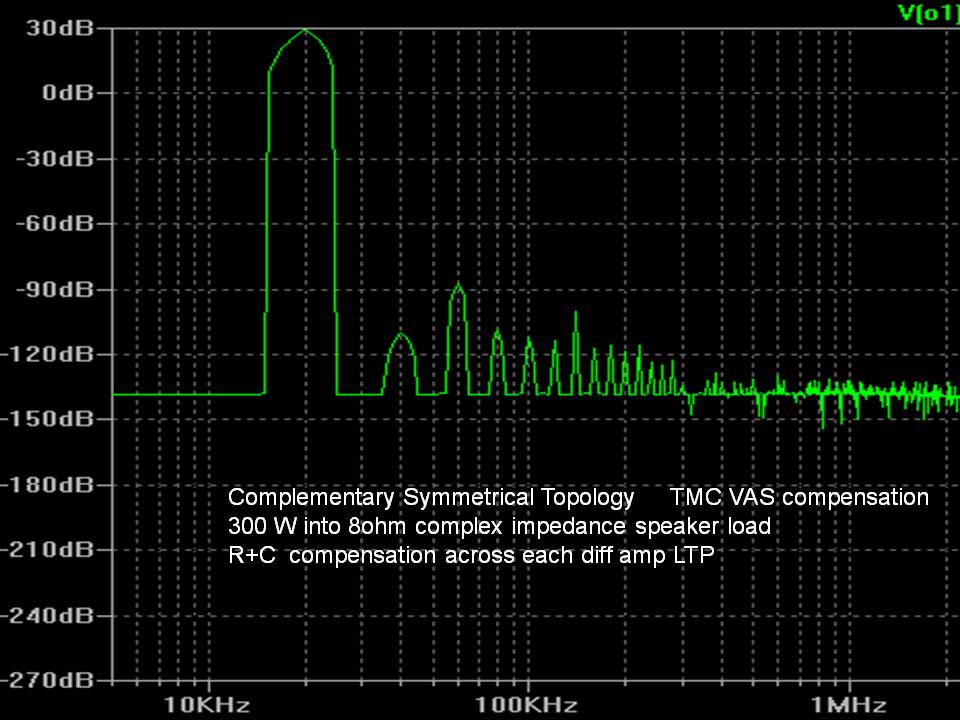

Example complementary differential amp design uses current mirrors, Hawksford VAS with TMC compensation, and triple-T output. LTSpice THD for 300W @8ohms is under 1ppm.
The first attached FFT uses a R+C across each input LTP to control high frequency oscillation. Note that the 2nd harmonic distortion is lower than the 3rd harmonic.
This complementary differential amplifier simulates with lower THD when, instead of the LTP compensation, an R+C is connected to each VAS collector and ground to control high frequency oscillation. On the second attached FFT, note that the second harmonic is larger than the third harmonic. No noise source is added to ground.

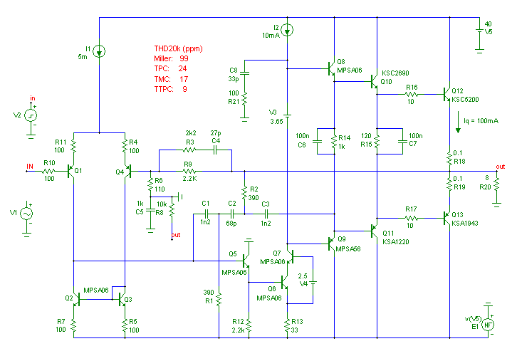

In my experience, there is something wrong with Edmund's implementation here:
http://www.diyaudio.com/forums/soli...terview-negative-feedback-64.html#post2370317
C1 and R1 form a shunt compensation across the TIS input. Miller and shunt compensation together is a bad thing because shunt compensation lowers TIS input impedance. The VAS degeneration makes this much worse. I calculate that with the 1.2n/390R shunt the VAS has a current gain of no more than 10 above 580KHz! You are using shunt and miller compensation together and ultimately losing part of the benefit of TTPMC because the shunt compensation emulates TPSC without the extra pole.
The bottom of R1 should go to the emitter of Q5. At Q6 or Q7 emitters it will cause positive feedback. In any case the shunt effect across R1 will be decreased by about a factor of 10, so TIS virtual input impedance will increase by this factor as well. I think this will make TTPMC much more effective (crossing my fingers). Putting R12 across the BE of Q6 will also increase VAS gain and linearity.
It seems that one can use TTPMC and cancel all the poles using the feedback network, but it's slow and tedious and I get a phase margin of 39 degrees! I think I can probably get a better stability margin by reducing BW.
