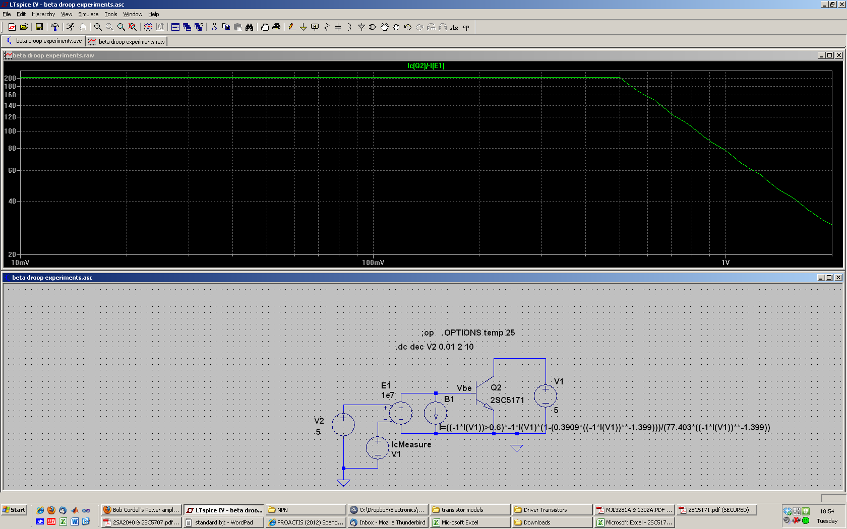

As mentioned earlier, I am working on some transistor spice models. I have posted my efforts thus far in this thread, so please head on over there if interested.
One thing I'll say here is that for the single model I've built so far (for the 2SC5707) I had difficulty getting hFE vs Ic and fT vs Ic to match spice vs measured/datasheet. The hFE vs Ic "curve" is extremely flat up until about 3 amps, where it drops very suddenly; this seems to be impossible to match in spice.
For the fT curve, fT "holds up" well until 2 A Ic, when it drops very suddenly, again this seems impossible to model in spice. For fT at low Ic, I couldn't get this to match without upsetting the (currently perfect) match between model and measured for Ceb vs Veb.
If anyone has any advice on how these two things can be fixed/improved, that would be much appreciated.

Hi Harry,
I experienced the same difficulties when I created the SPICE models for the transistors on my web page, based on the approach that I came up with in my book. I believe a big part of the answer is that the SPICE model does not adequately reflect a good fit to some of these transistor behaviors at high current, and sometimes at low current for ft. A compromize is necessary when trying to match some of the steeper roll-offs of beta at high current for example. There are some tricky tradeoffs among the available parameters. Let me know if you think, based on your experiences in this adventure, if I could do a better job on this sort of thing in my chapter on making transistor models.
For modeling ft at low current, the Cje paraters are quite important, as you know, and yet any direct measurement of Cje under the conditions of forward bias required to operate the transistor can be very difficult.
The one thing I can say with some confidence is that carefully making your own models, making wise compromizes on the match to datasheets or lab-measured performance, will usually yield far better models than those available from many manufacturers. Many are jaw-droppingly bad.
Another very important thing to bear in mind in laboratory measurements on real devices is the effect of junction heating, especially at medium to high collector currents. The temperature dependence of beta can really throw off the measurement of Early effect, for example, often yielding a lower Early voltage than is really the case (if you are looking at Ic vs Vce, as you increase Vce the dissipation goes up). The fairly fast thermal time constant of the transistor die exacerbates this difficulty. On some transistors, when I look at the datasheet curves if Ic vs. Vce, I occasionally wonder if even the factory test/characterization might not have been using a short enough pulse to make the measurement, if they did it with a pulsed DC measurement. Inferring Early voltage from AC measurements can yield better results if done carefully.
Bob

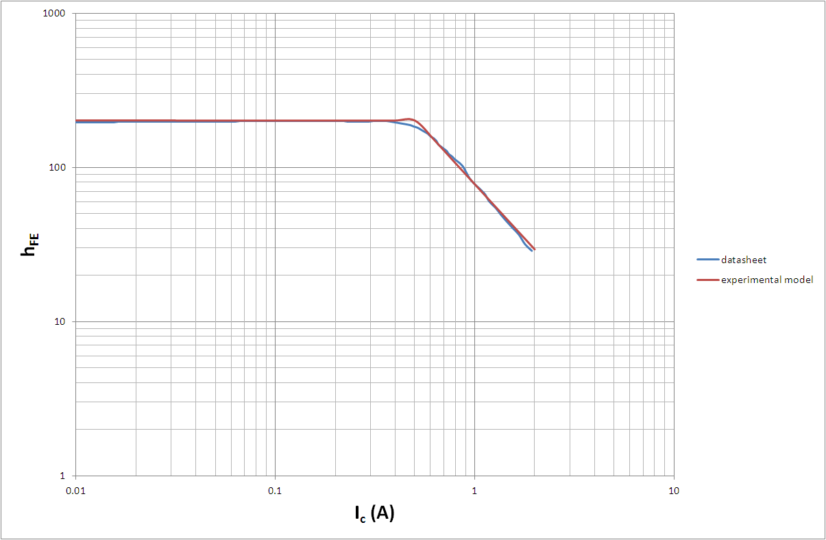

Bob, an update:
I have "completed" my models for the following:
2SC5171
2SA1930
D44H11
D45H11
The models and some other stuff are available in this zip file; the zip includes Excel files which graph measured/datasheet values and those achieved by the Spice models.
I have come to the conclusion that transistors that have a very flat beta vs Ic over a few decades of Ic and then a sudden drop cannot be modelled by a "normal" Spice model. My compromise is to keep beta pretty flat and bear in mind when simulating that beta at high Ic will be overly optimistic in the Spice model. It's possible to get a "better" fit (read: lower rms error over the Ic current range) of beta vs. Ic, by allowing some curvature in the characteristic at low Ic, and making "aggressive" use of the parameter "NK" (not mentioned in your book and not documented in LTspice). However, this leads to greater error in beta at low currents where the real device is flat vs Ic, and also to significant errors in the Ic vs Vbe curve at higher currents. The error in the latter curve can be reduced by using the RBM and IRB parameters, but can't be anywhere close to eliminated because the way RB is varied by RBM/IRB doesn't map well to how beta is being varied by IKF and NK.
By the way, even for transistors with more "gentle" beta vs Ic variation, the NK parameter is still necessary for a good fit. I think you need to investigate this and include details in your second edition.

Hi Harry,
This is great work, and I appreciate your suggestions for future versions of my book. Regarding ft droop and beta droop, I FEEL YOUR PAIN!
During the writing of my book I spent many late nights in the lab measuring transistors, gleaning data from datasheets, cursing manufacturers and tweaking SPICE parameters to get a decent fit.
Andy Connors was my inspiration for doing the book chapter on transistor modeling. More than anyone else, he showed how bad many of the commercial models are and how to create better models, even in your garage, if you understood SPICE and had patience.
Andy was especially helpful in leading me in the understanding and creation of EKV models for power MOSFETs.
Andy C is truly missed on this forum. I should note that I am deeply indepted to Andy for another reason: he proof-read my whole book.
