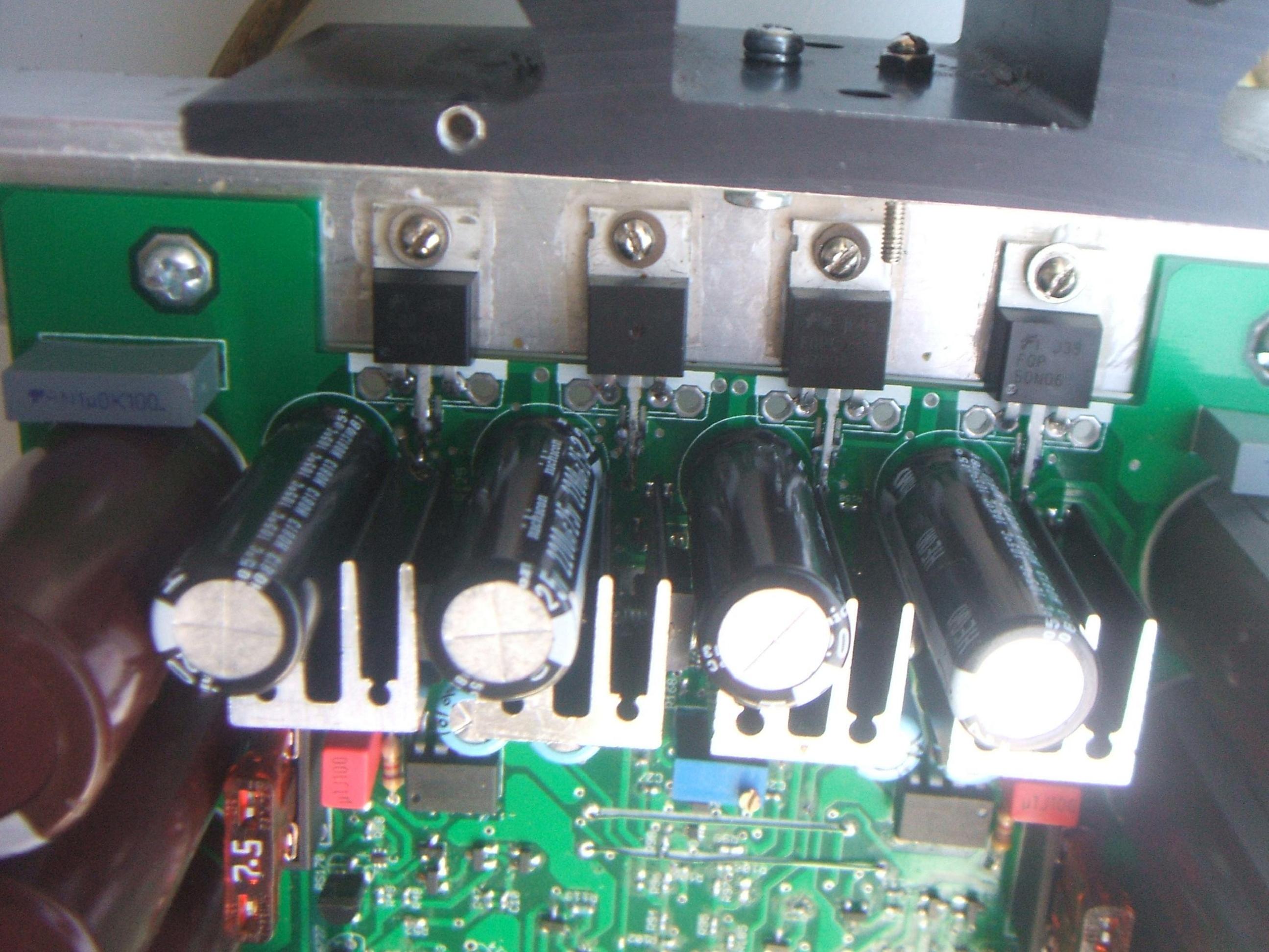

I find that since the bias for vertical mosfets is usually >150mA, allowing the system to be a bit overcompensating can buy a bit of extra stability with regard to dynamic tempco. Although the effect is small, the fets get a boost in Gm at a higher temperature.:dodgy: If the effect of overcompensation is slight, the bias can be kept within acceptable range, >100mA at maximum temperatures. Consequently, initial static bias may be a bit higher but since the devices and heatsink are cold it is of slight issue. I have had success in stablizing bias of vertical mosfets using a topology similar to the HEC Bob used, but I use small SMD devices as the error amplifiers, mounted on the PCB so as to be in contact with the drain pin close to the transistor package. Although there is a short distance of metal for the heat to traverse, it is not so effected by the time lag of the thermal insulator/heatsink. see pic from previous learning experience.🙂
