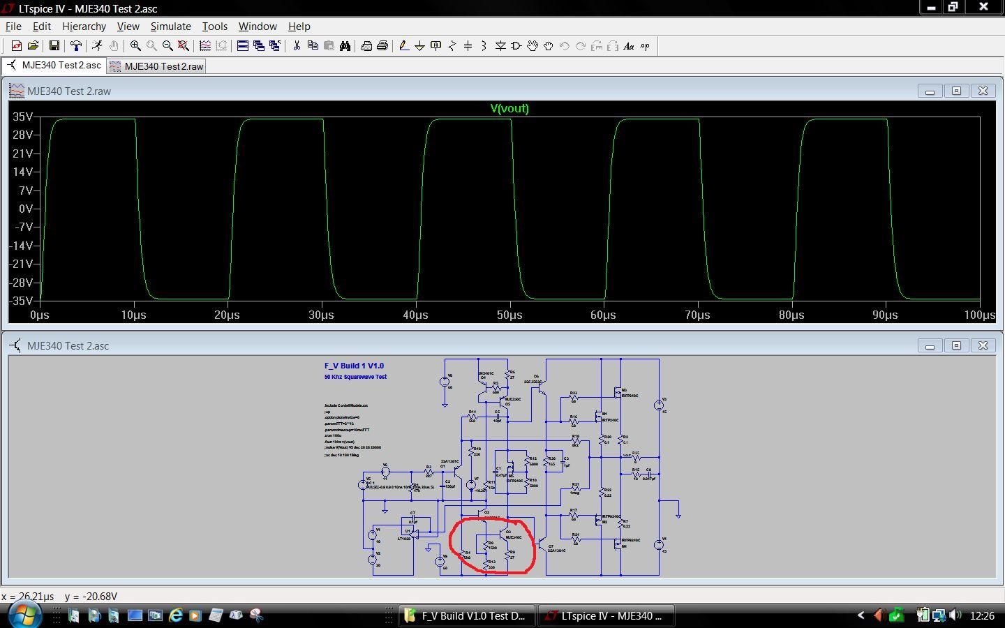

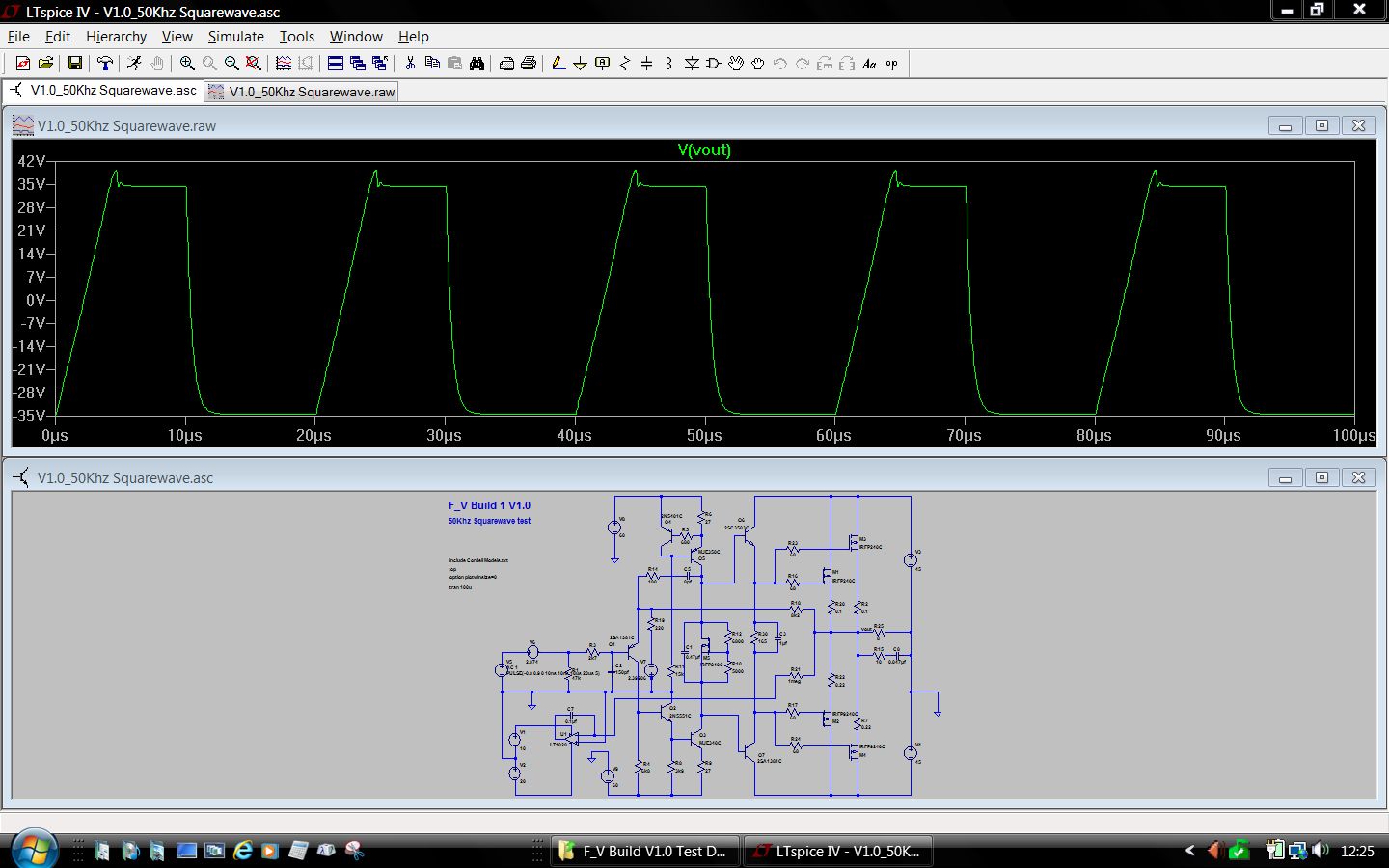

So I have a design in simulation that gives spectacularly bad results on slew rate (50Khz squarewave test) when using the MJE340C model as a VAS. It's that slow you would need to send it a postcard with advance warning a voltage change was coming. However if I swap it for pretty much anything else the results are more in line with what I might have expected. The VAS current is highish by design at around 25ma.

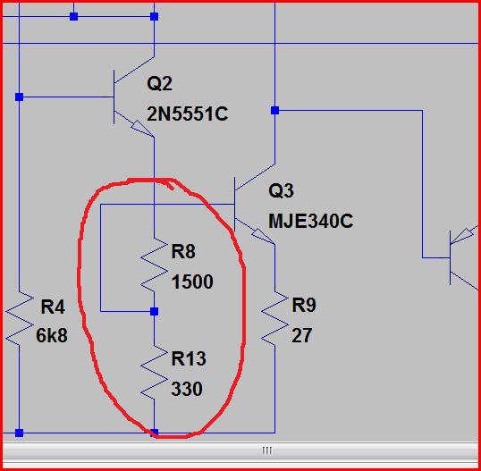

If I modify the drive to the VAS as shown in red then it works OK although at the expense of other aspects of the design suffering.
What parameter/s of the transistor model might be causing this slew limiting effect ? and do you think this a real effect if it were built for real using an MJE340. Your 2SC3503C model on the other hand gives a very good result in simulation.

Mooly have a look at CJE and CJC. Its real.

It appears the base feed into the 340 does not like the 3k9 as source resistance.
Changing that to 330r sorts the RC slew limiter.
But, why run the preceding EF with an Ie~0.15mA. simply reducing the 3k9 emitter resistor to somewhere between 99r and 1001r would be more sensible.

Thanks homemodder, that's spot on.
I just tried adding a little junction capacitance to the 2SC3503 and that's it.
Couldn't see it for looking 🙂
It's me Andrew... mental block. I couldn't believe the MJE340 would be so "bad" (not the right word but you know what I mean) in real life and I couldn't work away from that thought.
