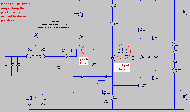

estuart said:
Hi Mike,
One of the two:
1. global (major) feedback loop and erroneous results. In this case the top your R10 (my R1) should be be connected directly to the output, instead of tied behind (left) to the loop probe.
or:
2. correct results, but targeted at a different loop, but then, what kind of loop, inner, Miller?
Please, explain (and check if we are looking at same diagram).
btw I couldn't see any load resistor (8Ohm), why?
Cheers, I'll be back in 1 hour.
Connection of probe between resistor and output:
To determine the sum of major loop and minor loop contributions with respect to the output stage; i.e. establish the total loop gain enjoyed by the output stage.
Just how and why would you expect an 8ohm resistor to affect your loop gain response?🙄
mikeks said:
Hi Mike,
Maybe I overlooked a third possibility, that is, we fully agree 🙂
however...... the picture below might put things in a different light.
Please, have a look.

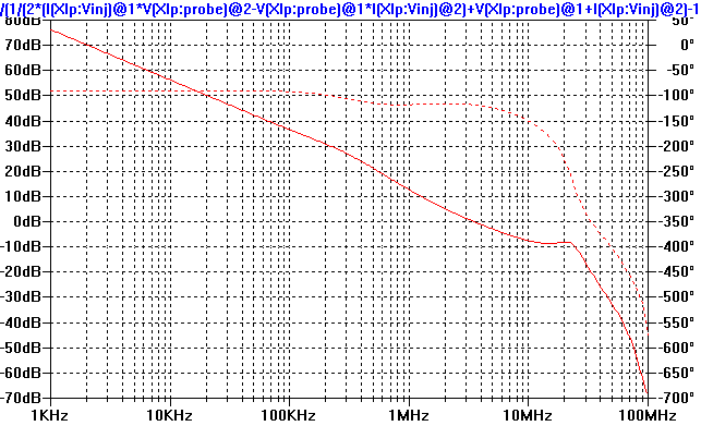

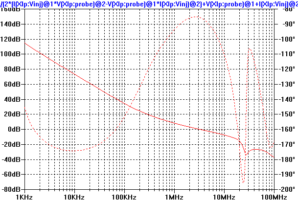

Mike, when you have the loop gain probe right after the output stage in that configuration, I'm not so sure it has the physical interpretation you're assuming it does. I tried the two-pole comp with a third capacitor and added resistor. Here is a plot of the overall loop gain of the amplifier. Notice that at 20 kHz, it is 60 dB.
Now I move the loop gain probe so it's right at the output of the output stage, before the resistive pickoff that goes back to the VAS. This mod gave me a distortion improvement at 20 kHz of over 2x. Notice in this plot that the loop gain is 50 dB at 20 kHz. Less than the global loop gain? I don't know what this means.
This is the same circuit in both cases, just different loop gain probe positions.
Hi Mike.
With respect to the major loop, not that much, but as a careful man, I always include the output load.
Concerning the inner loop, there are numerous subtleties, including output loading, that should not be overlooked. For example, a small emitter series resistor in the VAS stage, not shown in your diagram btw, could have decisive effect on stability. See a paper of E.M. Cherry on this subject (lots of matrix algebra, as usual :-( ).

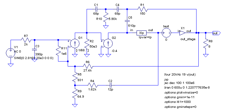

ROFL! Here's how I go about designing the thing.
Suppose you have an amp that you've determined, via single-pole comp, can have a unity loop gain frequency of 2 MHz. Of course, for single-pole comp, you'll have a loop gain of 40 dB at 20 kHz. The two-pole comp network has zero on the negative real axis. Let's put that zero at 1/10 the unity loop gain frequency. That means it will degrade the phase margin by 6 degrees (phase lag = -96 degrees at 10x the freq of the zero). A little lead comp can take care of that. In fact, Edmond's trick applied to the two-pole comp allows for just that. So now we have the open-loop zero at 200 kHz. The idealized Bode plot will have 20 dB loop gain here. Below this freq, we'll have 40 dB/dec slope. So at 20 kHz, we'll have 20 dB + 1 dec *40 dB/dec or 60 dB at 20 kHz (like my plots above). Of course, above 200 kHz the two-pole comp is no better than the single-pole. But for 19+20 kHz IM, I would think the two-pole comp would have a 20 dB advantage.
andy_c said:
I saw that but it used a bunch of Zetex models that you apparently put into your standard.bjt. I was too lazy to round them all up 🙂.
Your circuit is different from mine. Mine indicates all loops are stable. Here is the network.
Hi Andy,
With your arrangement The major loop will be double pole while that part of the minor loop enclosing the output stage will have a triple pole roll-off. 😱
