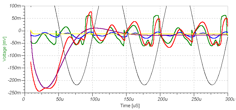

I am not trying to make any statements with these circuits.
See class-A//AB with more coherent NFB - blue traces
Class-AB without choke or Miller C.dom - fuschia traces
Class-AB with choke and Miller C.dom - black traces
Class-AB without choke, with C.dom - lime traces.
Comparing error due to 10kHz back-EMF sine
Also swept amplitude and phase of error.
Of course all these are simulated, and real life output impedances can never be so low, but this gives an idea of how an output terminal behaves when back-EMF becomes momentarily leading wrt amplifier input.
( Not allowed to attach my test circuit file ! Its a 38kB GIF but over 1000 because it shows 4 circuits. PAH! )
So just attaching the output traces, all made by reverse energising the output terminals via 8 ohm resistors.
The first charts output terminal voltage with 1Vpk sine energisation *starting* at 0V: the second the amplitude and phase of output terminal responses (closed loop) due to sine energisation via 8 ohm output load.

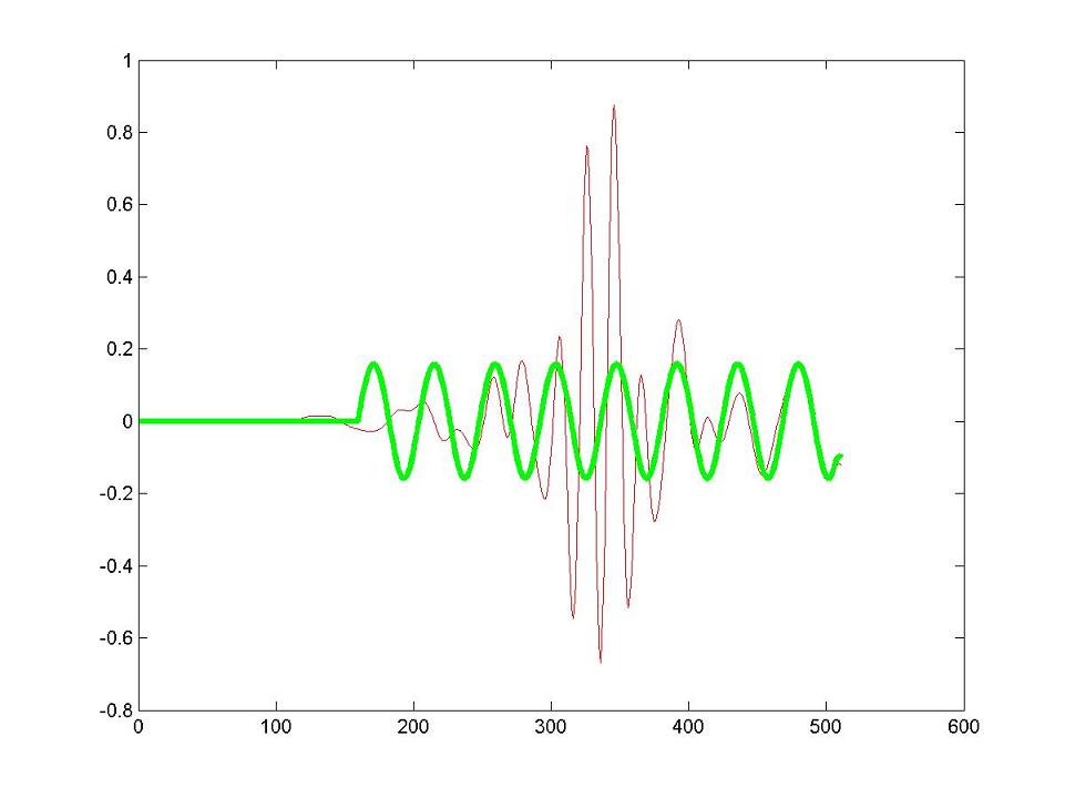

We went through this before. You are deliberately using an input signal that is unrealistic (the sine suddenly starts at the max value). If you use an input lpf with a cutt-off freq of say 30 or 40kHz, this effect disappears.
Also I would like to know what that feedback delay value is that ostensibly gives the effects you mention. With band-limited audio signals, not with some some unrealistic ultrasonic input signal.

Well, if that is so, let's see it. This type of process works into the 10's of MHz, so if there is a delay problem, why does it mess up things below 20kHz? If the feedback process can almost nullify 20kHz distortion because the subtract-and-correct works fast enough to take care of harmonics up to 40 or 50kHz, why does it then have a problem with a slow mechanical speaker delaying something many milliseconds? Why it is that you and Graham don't get into this and clear it up for once and for all?
I'm not saying it is impossible, I'm trying to get my head around it but have very little to go on except anecdotal stories.
I've more often tried to reason out things that were thrown up off-hand, only to be accused of having an attitude by those who don't like my reasoning. I think I'll survive yet another case.

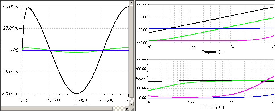

Hi Bob and Nelson,
Re Douglas' Patent. I surmise he advanced upon earlier designs by claiming novelty for an *active* voltage controlled current source which he uses to displace the class-AB crossover beyond the range of loudspeaker generated back-EMF, such that his 'XD' amplifiers run in class-A at normal listening levels.
Re back-EMF induced distortion, see the attached illustration from my 2004 EW article.
This shows class-AB amplifier output simulations of a generic type similar to 'Blameless'
All outputs are 15V sine, with each trace *fundamental nulled* to examine individual distortion residuals.
The black trace illustrates the -40dB level of the Blue output.
Blue with choke and Miller C.dom into R load
Red with choke and Miller into 'Ariel' equivalent.
Mauve with choke but no Miller C.dom into Ariel
Green no choke but with Miller C.dom into Ariel
Yellow no choke and no Miller C.dom into Ariel (same architecture)
Yellow circuit not constructed, so might not be stable.
Those who state it is wrong to study how an amplifier responds to a suddenly starting wave, may follow the repeated error residuals from 150uS onwards.
Note that individual amplifier component variations overlaid upon the same semiconductor layout have an influence upon group delay, and thus crossover timing within each voltage output waveform.
Note how 'loudspeaker' loading exacerbates emitter follower output stage crossover distortion when a Miller C.dom is used at the VAS within a closed NFB loop.
I agree. This kind of signal shows time response of the system, though the system can be perfectly linear. Every sudden change, even if it is straight line of zero level suddenly changed to sine starting at zero, not maximum, needs infinite bandwith to be transferred without linear distortion. It is all about understanding of linear and non-linear distortions and time response to any signal.
