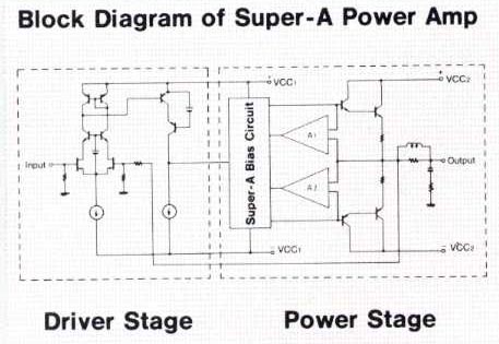

Hey guys, don't go away.....🙂
Here some swell schematics of the JVC "Super A" amplifiers
circa 1977.
