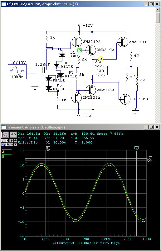

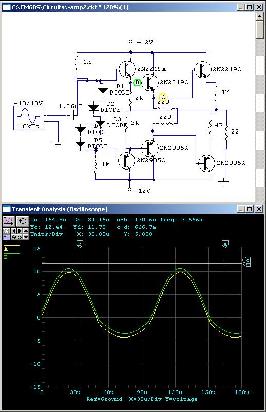

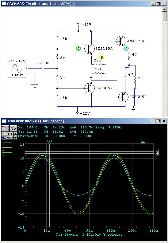

Actually, you haven't; doesn't even look remotely like locanthi's circuit
Try again; use this circuit.

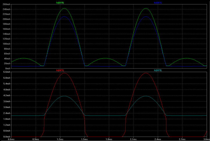

Re: Superbly intuitive analysis!
Finally, proof of the exceedingly good pudding...(4ohm load assumed)
The top plot shows Q7's collector current (green trace) with respect to this arrangement.
The navy trace represents Q7's collector current wth Q5/Q6 cross-coupled.
Similarly, the bottom plot shows Q5's collector current (red trace) with this arrangement.
The sky blue trace represents Q5's collector current wth Q5/Q6 cross-coupled.
Note that in both arrangements Q7/Q8 will operate in class A only if the output stage is at least biased in ''optimal'' class B.
