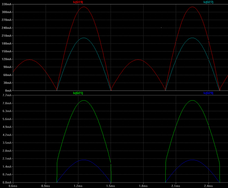

Actually, i have now found this not to be entirely true:
Whether Q7/Q8 operate in Class A is also a function of the size of the cross-coupling resistor, the magnitude of the load and is dependent on the entire output stage not being under-biased.
This, to a much lesser extent, is also true of the first pair of cross-coupled drivers in Locanthi's arrangement.
It does not depend on is the output stage under-biased, or is not. The point is, no matter how linear is the current cunsumption by output stage from driver, if it is less than idle current through the driver, it is in A class. It is just a definition of A class, more semantic matter than electronic.
You don't really believe any part of the output stage will operate in class A with zero bias, do you?
Proof below:
Bias=1V (underbiased by ~1.7V)
Driving 2ohms.
Green Trace: Q5 collector current.
Red Trace: Q7 collector current.
Blue Trace: Q5 collector current (Locanthi).
Sky Blue Trace: Q7 collector current (Locanthi).
Notice that all the drivers here, regardless of cross-coupling or lack thereof, are now operating in Class B or AB.

It would perhaps be better to ascertain the definition of ''push-pull Class A'' before committing oneself; this information is readily available on the Web.
Wavebourn said:It is just a definition of A class, more semantic matter than electronic.
