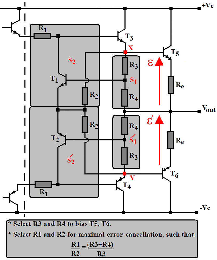

Bob Cordell said:But notice, as the signal at the junction of R13 and R14 goes negative, Q5 conducts more and its gm increases, but Q6 conducts less and its gm decreases. These two effects tend to oppose each other to first order. That is the differential amplifier-type action I was referring to.
I think you'll find that the difference in potential between the bases of T1 and T2 in Hawksford's arrangement remains virtually constant.
Bob Cordell said:However, the linearity behavior of the pair of Q5 and Q6 is still essentially like that of a differential pair.
The linearity is due to the heavy local feedback.
''Desensitizer'' continued.
By comparing Hawksford's implementation with the block diagram here it becomes apparent that Hawksford is in flagrant error, for merely connecting a bootstrap resistor from the output to the input of the output stage gives the opposite of the desired effect.
This is because the signal fed back from the output (with respect to the input) by the extra loop must degenerate the signal applied to the output stage (summer S4); the bootstrap resistor, on the other hand, is regenerative.
I have designed an active implementation, consistent with maximising K4's gain, the desirability of which has been amply demonstrated.
Although it entailed a significant increase in component-count, the circuit was found to considerably reduce sensitivity of the EC loop to component tolerances. 😎
Interested parties are incouraged to develop their own interpretations of the model.
That's true, but pumping current in and out of the joined emitters results in the complementary changes in gm that I was referring to.
Bob
mikeks said:
Yes, this is largely true. However, any small departures from linearity are the result of gm changes, and the fact that these gm changes are complementary in nature further improves the linearity.
Bob
