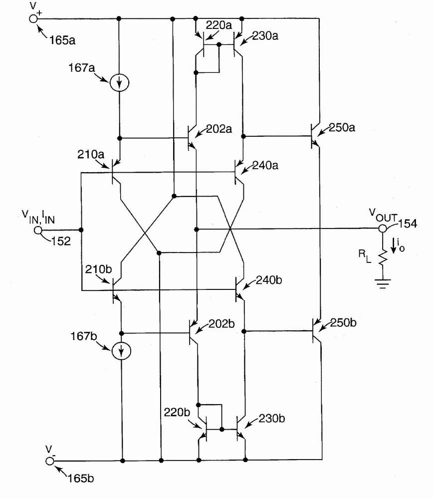

mikeks said:By comparing Hawksford's implementation with the block diagram here it becomes apparent that Hawksford is in flagrant error, for merely connecting a bootstrap resistor from the output to the input of the output stage gives the opposite of the desired effect.
This is because the signal fed back from the output (with respect to the input) by the extra loop must degenerate the signal applied to the output stage (summer S4); the bootstrap resistor, on the other hand, is regenerative.

mikeks said:Resistor Rs here.
I haven't been following the desensitizing discussion as closely as I should, but the role of Rs is intriguing. Let's assume that the whole EC output stage is fed from a low-impedance source, as might be the case with a VAS that has local Miller compensation feedback or some other form of local feedback. Indeed, for purposes here, assume it is fed by a voltage source. The impedance at the emitter of the emitter follower at the front end of the EC stage will then be just 1/gm of that transistor. It will be a pretty low value, but will fluctuate a bit with amount of error correction due to the changing collector current of the EC differencing transistor. This is where Rs is connected. Current flowing in Rs will act against the gm of the transistor to develop a voltage.
What is also interesting is that, if the EC is doing its job perfectly, there will be essentially no signal across Rs, since the output node will be perfectly tracking the input. I guess maybe the desensitizing issue comes into play when, indeed, the EC is not doing a perfect job, thus causing a signal to appear across Rs and thus causing a signal current to flow that is a reflection of the residual error.
It is a little less clear, in simple english, how the resulting current flow effects a further error reduction, thus desensitizing the circuit. Take the top half where we are driving the output positive. Let's say there is an error in that the output is not quite going as positive as it should (less than perfectly unity gain). That will cause a slight increase in the voltage across RS and thus in the current flowing in Rs. This in turn will cause a very slight drop in the voltage at the emitter of the input emitter follower. This would seem to be in the direction of decreasing the apparent voltage of the input signal, causing the output to perhaps drop a bit further. This would seem to be in the wrong direction of that desired. Did I get this right? Is this what the "flagrant violation" is?
Note also that DC current will flow in Rs, causing a further current flow in the emitter follower and consequent increase in its gm. Also, if other, perhaps relatively fixed, currents are drawn from this emitter follower (as in my circuit), its gm will be increased and the relative effect for a given value of Rs would seem to decrease.
Mike, am I on the right track here with this verbal explanation?

Hi lumanauw,
I see a diamond buffer that modulates a couple current mirrors that in turn seems to affect the input signal through the other transistors.
Am I missing something here, or did I get the gist of it? If anyone can lay it out for me I'd be greatful.
-Chris

Hi, Anatech,
Let's see the upper half only. The input signal is entering 2 transistor, 210a and 240a. The actual output diamond buffer is 240a.
210a and 202a is the "correcting loop". It senses input (base of 210a) and output (emitor of 202a). If there is any difference sensed, it modulates the CCS value that goes to base of 250a via current mirror of 220a+230a.
Hi lumanauw,
What I see is a diamond transistor created by 210a and 202a. The current through 202a is mirrored by 220a and 230a and possibly affects the input signal through 240a, also driving 250a and therefore 250b and coupled to 240b.
Round and round it goes. If you connected the emitters of 250a and 250b to the output signal output, it looks like a pair of diamond buffers with the second buffer (240, 250 pairs) modulated by the current drawn from the first one so that the second one is driven by current and voltage.
So what I'm saying is that 210a and 202a form the diamond trnasistor that modulates the other stuff.
I'm still lost on how it works for error correction. I feel like the answer is right there but I can't see it. Thanks Daniel.
-Chris
