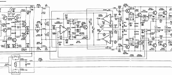

Re: Practical EC schematic
Denon POA-6600
Denon POA-2200
lumanauw said:Does anyone has other practical electronic schematic other than Hawksford/Cordell or NP-PMA schematic?
Is it EC schematic is only limited to this Hawksford EC?
Denon POA-6600
Denon POA-2200
