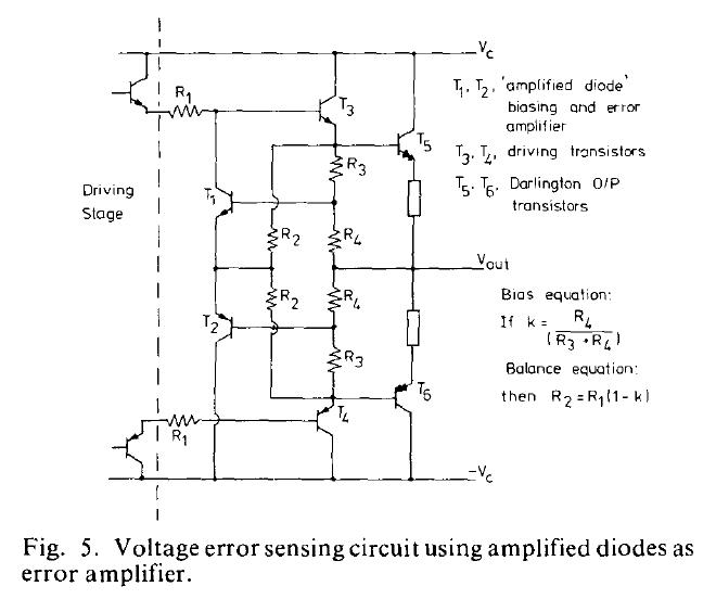

Andy C wrote:
Not sure which NFB path you're referring to.
There are three inputs to the "S1" summer, PFB from the gate driver via the 330 ohm resistors, NFB from the output via 270 ohms and NFB from the gate driver. The latter is not in Hawksford's original model although I see it is in his fig 5. I also notice that Bob has not implemented fig 5 because Hawksford has the collector of T2 going to the psu rail. What do you make of that?

traderbam said:
Jan wrote:Jan, would you show me your EC system that can easily null the error out of my non-linear gain device, A, where A(x) = x^2?
Brian,
Several people including me have discussed and shown the H.ec that can null the forward gain A from the cl equation. In theory, of course. Whatever A is. The only requirement (for the math) was that A is not equal to zero. Mikeks has shown several topologies. I have no ambition to repeat all that one more time.
Jan Didden

mikeks said:
Therefore, in respect of an output stage where it is desired that K=1, contrary to my previous submission, it follows from the above expression that: {loop_gain=epsilon in graphic}
Hey, I like that result. Clearly it could lead to some observations about how to get the best loop stability - like avoiding peaking in the frequency response of the output stage.
I think the high loop gain that traderbam is referring to is in the outer loop where the probe is placed just in front of the diff amp (in the path containing the output stage).
Hi Mike. That paper you posted on topological equivalences by Texas Instruments was great.
I would caution you to be careful because this rearrangement method only works with linear blocks. It does not work with non-linear elements as addition and subtraction do not work. So if your non-linear block is represented by K1 and S1, S2, K2 and K3 are all linear, you should leave K1 alone and manipulate everything else around it.
If you do this you should find the loop gain of your fig 1 is -K1.K2.K3/(1 - K2.K3)
Loop gain goes infinite when K2.K3=1 as expected.
I know this.
Where are these ''non-linear'' blocks? :scratch:
traderbam said:
So if your non-linear block is represented by K1 and S1, S2, K2 and K3 are all linear, you should leave K1 alone and manipulate everything else around it. If you do this you should find the loop gain of your fig 1 is -K1.K2.K3/(1 - K2.K3) Loop gain goes infinite when K2.K3=1 as expected.
This is wrong. I am really fatigued by all this, so finding out why you are wrong is your homework.:headbash:
Hint: K1 is error + ideal output stage gain.
