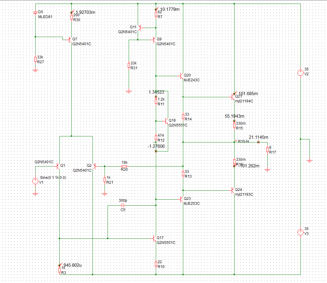

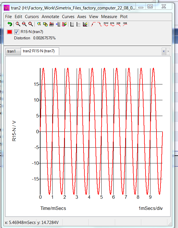

Simetrix 1kHz THD simulation difference sorted out
Hello Edmond
I determined the reason for the difference between my 1kHz THD figure done on Simetrix and those done on LTspice and MC9 and that was due to the models I used which I obtained from post 3850 supplied by Stinius his models are different to the ones used by Waly on post 3824. See the attached 2 files.
The THD figure is now 0.00267575% at 1KHz see attached plot. This now brings my results in line with LTspice and MC9 .
Stinius if you are reading this could you do your sims with the models in file marked Cordell Models_12_07_2010.txt .
Interestingly Bobs book sims (page 409-415) use older models and get worse THD performance. If you google "spice model mje243" you will get taken to Bobs book and on his web site the download "Spice Tutorial Examples.zip" example 19.7 uses the newer models with lower THD.
Regards
Arthur

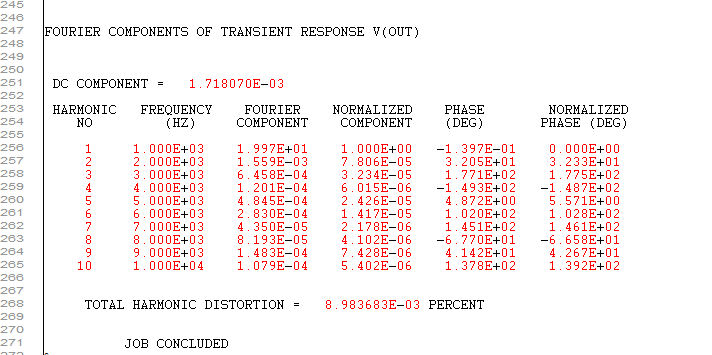

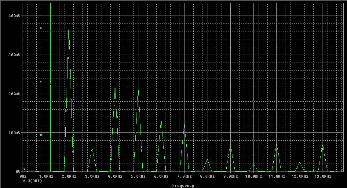

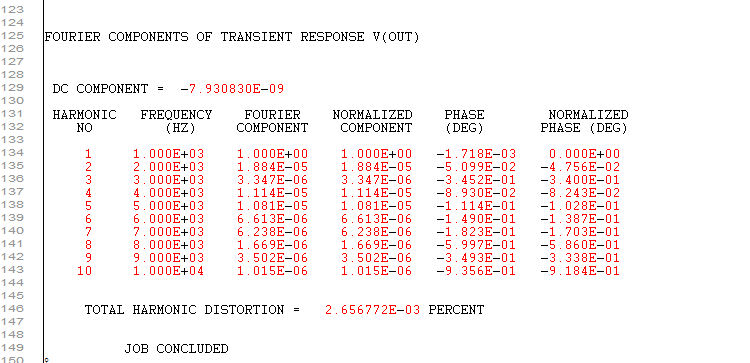

After some more experimenting (and some help from a guy who's name is no longer welcomed on this forum), here's how to persuade PSPICE to provide the same THD results as the other simulators.
Rather than going for absurdly low max time steps (I tried as low as 10mS/(2^17-1), which still provided 82ppm as mentioned here, keep the max time step to 1uS and adjust the "Print output values in the file every (...)" parameter to 10mS/(2^14-1)=0.61038881767686015992187023133736uS. 10mS is the entire simulation period, while only the last 5mS (5 periods) are used for Fourier analysis ("Start saving data after (...)" parameter). The results are attached (_refined_ files), THD is now 26.96ppm.
Using 0.61038881767686015992187023133736uS as a max time step doesn't deliver (see the attachments, _step_ files); the THD result is 89ppm, not better than in the post quoted above, using an extremely small max time step.
According to that name (apparently this is also buried somewhere in the PSPICE documentation):
Using the above setup, I also tried the 17.9 schematic with the PSPICE default models for the devices. These models are not labelled as ON/MODPEX (but Motorola @1999), and they delivered the same THD of 190ppm as in the initial Simetrix results.
Now that the simulators are aligned (configuration wise), so the results delivered by the internal math are consistent, the big (and much more difficult) question is: lacking the opportunity to directly check (through measurements), which models to trust?
I should also mention I have no tried myself to scale the simulation parameters at other frequencies (like for determining THD @20KHz).
The Fourier analysis must be supplied with specified output variables using evenly spaced time points. The time interval used is "Print output values in the file every (...)", or 1% of the final time value TSTOP (if smaller), and a 2nd-order polynomial interpolation is used to calculate the output value used in the integration.

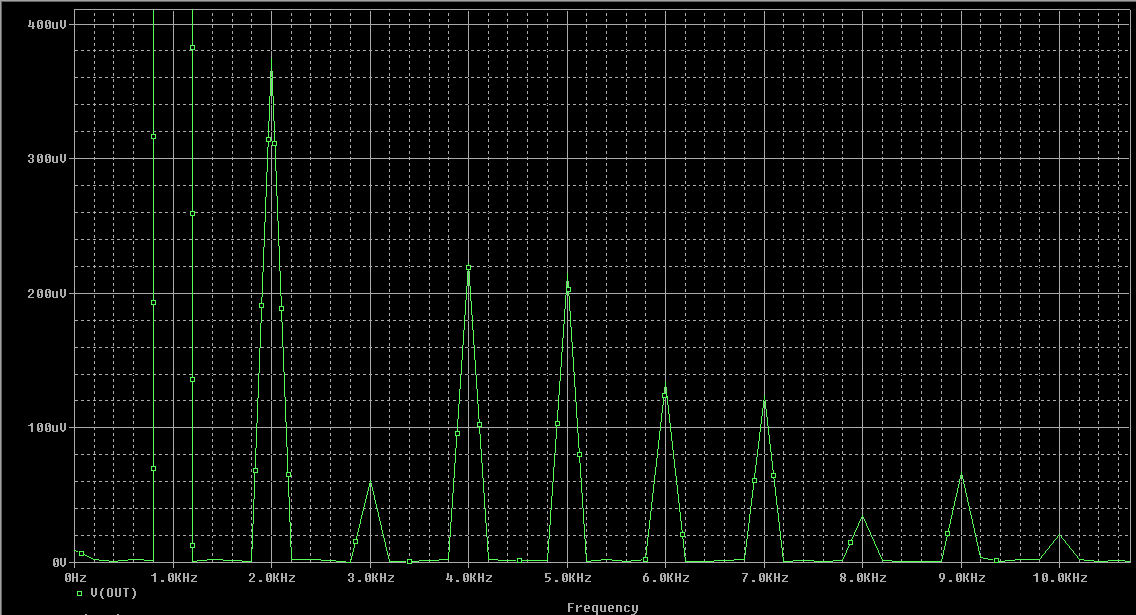

Here's the comparison between the spectrum peaks (I hope I made no errors, it's a manual process) and the FOUR components. Values are in uV, the third column is the relative error:
372.7 380.2 -2.01%
64.7 73.99 -14.36%
220.8 224.3 -1.59%
213.7 218.1 -2.06%
133.9 133.6 0.22%
126.2 130 -3.01%
32.7 21.7 33.64%
67.4 49.7 26.26%
20 22.2 -11.00%
Errors are relatively small for those components that contribute significantly to the THD.
To answer your question, I have no idea, using TSTOP/(2^N-1) as a print step is something that I inferred from the LTSPICE best practices. It could not be optimal, or valid in all cases, hence my comment about extrapolating the method.
EDIT: Sorry, I don't know how to format a table to improve the readability

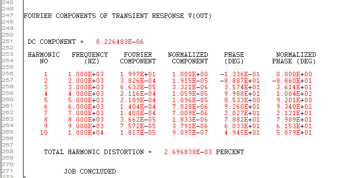

Multisim THD figures are still missing.
Perhaps MagicBox is willing to jump in?
E.
Sure,
I just need a heads-up on which schematic / models to use and number of harmonics at which freq. to yield FFT results.
