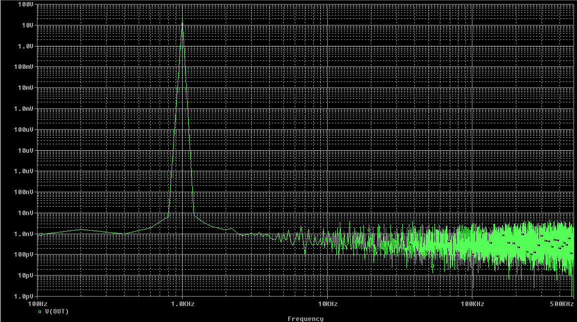

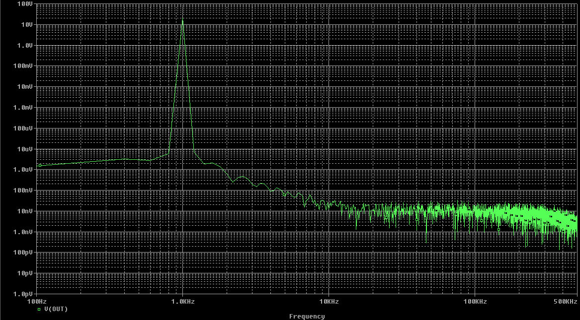

PSpice, about -200dB (full output is 20V, to stay consistent with the rest).
To reach the above value I had to change again the max time step and look for an optimum. This optimum is now different ( much smaller, 10mS/(2^20-1) ) than the previous ( used for the 19.7 amp simulation, 10mS/(2^17-1) ). Using this new max step in the 19.7 amp simulation (with discrete components) leads to some 200ppm distortion (double the optimum, and about x8 the LTSPICE distortions value).
This is what I get if I use in the synthetic 19.7 amp (with VCCSs) the same max time step as in the optimum found in post #3884.
Clearly much worse, although this time step provided a (relative) minimum distortion result, for the 19.7 amp with discrete components.
Thanks Walter.
So the FFT stuff itself seems alright. No extreme rounding errors, even when the simulator is 'teased' with bunch of components.
Nevertheless we see an enormous discrepancy between THDs of the original 19.7 amp.
Why?!

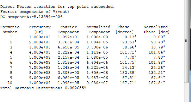

I've just run some comparisons between LTspice and Cadence Pspice using a polynomial for distortion and a 1KHz sinewave primarily so that I can calculate the expected results (very simplified first step).
My post got too long so I've just put it into a word file and attached it.
First I am not very experienced with FFT's and have no experience with .Four or with LTspice, so don't feel obliged to open the attachment.
The attachment contains only text describing the test and my observations no great work here, the data can be supplied if there is any interest.
My observations where basically that I found Cadence (Cad) to be at least a lot more fussy. LTspice matched my expected results for all cases tried.
In the end I was somewhat comfortable with the Cad .Four results if adjusted properly (and waited for the results). I was not able to get satisfactory results for the Cad. FFT plots however.
The FFT plots and .Four data appear to be decoupled and using one to "tune" the other may not actually provide any benefit.
Reminder that given my lack of experience with these functions this most likely means operator error rather than any SW deficiencies.
-Antonio

Hi Antonio,
Thanks for your input. Very useful.
Most likely you have nailed down why some simulators produce just noise.
What's exactly going on I don't know, as I can't look under the hood of these simulators, but it reminds me of similar issues I had when writing S/W for a PC-based distortion analyzer.
The point is that we are dealing here with sampled data which probably need to be re-sampled in order to get 2^N equidistant samples for an FFT. If you do this the sloppy way (for example by means of piece-wise linear interpolation) you will get excessive noise.
Apparently you're not the only one (see Arthur, Mike & Walter). If anybody else also makes these so called 'operator errors' and/or if they are hardly to avoid, then we may safely consider it as a S/W deficiency. Decent S/W should take care of such matters.
Last but not least, I would ask you what happens when you put the output from LTspice (see below) by means of 10 separate sine sources (and summed together, of course) as input for the Cadence simulator. Normally, one should get THD=26.55ppm again. But in this case perhaps 200ppm or so?
