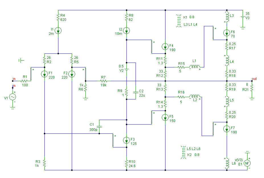

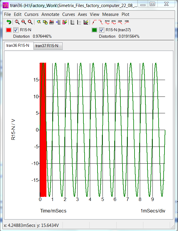

Let's tabulate the results we got till now (I hope more will come):
THD-1k (in ppm of first 10 harmonics?) of Bob's amp according fig. 19.7
Code:
Cadence-1: 259.6  (post 3826)
Cadence-2:  81.8  (post 3844)
Cadence-3  190.6  (post 3850)
MicroCap:   26.8  (post 3837)
LTspice:    26.6  (post 3824)
Simetrix:  190.0  (post 3863)
Hmm... Needless to say that these figures don't inspire much confidence in simulator platforms of various brands.
On the other hand, my THD figures obtained from MicroCap were reasonable in line with actual measurements on the 'blameless' amp, Bob's HEC amp and the PGP amp.
I also like to add that, at least to me, a figure of 26ppm doesn't sound overly optimistic.

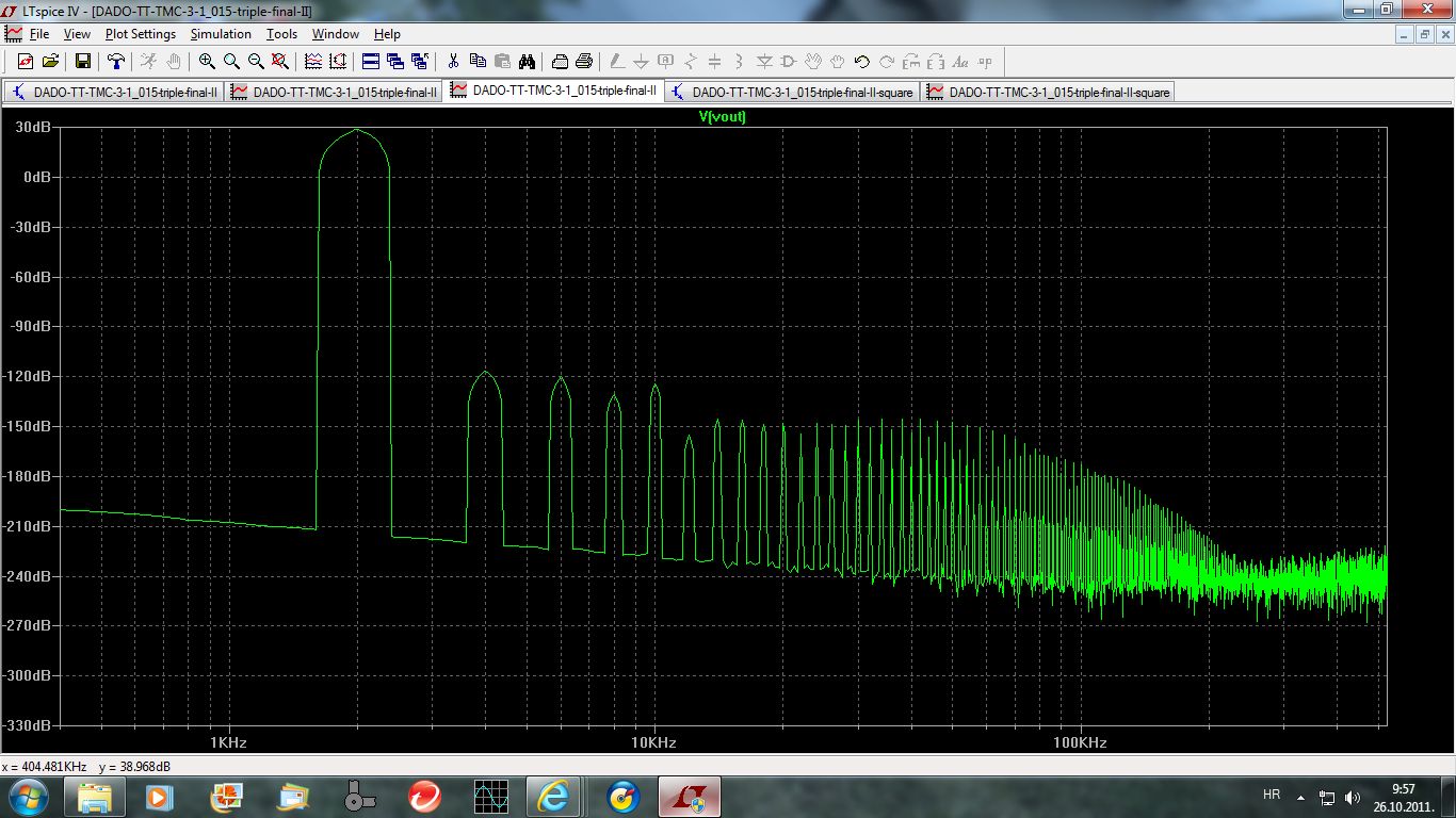

Hi Arthur,
As for THD analysis, there are good AND unreliable simulators. Please have a look at this thread:
http://www.diyaudio.com/forums/solid-state/29119-distortion-simulation-ltspice.html#post336260
Here are some excerpts:
"After following some tips from the LTSpice mailing list, I see no practical limitation from the FFT accuracy (in LTSpice).
With compression off, alternative solver on, running
.tran 0 12m 0 .1u gives .fourier results down to 3E-6 (110dB dynamic range). The graphical FFT, selecting 65536 points and Hann window, gives a "noise floor" of -200dB. And if you join Bernhard's Church of the Merciless Noise Killing, he will most likely give you the setup for getting down to -300dB.
But these are only numbers in a theoretical game, as the active devices' models are not anywhere near this accuracy.
Peter Jacobi"
That's okay, but now look at this one:
"Regarding the accuracy of the FFT (needed for THD analysis) within PSPICE I found the following:
http://www.[B]orcadpcb.com[/B]/kb_articles/020019.asp?bc=F
an excerpt:
Simulation accuracy is limited to about 3-3.5 digits (60-70dBc). The accuracy can be improved by tightening tolerances and taking the above considerations to extremes, but not by very much. This may not be considered sufficient for some applications, but keep in mind that even the best simulation models are probably not accurate enough to provide better
Regards
Charles "
3.5 digits correspond with an accuracy of ~300ppm. If this is true, it explains a lot! Orcad :down:

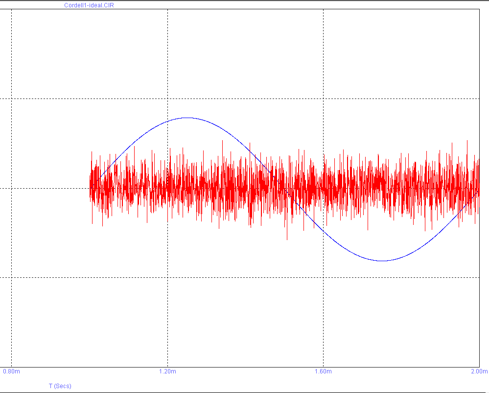

Hi Athur,
I'm not impressed by -120dB. MicroCap 'does' -197dB on a clean sine.
May I suggest that we redo the simulations of Bob's amp, but this time with distortionless components (VCCS, CCCS, etc) ?
Then we get a notion of the numerical accuracy of the FFT implementation.
E.
THD Ideal amp
Here's distortion of Bob's amp with ideal components (that is, without any distortion). THD @ 1k = -210dB, BW = 10kHz. Simulator: MicroCap.
The graph below shows the output voltage (20Vpk) and the residue*1e11 (just rounding noise).
Now, let's see what LTspice, Orcad-Cadence and Simetrix can do.
E.
PS: The inductors are 25nH
edit1: -197db in post 3877 is wrong (due to mental arithmetic). It should be -214dB
edit2: F1, F2 etc. are CCCSes.
