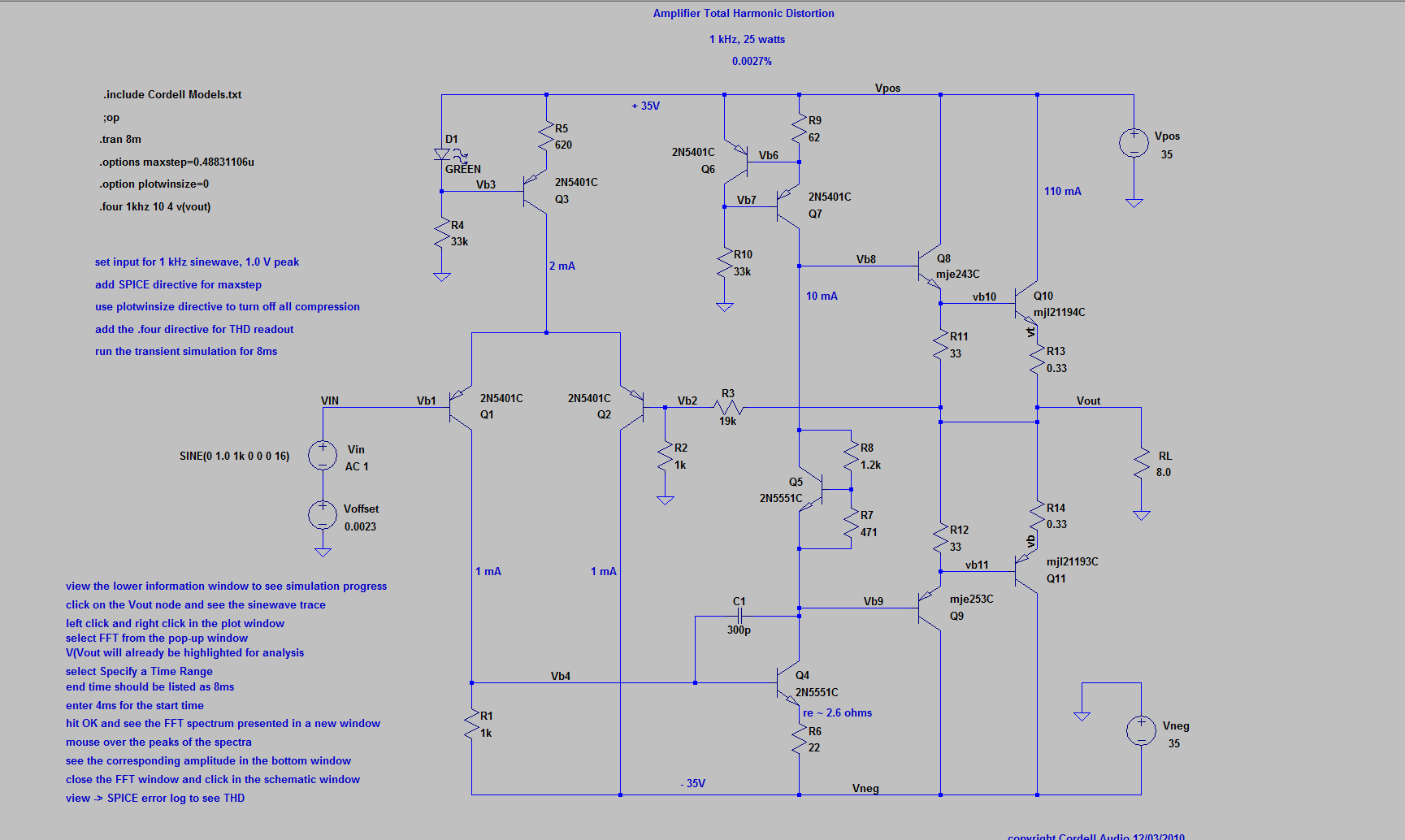

Hello MagicBox
Here are the models and schematic of Bobs amp , 10 harmonics is the go.
Regards
Arthur
  • Cordell Models_12_07_2010.txt

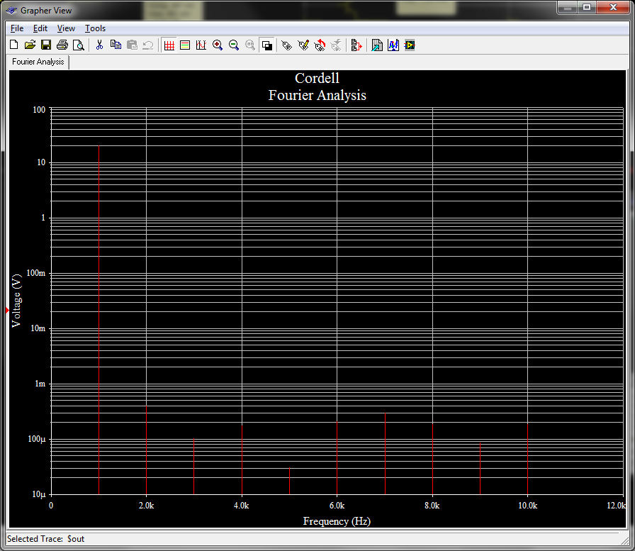

No more edit button so I'll have to bump. Here are the magnitude results:
Code:
Fourier analysis for $out:
DC component: 3.89269e-005
  No. Harmonics: 10, THD: 0.00322448 %, Gridsize: 256, Interpolation Degree: 1
Harmonic Frequency    Magnitude    Phase        Norm. Mag    Norm. Phase
 1       1000         19.968       -0.13168     1            0
 2       2000         0.000402738  -69.532      2.01691e-005 -69.4
 3       3000         0.000102638  -31.082      5.14011e-006 -30.95
 4       4000         0.000175408  150.85       8.78446e-006 150.982
 5       5000         3.0785e-005  -30.074      1.54171e-006 -29.942
 6       6000         0.000209934  113.57       1.05135e-005 113.702
 7       7000         0.000299694  44.1631      1.50087e-005 44.2948
 8       8000         0.000184869  57.811       9.25824e-006 57.9427
 9       9000         8.66966e-005 -0.68835     4.34177e-006 -0.55668
 10      10000        0.000185828  -98.169      9.30629e-006 -98.037

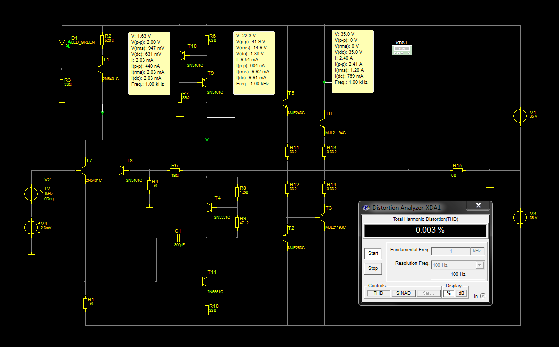

You'll also find an image of the schematic in action 🙂 I also found that this particular schematic behaves a bit erratically. When using the interactive simulation mode (picture 2) and letting it run, the THD would alternate between 0.002 and 0.003, predominantly being 0.003, regardless of timestep resolution.
Hello MagicBox
looks like your results align with the other simulators namely MC9 , LTspice, Pspice and Simetrix. From this it is fair to say that using the same models and circuit all of the above simulators should give similar THD simulations there are no huge differences.
Arthur
Yeah, I kept in line with 4ms - 8ms window, 4 periods. However, when I move around the window the THD varies, sometimes few more ppm, sometimes less. On average I'd say it's pretty close to the 0.0027 specified in the schematic. A shame the interactive meter doesn't show more digits, only 3 after the decimal point.

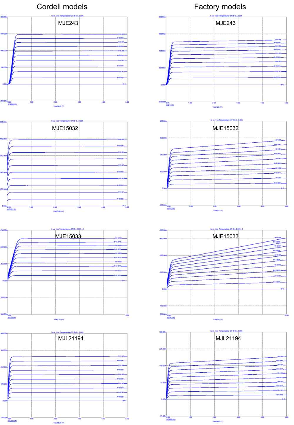

A quick note about models;
What is a better model? Is that a model that gives lower THD, or is it a model that is more realistic?
I have made plots of some of the Cordell models and compared them with factory models.
What do you think? (Hint: Jim Early)
BTW: I’m working on a new amp design, in my opinion it’s a lot more interesting to look at ways to lower distortion by designing new circuits instead of tweaking models.
This is what I’m getting when I'm using factory models. The phase margin is very good and there is no sign of oscillation. The circuit isn’t 100% optimised yet, so the final design will have lower distortion (in the simulator).

I'm afraid I have to take strong exception to your assertion that my models are optimistic. It is nice that you plotted the output characteristics of my models against those of some factory models. The factory models do indeed look more realistic (although they don't look as terrible as the one I used, where current gain literally doubled when Vce went from 2V to 20V).
My models come from hours of tedious measurements on REAL devices which were then checked against LTspice simulations of those models. They are not optimistic; they are a reasonable reflection of what you get when you use a real device, recognizing that there is significant variation of real devices, particularly among different manufacturers whose processes differ.
I was indeed surprized at the flatness of the collector characteristic of the MJE243, as I had also been under the impression that it was not so good.
One needs to realize that Early effect measurements can be prone to error if not done very carefully. Since moderate voltages and moderate collector currents are encountered in the measurement, it is very easy for heating of the device to influence beta and result in an Early voltage that is too low. The measurements must be done very quickly, often with the device on a heat sink, to avoid this problem. Such errors go in the opposite direction to what you believe are the errors in my models.
For the MJE243, I measured collector current at Vce of 10V and 30V for a given base current, where collector current was 10mA at 10V. At 30V, collector current had risen to only 10.17mA.
I would expect and hope that manufacturers use pulsed testing with adequately short pulses to avoid this source of error, but perhaps they do not always do so when formulating their models.
Also bear in mind that it is not unusual for VA to be twice or even significantly more than that of the rated collector breakdown voltage.
In making models, it is also important to start with reasonable numbers, rather than allowing a computer program to start in some other way and perhaps land in a local optimum with crazy numbers. I start with VA = 2X breakdown voltage, do much of the rest of the model, then alter VA to obtain the collector current slope that corresponds to real measurements, then iterate. Alternatively, I'll hand-calculate VA from the electrical measurements and use that as the starting point.
Just because my models yielded significantly lower distortion than the terrible manufacturer's models does not mean that my models are optimistic.
If you can, I encourage you to try carefully some of these measurements yourself, but they are not easy. Also, if you think that there is something wrong with the procedures I outline for modeling in Chapter 21 of my book, please let me know.
BTW, it is a misnomer that "high" voltages need to be used to measure VA. I never used voltages in excess of 50V. Indeed, as I mentioned above, the use of high voltages is actually undesirable, as the resulting junction dissipation can lead to erroneous results due to beta dependence on junction temperature.
In closing, let me say once again that I, too, was surprized at how "good" the VA was for the MJE243 when I actually measured it.
