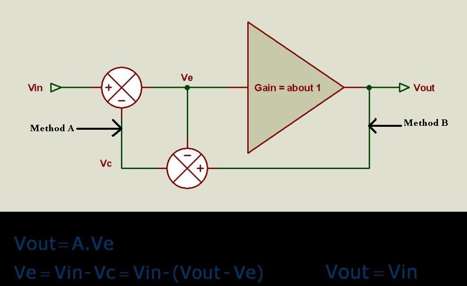

Hi Jan
I'm spicing Bob's EC output stage and looking at the gain and phase of a couple of loops. To make sure that I also include your approach (see method A), please confirm that the loop has to be broken at that position, if not, correct me.
Cheers, Edmond.
Hi Jan
Cheers, Edmond.
Re: EC loop gain
Yes method A. Appreciate it.

Jan wrote:
To say there is no feedback when N=1 is totally wrong. If a=1 then the feedback is inifnite no matter what scalar value N has.
I'm just saying the equation does not accurately represent the non-linear system.Now you seem to say that the math is illegal and it couldn't happen. If the a bothers you, delete the a, replace by a wire. Don't tell me that then Vx=Vy-N.Vy is illegal!
We're dealing with a PFB loop nested within a NFB loop. The nesting obscures the underlying behaviour.My point is that if you break the loop at x-y you end up with a loop gain of 1-N, which can only lead to pfb if N<1, but then the loop gain is too low to support any 'infinite gain'.
I was talking about 'a' not 'N' and its effect on the feedback loop from the output. When 'N' = 1 there is loads of feedback. Who cares what happens at Vx? Your error is that you keep ignoring the feedback path that matters: that is the path coming from the output node; the node you are trying to control.You also said earlier: if N>1 it's nfb, with N<1 its pfb, with N=1 its infinite gain. I agree with 2 out of 3. The math as well as practise shows clearly that when N=1 there's no fb at all because Vx=Vy.

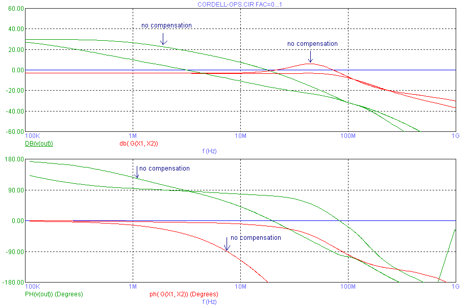

Hi Jan,
First, isn't it funny that this debate is going on for almost a year (starting at post #555), and yet we still disagree.
I've spiced Bob's EC output stage, with and without frequency compensation in the EC-stage, and I like to show you some graphs of the gain and phase response of the two different approaches. The red curves applies to your method, i.e. the loop broken at the input summer. The green curves applies to Brian's and my method, i.e. the loop broken at the output summer.
With the frequency compensation enabled, the system is stable, which is clearly predicted by the green curves, revealing a Ft of 3Mhz and a sound phase margin of near 90 deg. However, the red curves don't give us any clue at this frequency.
Without frequency compensation the step response is ringing and tends to oscillate at around 19MHz. This is also nicely predicted by the green curves, as the phase margin is almost zero. Indeed, your approach does also reveal that something is happening at 19MHz: the gain rises from -3dB to -1dB and the phase drops to -180 deg. However, such figures are not alarming, at least to me, yet the system is unstable.
The red curves are completely wrong, for the correct curves, see:
http://www.diyaudio.com/forums/showthread.php?postid=1307435#post1307435
Comments invited.
Cheers, Edmond.

Edmond,
A couple of observations right of the bat.
Firstly, the 19MHz thing in 'my' method doesn't surprise me (not the freq, but that it is there, I mean). Surely, whatever methos is used, there is bound to be some phase shift occuring at higher freqs leading to ringing. I don't think anybody ever claimed that H.EC was free of that.
Secondly, I see no sign of infinite loop gain. Indeed, the loop gain (if I interpret the graphs correctly, please correct me if I seem to be off here) appears to be just below unity. That does surprise me, as I had expected it to be just above unity.
Could I have a look at your circuit for this sim?
Jan Didden

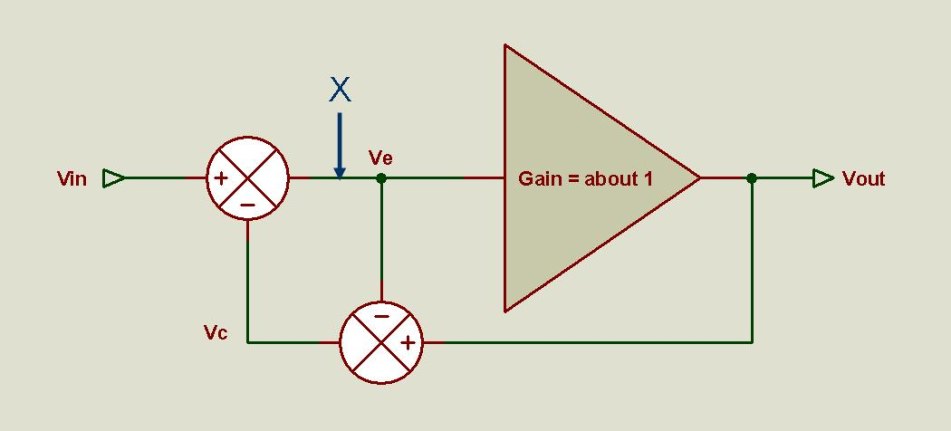

traderbam said:[snip]You are trying to correct the output, not the input! That's why the output node is where you must break the loop.
[snip]
No, we are measuring LOOP GAIN. So we can break the loop anywhere we want, surely the loop gain is the same everywhere in the loop, as long as you enclose the whole loop (and that is where we view things differently).
Your assertment that we try to correct the output and that therefore only the direct feedback from the output is part of the loop is incorrect. You take a sample of the output and feed that back to the input. It is the size and shape of that sample that determines what happens. You can take it directly from the output, or through an attenuator like in beta-feedback. You don't make the point that because you want to correct Vout, you can't take the output from an attenuator instead of Vout, do you?
You can break the loop at point X in the attachement. What's your loop gain then?
Jan Didden

No. You are measuring two loops at once. You must measure just the feedback loop from the output.So we can break the loop anywhere we want
I'll tell you what it is: it's irrelevant.You can break the loop at point X in the attachement. What's your loop gain then?

Edmond,
I think I know why the red curve is just below 0dB instead of just above. IIRC Bob's ec circuit uses single transistors to extract the error. The error gain is less than one, while ideally it should be exactly one. if you would replace those transistors with an 'ideal' gain-of-one, the red curve should be just above one, in fact as much above one as the output stage gain is below one.
Jan Didden
Jan Didden
janneman said:[snip]
.... I see no sign of infinite loop gain. Indeed, the loop gain (if I interpret the graphs correctly, please correct me if I seem to be off here) appears to be just below unity. That does surprise me, as I had expected it to be just above unity.
Jan Didden
Hi Jan
I had already expected such questions. Look at 100kHz. The green curves show a gain of about +30dB. Indeed, it's not infinity. This is because Bob's circuit isn't perfectly balanced, the gain of EC circuit proper is slight below unity. If I increase R34 and R35 from 680R to 730R and looking at a frequency below where the gain starts to roll off, then I get 50dB. OK, it's still not infinity, but pretty high. 🙂
As for the schematics, I'll send them to you this evening. I have to leave now.
Cheers, Edmond.
