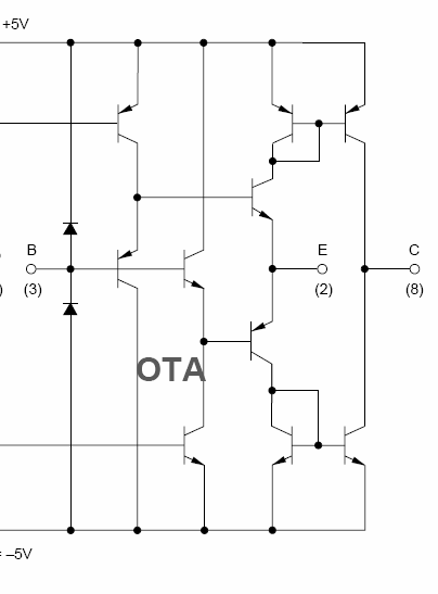

CCII's are available in various disguises. They are also known as diamond transistors, transconductance amplifiers and as front-ends in so called 'current feedback opamps'.
But the basic structure is always the same. This particular one is from the OPA660 data sheet.
The X-terminal is the 'base', the Y-terminal is the 'emitter' and the current output terminal Z is the 'collector'.
