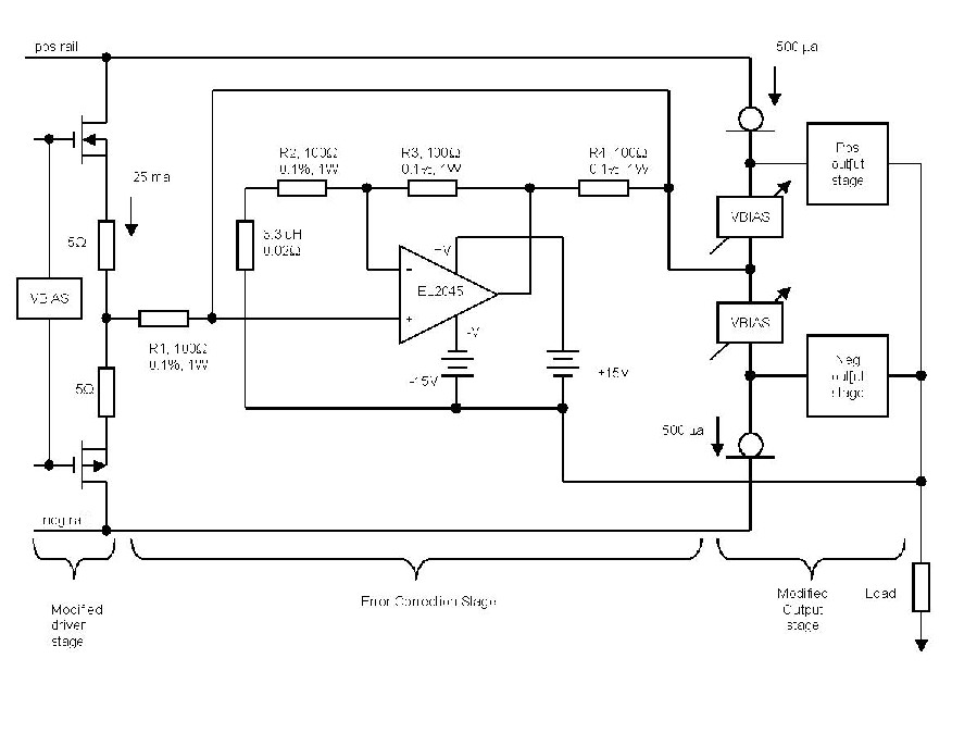

While I was posting that, I remembered following a discussion, here, about your KleverKlipper (IIRC the name) circuit, probably six to nine months ago. Sometime soon, I'll have to check your website, again, to see if there is more-detailed information available, about that, and also track down those messages.
At this point I have almost no recollection of how that was done, or even exactly where in a discrete amplifier circuit it might best be implemented. But now I'm somewhat curious about whether or not a chip like this one would tend to prevent attempting implementation of better handling of clipping, by making the relevant circuits inaccessible.
- Tom

Follow up to single point error correction
The attached schematic illustrates an error corrected output stage utilizing a single point of error correction that is applied to both the positive and negative halves of the output stage. By use of floating + and - 15V supplies, it is possible to utilize a high speed opamp as the correction circuit and generate only the error signal. In this case the + and - 15V supplies float on the output of the amplifier, and the error voltage is generated by comparing the outputs of the driver and output stages. With a little arithmetic one can show that the voltage applied to the output stage's input is equal to the sum of the driver stage voltage plus a correction voltage exactly equal to the error introduced by the output stage.
Note the tolerance on the four 100 ohm resistors. They need not achieve an absolute accuracy that great, but they must be matched to this tolerance. Simulations showed that 1% resistors caused a distortion increase of approx 15 dB. This is one of the few places where I have found this degree of matching is required in audio circuitry.
Some minor modifications are required for the driver and output stages. It is necessary to configure the driver stage such that it generates a single output signal, rather than a pair of signals offset by a few volts as is usually the case. This is easily achieved by adding a pair of source followers as would be the case for a real output stage. The only difference is the amount of current this stage must furnish is modest (~25 ma). The source follower is also necessary to present a low impedance driving source to R1.
The output stage needs to re-establish a DC offset between the drive to the upper and lower halves, and this is easily done with a pair of VBE multipliers. Constant current sources connected to the pos and neg rails guarantee the bias circuits active independent of the voltage swing. (clipping will turn them off). As I posted in an earlier thread, this circuit achieves (in simulations at least) distortion suppression in the range of 30 - 50 dB, depending on the frequency.

Re: Follow up to single point error correction
This looks like a nice circuit. The only question that I have is the pros and cons of doing something like this with an op amp as opposed to the discrete EC implementation. Doing it with an op amp dosn't really seem to reduce complexity by the time you put in things like the floating power supplies. On the other hand, it would certainly make sense if it improved performance compared to the discrete version.
The other key thing to bear in mind in comparisons is that the amount of high-frequency error correction is what is most important, so speed is king in the EC circuit.
Any thoughts on these pros and cons?

Re: Re: Follow up to single point error correction
Bob,
The choice of op amp is indeed critical. It needs to be fast and capable of driving ~ 100 ma. The EL2045 meets those requirements and is one of the few opamps supporting a +/- 15V rail voltage that will. Most high speed opamps are limited to +/- 5V or something in that range. Configured for 2x non-inveting gain, the EL2045's power bandwidth exceeds 100 MHz. In fact, it was necessary to roll off its response with an inductor as part of the feedback return path. Without the inductor the EC circuit briefly oscillates if presented with a sharp step response.
The floating power supplies are not a big deal, since small (1-2 watt) isolated DC-DC converters are available at reasonable cost. Also, if I remember correctly, your 1984 design example required separate supplies for the driver and output stages, so the cost should be comparable.
BTW, when designing the circuit, I purposely put performance ahead of simplicity. I have not tried to simulate your original circuit to see how it compares to an opamp-based approach. Have you ever done so? It would be interesting to compare the performance of the two different approaches. If you want, I can provide you with the signal levels and frequencies and load characteristics that I used, so we'll have an apples-to-apples comparison.
Jeff
Hi, Bob.
Yes, "speed is king" in the EC circuit(s). I found that out when I tried to implement a "delay", to try to get a better comparison (time-alignment-wise) for generation of the error signal. I actually was able to see a pretty-significant improvement by delaying the input to be better time-aligned with the output. But it was a bit "painful", circuit-wise. One of my better EC amps of that genre used a "six-pole Sallen-Key 0 dB low-pass" filter with "linear-phase .05-degree equiripple error" response-type, where I used a higher-frequency and a higher-order filter (relative to ?... OK...) to be able to get more more delay with much less LP filtering effect. And the opamps I used for that had to be very, very fast, indeed; the faster the better!
But... that made me think... If most or all of that could be done (gasp!) "digitally", somehow, it might be much easier and better (maybe very nearly perfect). However, the eventual output might need to be significantly delayed, time-wise, versus the actual souce. BUT, no one (else) would know, if it was only a millisecond or two behind.
There might be some basic violation of the laws of physics involved. But, if so, I'm guessing that that could be surmounted with, say, two sets of enough memory and way more (digital) speed than would normally be needed, for "practical" situations, at least.
I'm sorry if that's too uncomfortably-far off-topic. I'm an analog guy, myself, but usually have to (or try to) keep digital in mind, too.

Re: Re: Re: Follow up to single point error correction
I agree with your points. That op amp looks like it should perform well in this application. I guess your use of the floating supplies eliminates the need for boosted supplies for the front-end and the VAS? If so, I guess you're right about the complexity being similar.
I have never simulated my amplifier for purposes of distortion analysis, so we'd have to do any comparison based on measured results.
Bob

EC Amp Boards are Back
The first boards for my EC amp design have come back. I have soldered up the first one, and with one minor adjustment to the compensation network, they appear to work fine. Since this design does not use GFB around the output stage, the voltage gain stage can be tested in isolation.
DC idle current and voltage values, bandwidth, and rise/fall time are all within 20% of simulated values. Right now, I do not have access to a distortion analyzer, so that measurement will be deferred until the output stages are completed. Then I'll either buy or rent an Audio Precision analyzer.
One interesting finding: The design uses LM317/LM337 regulators in a floating mode. Since the supply voltage is +/- 70V, it is important to ensure that the 317/337 max input/output differential never exceeds 40V. Otherwise they will fail. The recommended protection scheme with diodes does not protect against this failure mode. It is necessary to replace the diodes with transzorb zeners with a ~30V knee voltage. During power-up the filter cap on the 317/337 output is at 0V. So if the supply voltage dv/dt exceeds the response time of the regulator, the in/out voltage differential can be exceeded. The zener's breakover voltage guarantees this cannot happen. The circuitry serviced by the 317/337 is capaple of tolerating + or - 70V, so there is no problem there.
I'll post a photo when I get the opportunity.

Re: EC Amp Boards are Back
Sounds great! Keep us posted on progress and details.
That's a good point about the LM317/337 use in a floating arrangement for the high supplies. I like the idea of the transorbs. I had a similar situation on an amp I did many years ago, using those same regulators to regulate the boosted rails. If I recall correctly, I had a small transformer with isolated secondaries to supply the low-current boost, its rectifier sitting on top of the main rails. I believe I used a diode going from the main rails to the boosted rails in that case. That diode would charge up the boost filter capacitor fast enough that the LM317/337 would never see a drop greater than the boost delta. I don't remember exactly what I did with the voltage-setting part of the regulator.
Bob

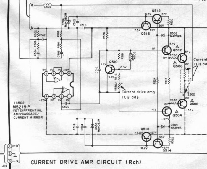

What is this?
Is this an EC? The whole thing works as a follower (no voltage gain). Input from VAS comes to node (b), entering point (3) of the opamp. This opamp feeding the Vbe multiplier (bias scheme) which is loaded by R526. The VAS working lightly, because it only feeds the base of the non-inverting input of the opamp.
The opamp itself has feedback from the output node via R508, entering point (2) of the opamp (inverting input).
The supply of the opamp is bootstrapped to the input node, always follows the input (thus the output, because the whole thing is a follower), D506 and D508 are referenced to point (b) of the input.
