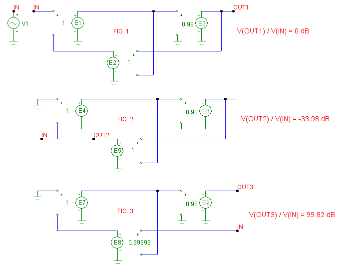

Hi Jan,
Never mind.
You are right, in that situation, the loop gain is far from infinite. If you don't mind, I've translated your diagram into MicroCap symbols to check and double check a couple of things, and indeed, the loop gain is extreme low, see attachment, fig. 2.
However, if we break the loop at the output side, see fig. 3, than that loop gain is infinite. MicroCap was (of course) complaining about a singular matrix, so I had to alter the gain of the summer (E8) slightly below unity. In this case I observed a loop gain of about 100dB.
As you see, I don't disagree with you, but I only try to demonstrate that there exists a different look at EC circuitry, that's all.
Cheers, Edmond.

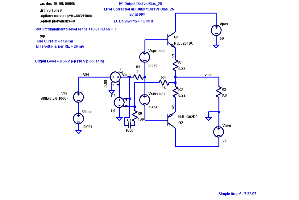

Effect of EC on XO Distortion
In the feedback thread we have been looking at the effect of NFB on output stage crossover distortion. Here I thought that I would show the effect of error correction on crossover distortion.
The simulation includes just a Class-AB output stage pair using the ThermalTrak RET BJTs. They include 0.22 ohm emitter resistors and are biased with 20 mV across each RE.
The stage is feeding an 8-ohm resistor. It is operating at 10 V p-p at 1 kHz.

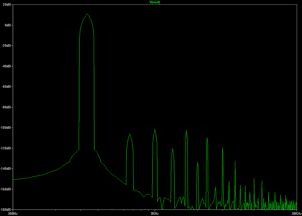

Below I show the output spectra without EC.
Note the scale, which ranges from +20 dB down to -180 dB. The fundamental is at about +10 dB.
As expected, the crossover distortion spectra extends quite far out in frequency, albeit down to about -160 dB by the time it reaches 30 kHz.
Bob

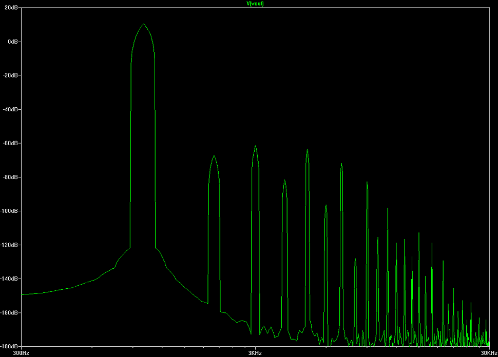

Here on the same scale one can see the very significant reduction of crossover distortion spectra.
The EC circuit is operating at 99%, reflecting a deliberate 1% tolerance error. The distortion levels are lower if no tolerance error is introduced. The bandwidth of the EC loop is at 1.6 MHz, reflecting the usual EC loop compensation that is required.
Again, bear in mind the very wide dynamic range of the scales when making the comparisons.
Bob
Bob

Re: EC loop gain
Edmond,
I think we are fully in agreement here. If you disconnect the ec signal from the input summer as you did in fig 2, the loop gain shows a very low value. For me that demonstrates clearly that there is no 'hidden' (high) loop gain in an error correction system.
If you break ONLY the negative feedback loop and leave the pos feedback loop intact, one, as expected, finds a very high loop gain because you now have a circuit with only pos feedback. But that's not the ec circuit we were discussing anymore!
What is determining the system behaviour is the EFFECTIVE feedback, which is a combination of pos and neg fb in a specific ratio. That effective feedback is disconnected in fig 2 and shows NO hidden loop gain.
QED, AFAIAC.
PS And thanks very much for the sims!
Jan Didden

Re: EC loop gain
Edmond,
Looking one more time at your fig 2. Your sim shows a loop gain of -33.98dB.
As I said, the effective feedback is (1/A)-1. When I plug in your A=0.98, that comes out to about 0.0204. Multiply that by the gain in the forward path, the 0.98. That gives 0.02 for the loop gain.
That, my friend, comes out to -33.979dB. This neatly confirms the validity of using the effective feedback as the criterium to judge amp behaviour, and your method of determining the loop gain. I think we can live with the fact that your sim is 0.001dB off..😉
But what does this actually mean, that the loop gain is -33.979dB (or 0.02)? It means that the loop gain is just enough to add the missing 0.02 fraction to the input signal to make the gain appear as exactly '1' instead of the ol gain of 0.98.
You put in 1V, the error correction adds 0.0204V, the gain = 0.98 and out comes exactly 1V. I keep on being surprised by this mechanism.
Jan Didden

Re: Re: EC loop gain
Hi Jan,
My sim also says -33.797dB; I just rounded it off. I hope you can live with a deviation of 0dB. 🙂
Cheers, Edmond.

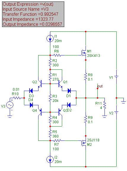

Re: EC or FB?
It certainly is 'a' form of error correction, as all forms of feedback, feedforward etc are a form of error correction.
Whether it is specifically Hawksford-style ec I am not sure, this needs more study. In H-style ec there is a requirement that the ec loop has exactly a gain of 1. I guess your Q1 and Q3 should be seen as ec transistors? Then the input to the correction loop is at their emitters and the reference from Vin at their bases. The output current from the collector is through R2, R5 and generates the correction to Vi (Vi here is, I guess, the junction of R6, R2. Am I still on track?
Then the 64000$ question becomes: does a 1V error between B and E lead to an exactly 1V correction at the R2, R6 junction?
Jan Didden

Although the schematic is obsolete and I haven’t updated it yet (been redesigned with 30 pairs of much higher fT MJE15028[9] devices and a peak I limit of 100A), my EC scheme here:
http://users.picknowl.com.au/~glenk/CLASSA.HTM
.....shows how I solved the problem of the EC fighting the current limit. The current limit transistors (Q32 and Q33) simply clamp the error voltage developed between the output and the output stage side of the input resistor R1 (R25 in your schematic). This method is simple and works really well.
Glen
