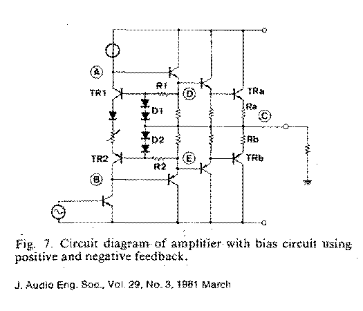

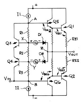

anatech said:If Sansui engineers wrote a patent application, they are attempting to "own it". Either that or no one searches for prior art on either end in hopes of getting away with it.
Chris,
Sansui wrote an AES paper, not a patent application. They were essentially putting their idea into the public domain. So in that sense, it was OK for Levinson to use it. But the disgusting part is that Levinson claimed that THEY developed it. Here is the Sansui circuit:

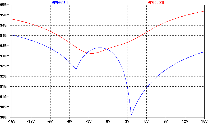

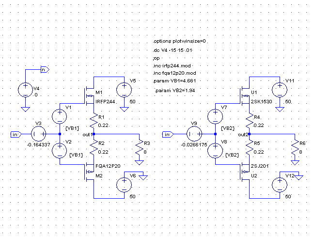

As I mentioned earlier, I wanted to do a sim that looks at the effect of modeling the weak inversion (AKA sub-threshold conduction) of MOSFETs on plots of output stage behavior like what Self did in his book. In the third edition of his book, on page 319, he takes a complementary source follower and looks at the derivative of the output voltage with respect to the input, for an input DC sweep from -15 to +15 Volts, presumably with an 8 Ohm load.
I did the same thing using the simulation whose schematic is shown below. The idea is to have two almost identical circuits, one using a MOSFET level 1 model, and the other using Edmond's BSIM3 models of the 2SJ201 and 2SK1530. Unfortunately, the only BSIM3 models I have are of these two devices, and I do not have level 1 models for them. So I instead chose the IRFP244 and FQA12P20, for which I hand fit the data from the datasheet graphs to a level 1 model. So the comparison is not perfect, as the Toshiba devices have higher transconductance, and therefore less distortion. For each circuit, I adjusted the bias voltages to get DC drain currents of 150 mA. Here is the schematic.
And here is the plot of the derivative of V(out) vs. V(in) for the two model types. The "kinky" one uses the level 1 model for IRFP244 and FQA12P20. The smooth one is for Edmond's BSIM3 models.
I think it's pretty clear that the level 1 models are completely wrong. The "kinks" in the curve result from the discontinuity of the second derivative of Id vs Vgs in the level 1 model.
This is really a classic case of having SPICE lead one astray, as it appears that Self has done with his MOSFET evaluation. In order to get MOSFET models that represent real world device behavior as well as the standard BJT models do, one must resort to the more complex models such as BSIM3. There is also a model called EKV that takes into account weak inversion, but has only a small number of parameters to fit. I'm looking to see if I can develop a method for fitting datasheet curves to that model using Excel. I'll put something in the SPICE thread about that if I am successful.
