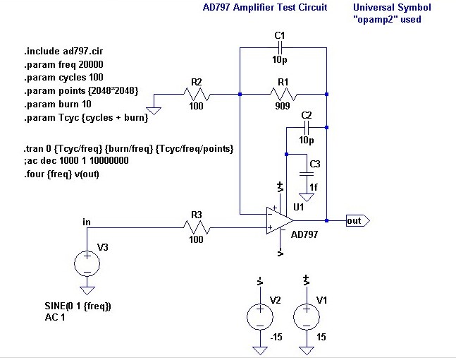

It's probably well known to those here, but you can parameterize the tricks that andy_c is talking about. I.e., rather than manually calculate the timestep, start and end time, you can add .param directives to calculate the required values for you based on frequency, cycles, etc. The attached circuit shows an example of this. 'freq' is the frequency of interest. 'cycles' is the number of cycles to capture. 'points' is the "Number of data point samples in time" from the FFT dialog. 'burn' is the number of cycles to skip before saving data.
Since the FFT requires that the number of points be a power of 2, I usually end up multiplying two smaller number together (i.e. 2048*2048 is easier to type and remember than 4194304).
As mentioned, make sure you turn off compression.
I think maybe I still have some sort of off-by-one issue or somesuch, since I only get 160db or so down from the fundamental at 200kHz for the simulation shown, but it's probably overkill at that point anyway. 😉

I get plenty of FFT precision in LTSpice simply by turning off compression and then selecting an integer multiple of the period to analyze. You may set the sim time to 10ms, but it won't sim exactly that much, you must select an exact multiple of the period of interest from within the FFT window.
I usually only sim 6 cycles of whatever frequency I'm using, then I throw out the first 1 and the last 1. 160-180db "noise" floor is typical.
P.S. I just pulled a random complete amplifier from my personal archive, 180db noise floor from a 6ms sim completed in 0.251 real time seconds.

Reading the last couple of posts about LTSpice, I get the impression that this simulator is a potential candidate for a hate/love relationship. Running a FFT in Micro-Cap is much simpler. Just specify the starting and ending time of one cycle of the fundamental frequency and pick the number of FFT points from a table (of course powers of two).
You can use any time step, however, the smaller the time step the smaller the noise floor. When using 1ns and 20kHz, for example, the noise is 250dB down.

I had lately been working out simulations for a 2MW igbt inverter, 3 level. Rather complex circuits with multiple subcircuits can easily make for hugh waveform files (*.raw), hundreds of Mb to over a Gb. Space considerations nonwithstanding, screen refresh may be a pain as well as addition of traces to display.
What I do then is to specify the time to start capturing data to the begining of the last cycle, where I will be doing detailed analysis and FFT. This way, the *.raw files only grow to the actual usefull amount of data.
