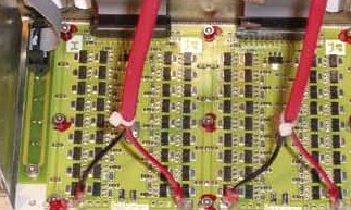

My thoughts exactly for the 250V MJE15032/33 devices when the hurd was still getting them en masse as 25-rail samples from On.(Ft data is not on the sheet, but can be found on diyA with a search)
Example from overhere, with 64 SMT 120MHz ringemitter devices per channel, 32/ch. for the stereo model.
www.arrayaudio.nl/abssnd.html
(trust me, i nagged the head of the vdh coilwinder too)
