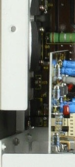

G.Kleinschmidt said:
What do you care about marketing fairy tales ?
hFe isn't worth a damn for either of the two devices once beyond 5/6 amps, part of JC's motivation to pick Hitachi MOSFET "Biggens" for the drivers, my guess.
The single key argument JC gave for the Sankens is price wise.
Big advantage of the Japanese devices is their way superior heat transfer from case to sink.
A designer guy i know from overhere tested the Sankens in his designs at elevated die temperature and low Vce values for peak current capability some 20 years ago.
His top model power amp has 14 of the same devices per ch. as used in the JC-1, comparable max output power level but it can be set to a max bias of 2.5 amps.
(msrp of nearly twice as much as the JC-1 though, the JC-1 duo does $13.5K here)
Big problem to compare power devices from the datasheets are the non-uniform test parameters, some things never change.
