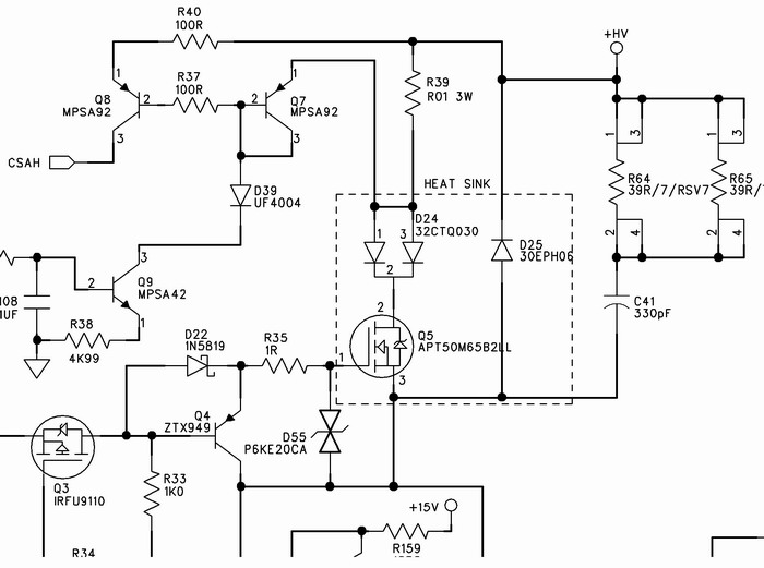

Mr. Cordell,
Is the current rating of a Mosfet is determined by the "Body Diode" rating? In datasheets, the current rating of a Mosfet always the same with the rating of the Body Diode.
In this drawing, the internal body diode (APT50M65) is replaced by external body diode (30EPH06). Is this means the original current rating 67A (APT50M65's) is dropped to 30A (30EPH06's)?

lumanauw said:
Mr. Cordell,
I think the body diode rating is largely coincidentally the same as the forward MOSFET current rating in most spec sheets as a reflection of the unclamped inductive load applications, such as in switching supplies. In these applications, the body diode is used as a free-wheeling diode. When the MOSFET is turned off, the inductive load will try to keep the current the same as it was when the device was on, dumping this current into the body diode under a reverse breakdown condition. Since the current immediately after turn-off cannot normally be greater than it was during turn-on, it is unnecessary for the body diode current rating to be larger than the forward MOSFET current rating. I am not an expert in this area, but this is my simple way of understanding it.
Bob
