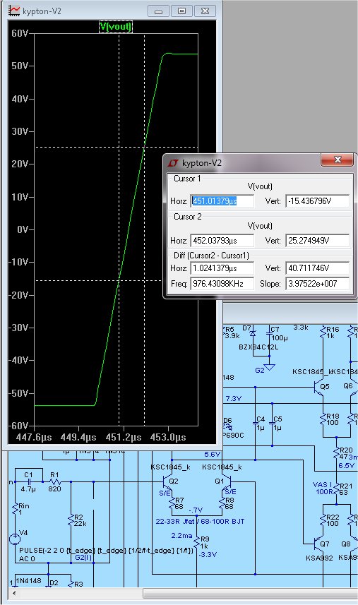

Found a strange problem..
observe the square wave at the input just probed at the positive term of the pulse gen
Kypton ND V2 has got 29.86V/usec
V3 30.10
Im just measuring from 0 to 1usec if its right it has to show much higher slew rate as much as you said 200V/usec or am I measuring it wrong?
V3 30.10
V3 30.10
No , you got ME wrong.K- V2 will never do 200v !
(below 1) = BJT K-V2 with 2V square waves.
(below 2) is BJT K-ND (CFA) with the same input.
Even if you used the fancy super pair VAS on the V2 , it would not
give fast slew like the CFA K-ND.
BTW - I got 40.4v/us on the VFA K-V2 and 90V X 4 (250ns) = 360V/us on
the ND. No way around this , it is by design (topology). You measure with
2 points on the plot between the first 10% and last 10% of the rise/fall.
Edit - I don't mean that the 40V slew V2 would sound inferior by the fact
that it is 1/9th as fast as the CFA .... you only need a few V/us for audio.
OS

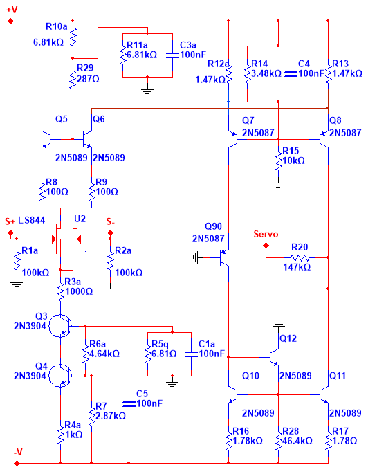

can ND have jfet input? like dual N channel jfet?
OS
How do we use jfets in the ND circuit?
- Bob Cordell complementary input stage with N channel Jfets
