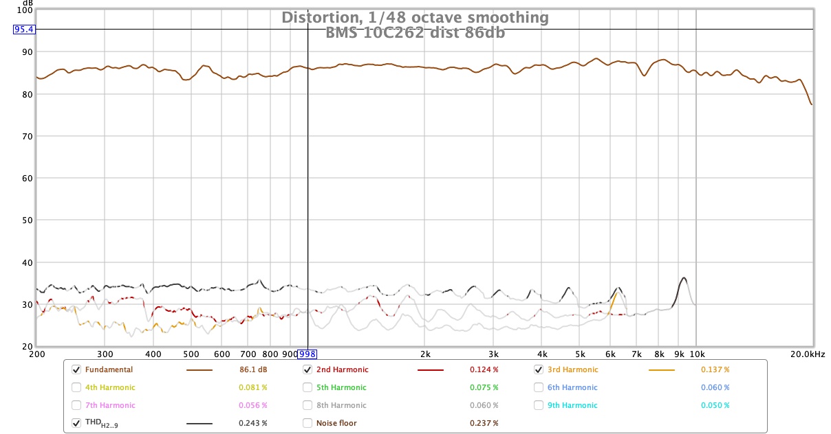

I realise that 85 dB at 5 cm is not pushing the system that hared really.
True. I am curious too, how SPL will influence THD, so next time I try it.

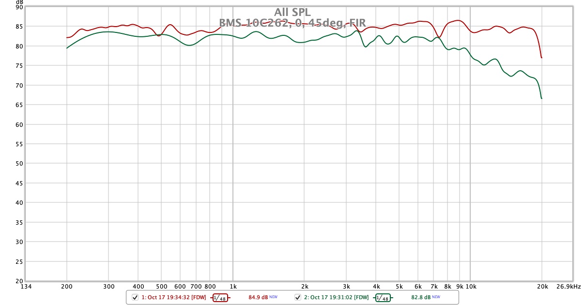

As would 45 deg.
Here is 0 and 45 degree comparison of both drivers with FIR applied. Parameters "as usual", 5cm, gated.

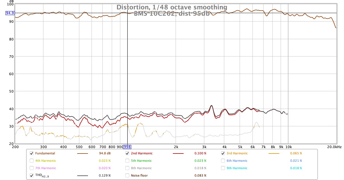

95 dB in listeningposition is loud.

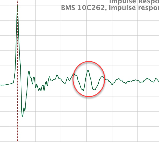

Something interesting on the impulse tests:
The bit I have circled is probably a reflection from the back of the cabinet coming back through the cone. If it is percent (not sure on that one), it's quite big
Try either absorbing it with lining or wadding, or diffusing it with angled or rounded wooden blocks on the inside of the cabinet

This is interesting insight. Yes it is percent. The cone is like 23cm from back of the cabinet, which is about 1.5ms in sound travel (from cone and back to cone), so it correlates with your statement. However the cabinet is filled with polycotton damping, so this should be fine - unless it fell off, I will check it, thanks.
