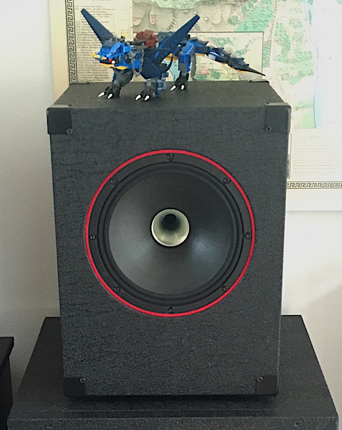

BMS 10C262 coaxial build

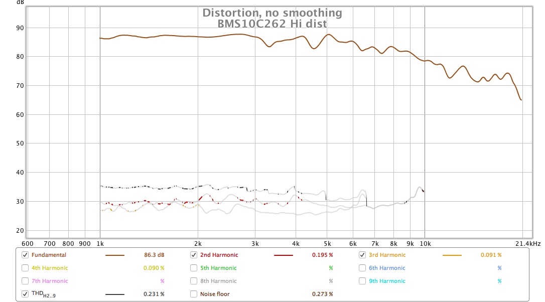

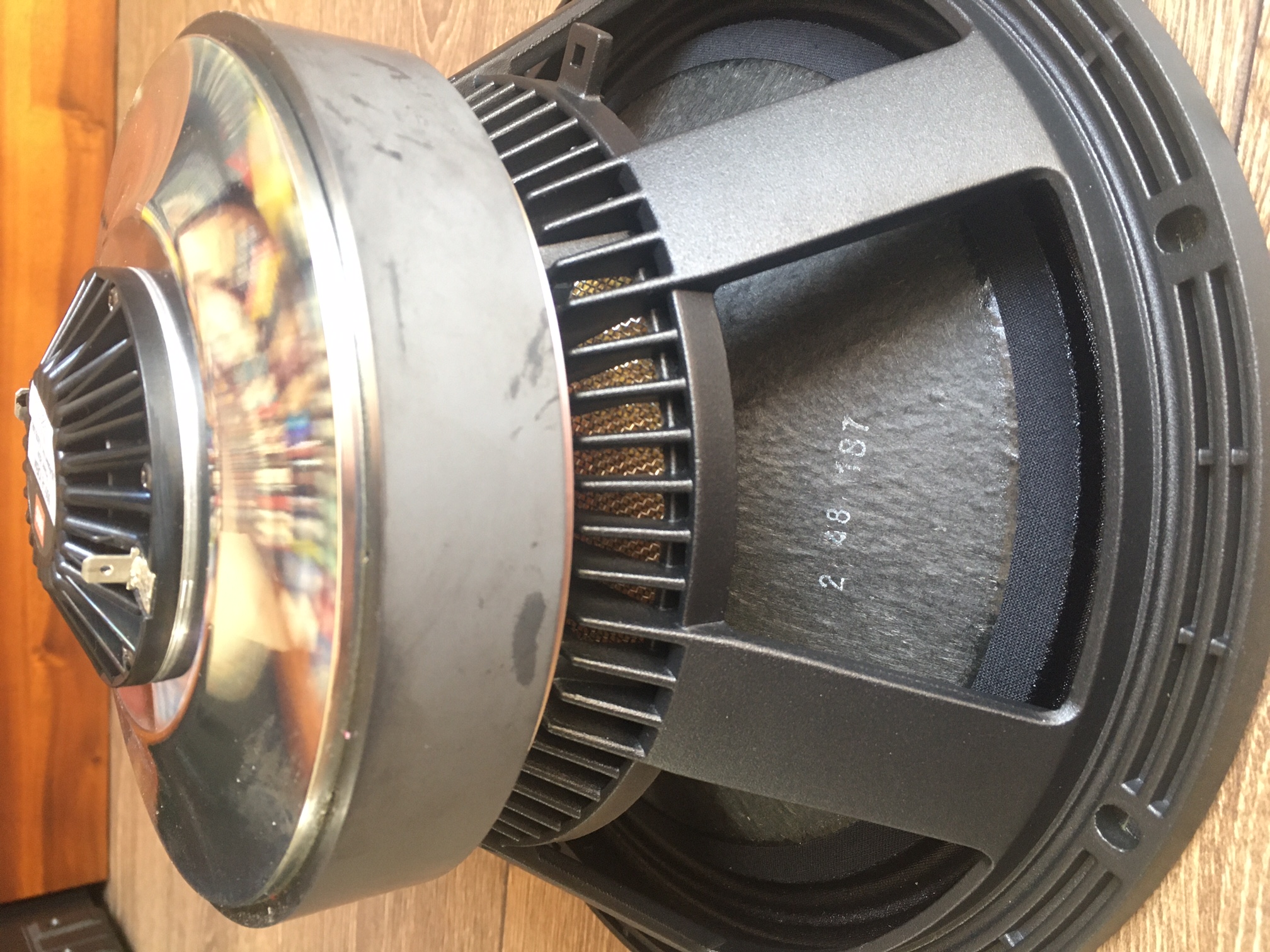

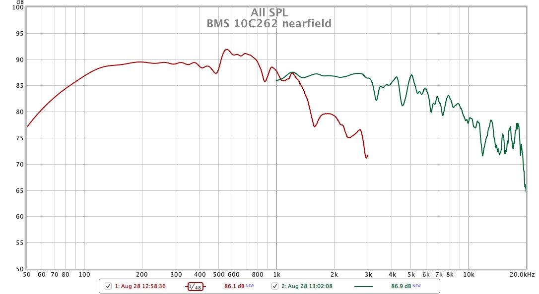

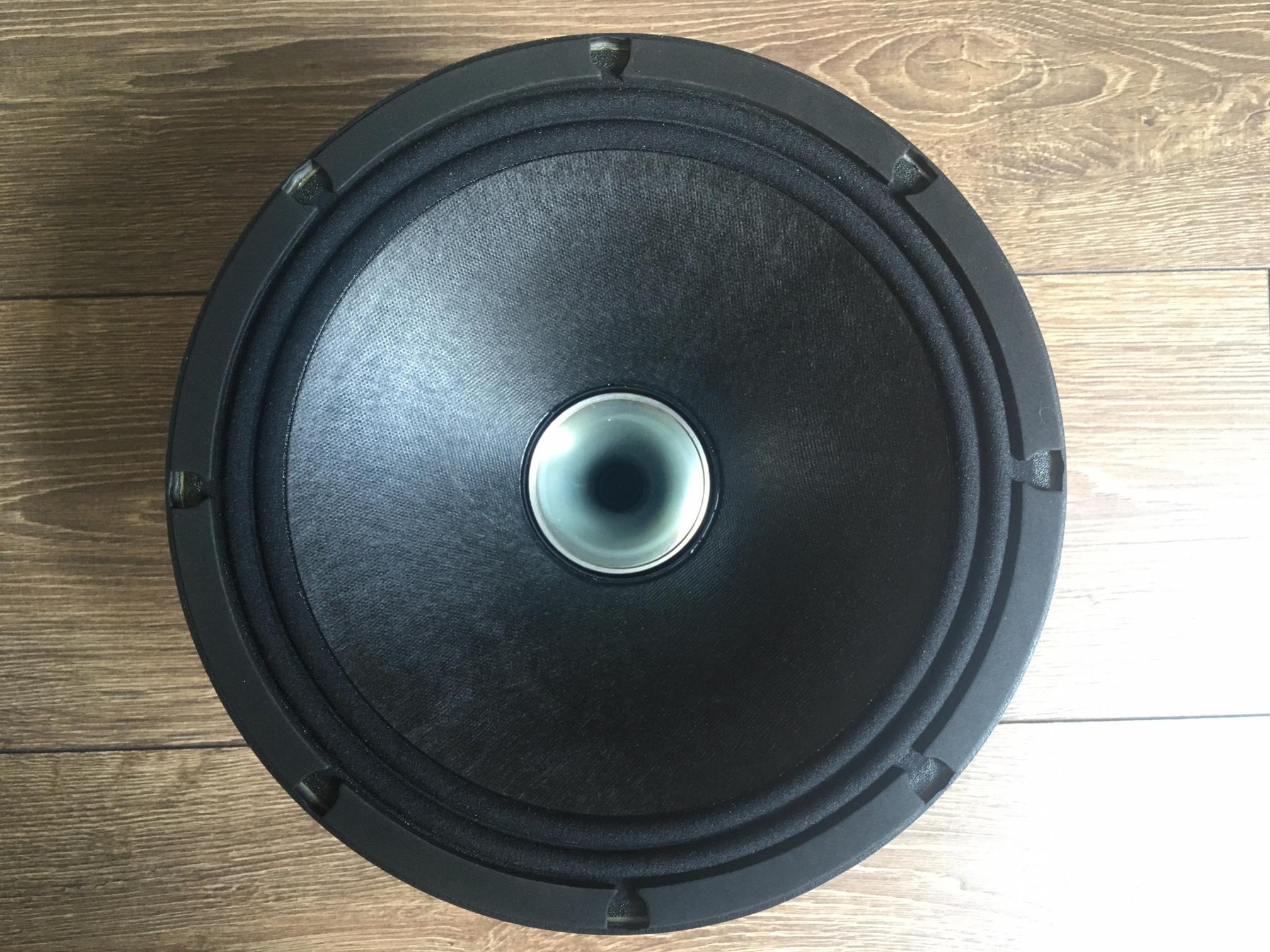

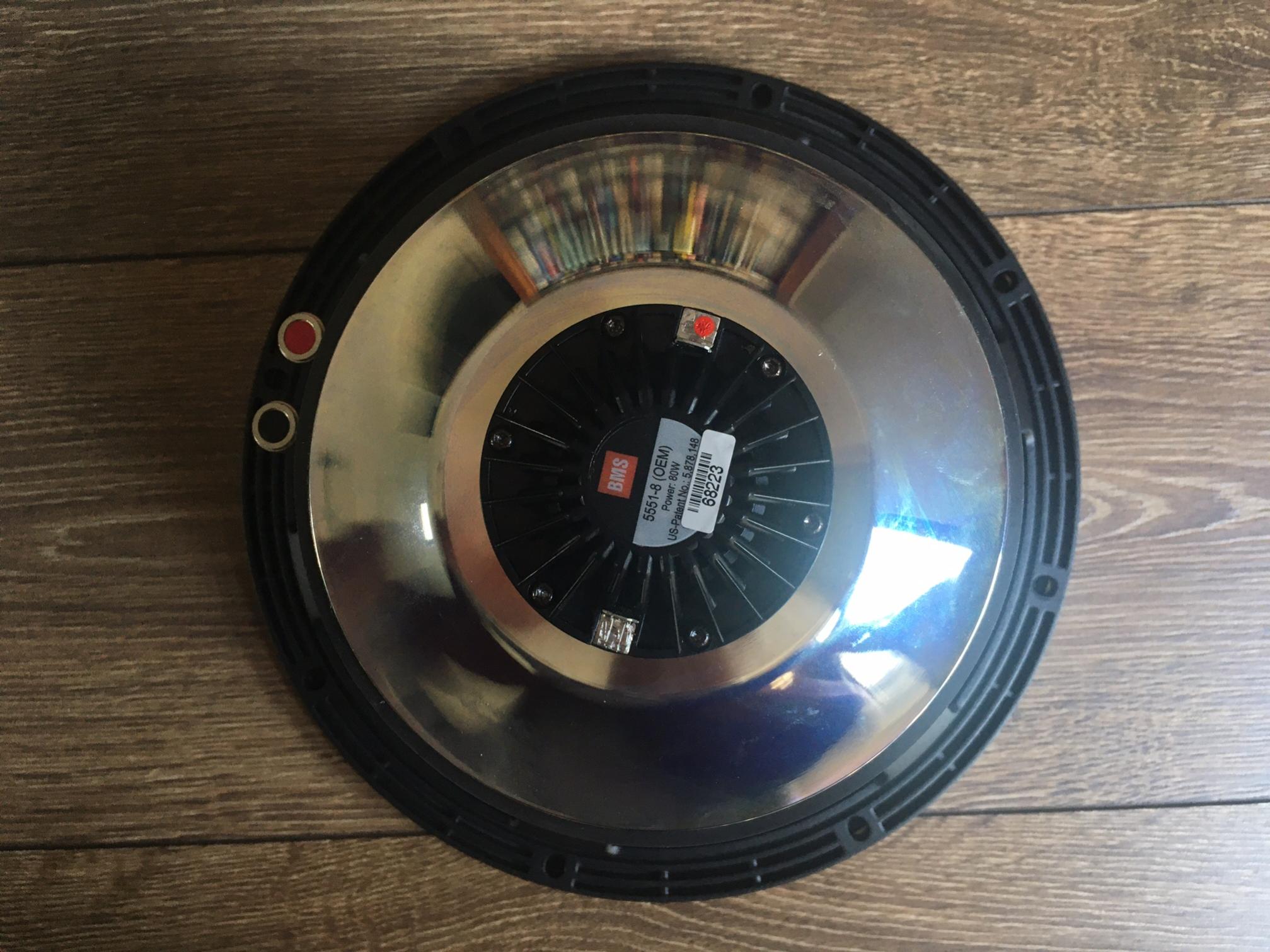

I have built closed box with BMS 10C262 recently. The box itself is trivial, though a bit oversized for this driver (35l). I would like to post some measurements for those interested in BMS coaxial speakers. Speaker is used for midbass and high frequency duties. It is sitting on top of vented enclosure containing 18Sound 18NLW4100.
Driver: BMS 10C262, 8Ohm
Box: closed, 35l
Crossover: active, Minidsp, 150Hz/1300Hz
Datasheet: http://www.bmsspeakers.com/fileadmin/bms-data/product_data_2019/bms_10c262_datasheet.pdf
The frequency response on official product sheet did not look very nice. I needed a point source and decided to try it anyway. I am happy with the result. It can be crossed nicely and with active DSP it is easy to correct some FR flaws. I replaced Beyma 10G40 + CP-380_M + TD-194 with this BMS build and though I loved Beymas, especially in HF region, I would not go back.

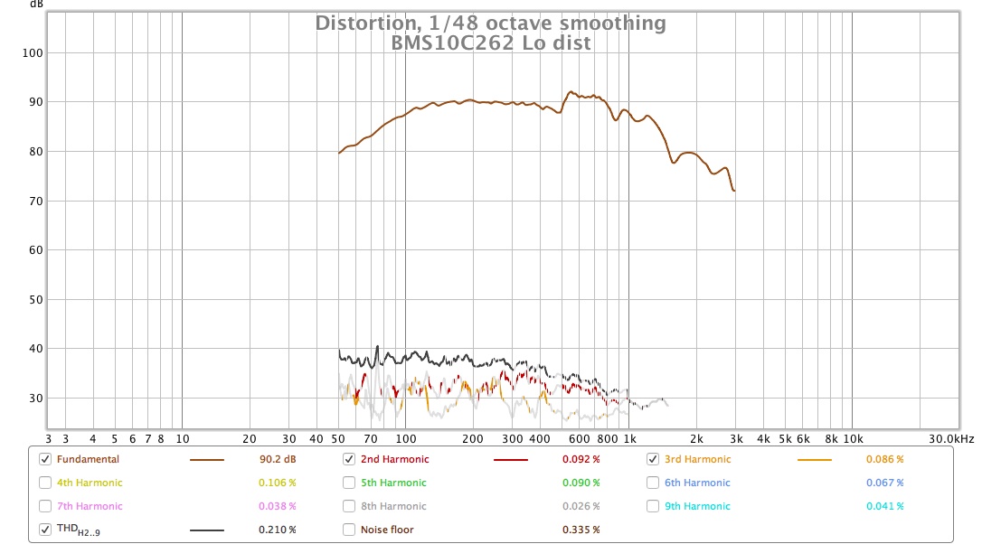

Here is measured raw FR/THD of driver after about 30 hours burn-in period.

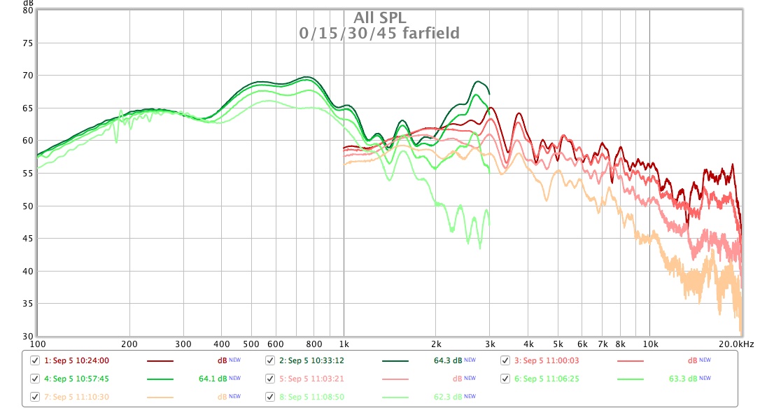

This is on/off axis measurement. Off axis measurement was taken in 15, 30 and 45 degree. The lighter the colour on picture, the bigger angle. Mic was placed 0.8m from driver at all times. Just ignore please data below 200-300Hz, because those are more valid on first set of measurements (nearfield). All measurements were windowed - 4.5ms for cone driver, 3.5ms for compression driver. Note please that measurement for cone driver and compression driver were taken with different voltage applied. Compression driver is much more sensitive of course.

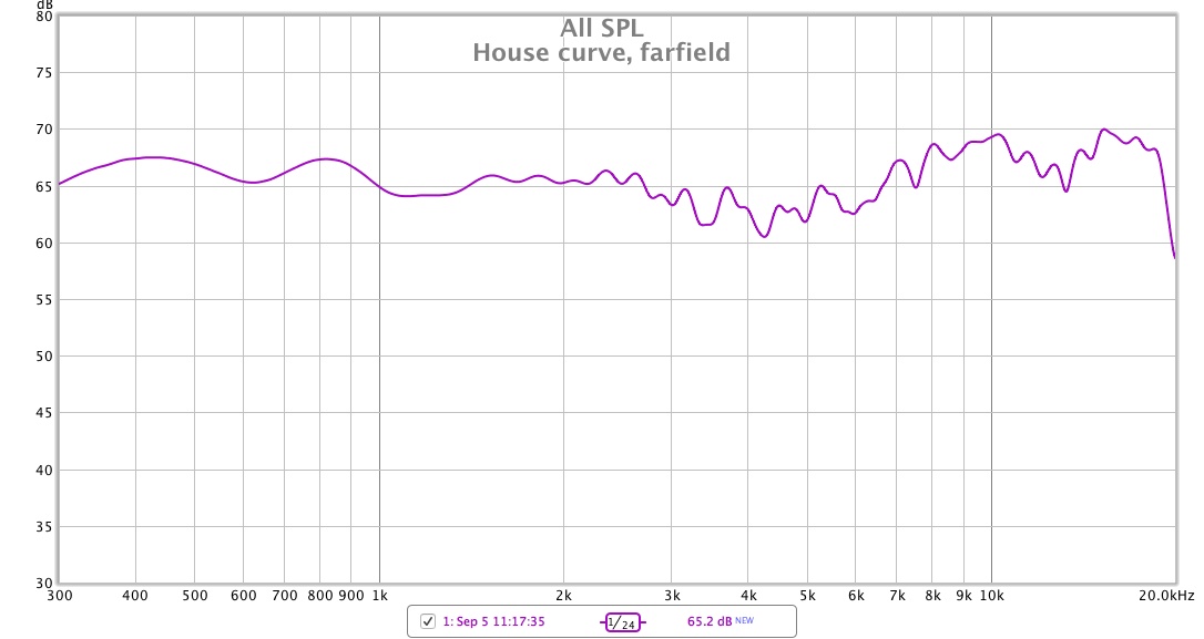

Just to give you a picture of drivers behaviour when crossed over, there is also a "fullrange" measurement. It is one of the house curves, modelled approx. according to Fletcher Munson for 80dB, crossover freq. is 1300Hz, slope BW36, 1/24 smoothing, measured from 0.8m distance.

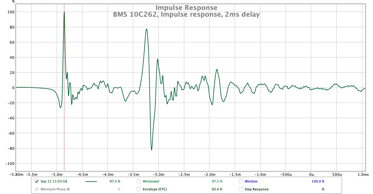

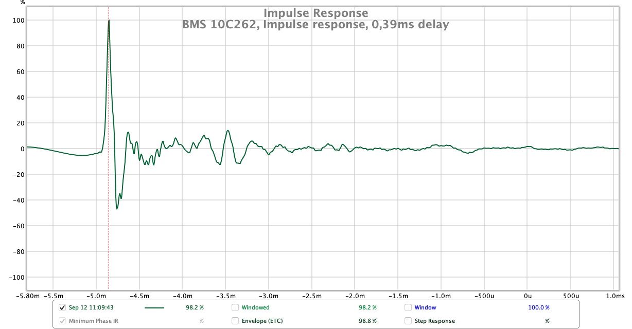

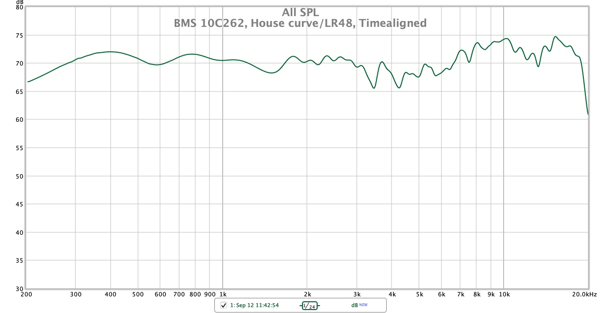

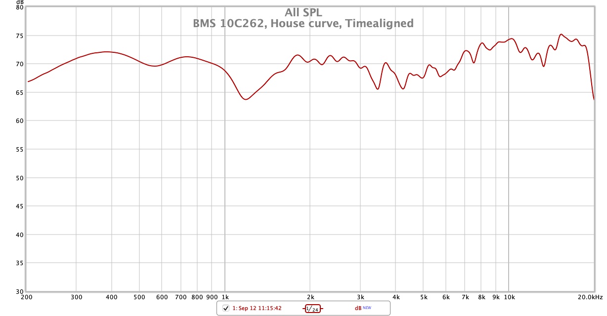

I measured time misalignment between cone and compression driver. I found out that my initial estimate was wrong. I estimated that its value was 0.17ms (6cm) but measurement showed 0.39ms (13cm). To krivium: thanks for pointing me in right direction.
I used this method Driver time alignment.
I set delay betwen drivers to 2ms and used other compression driver as timing reference. As you can see on picture, the time difference between two impulses is about 0.39ms.
Then I aligned driver in minidsp and measured IR (the next picture) and the same house curve as before (BW36, 1/24 smoothing, 4.5ms window, 0.8m mic distance, on-axis). You can clearly see nasty dip in crossover region (1300Hz), because crossover region was badly tuned first time, due to drivers time misalignment.
I tuned (flattened) crossover region again on both time aligned drivers, and the result can be seen on last picture. This time I used LR48 (1/24 smoothing, 4.5ms window, 0.8m mic distance, on-axis).
I did not have the time to do listening tests (and some finetuning)...but I believe it will be ok.

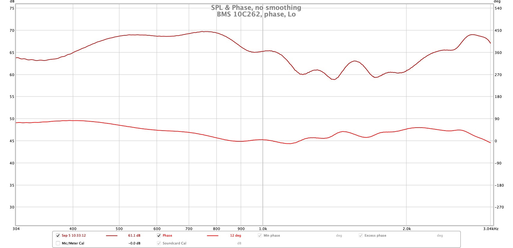

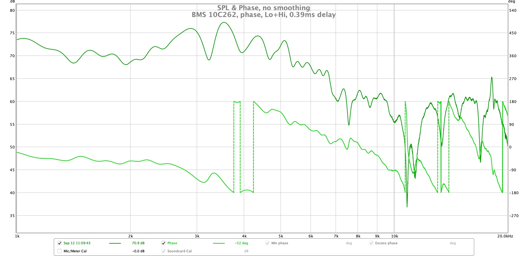

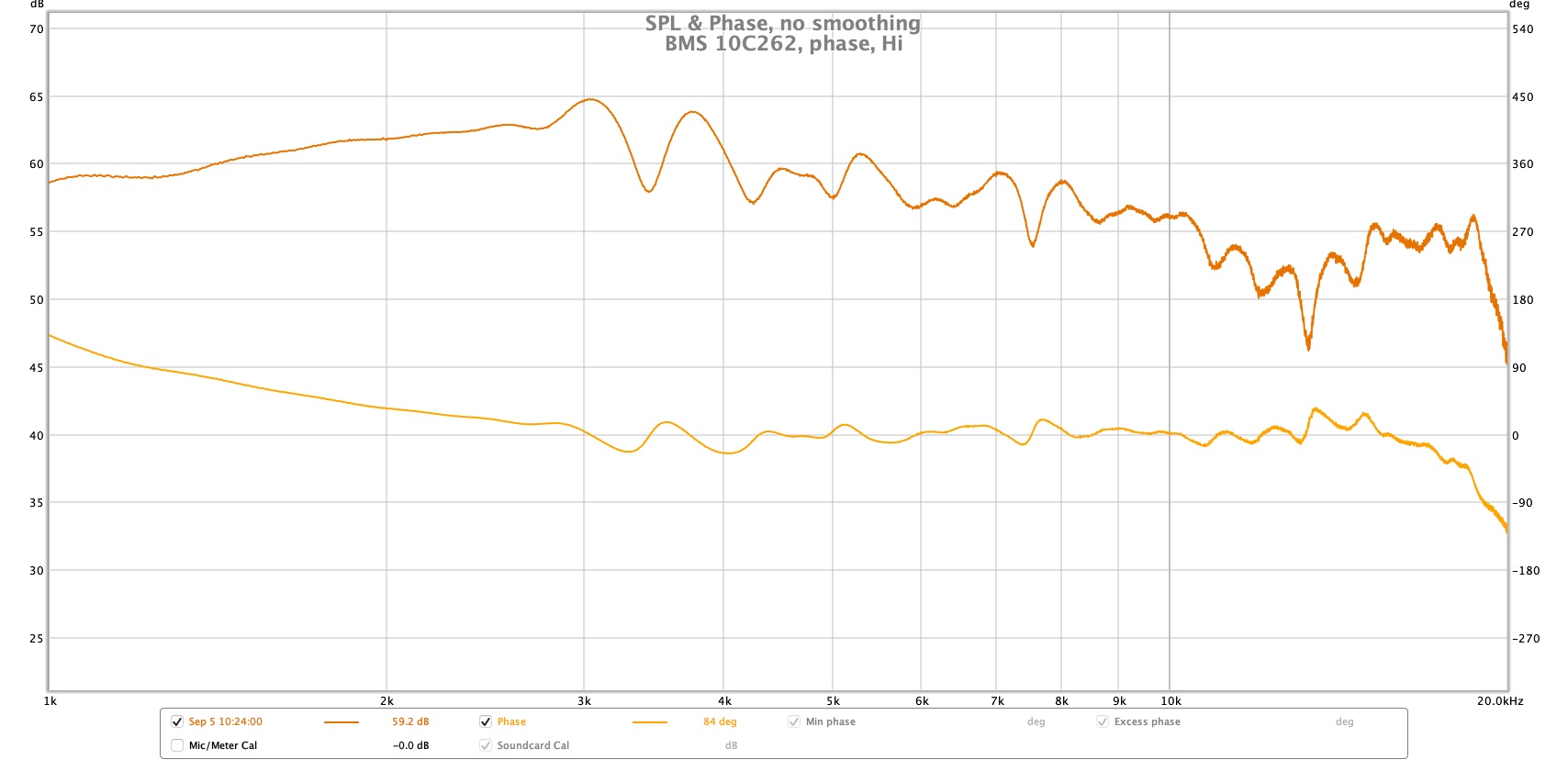

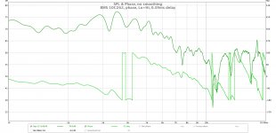

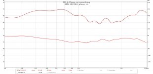

I am not sure if the first statement is correct however. The phase shift would be 180 degrees (or 177, as you pointed out,
but bear in mind please that my measurements are not "lab precise") if:
- there would be no phase shift in each driver itself, and
- I would not set the delay to 0.39ms
I looked at the phase of individual drivers, measured previously, from 0.8m distance. Please see attached files. You can see the phase in 1300Hz region. Cone driver is displaced by 13cm, we should subtract 180 degrees from its 12 degrees, which makes it -168 degrees at the same point, where compression driver is having +83 degrees, correct? So if we further add or subtract 180 degrees, result should be about the same. This of course might be oversimplified, because measured combined phase (when cone driver delayed 0.39ms) is about -52 degrees. See the third picture.
But definitely yes, there is room for further experimentations. This one is good too https://www.bksv.com/media/doc/17-198.pdf.
